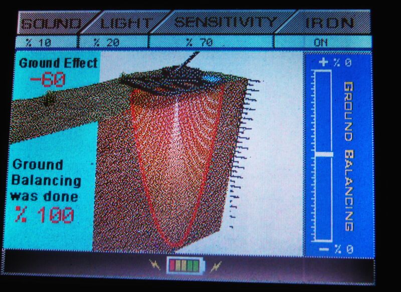

    The new DeepHunters motion-circuit is very good balanced concerning ground-effect versus find-sensitivity.
    If you lift the coil very suddenly directly vertically up from a high mineralized ground you will hear a high-sound signal
    (it sounds different compared to usual finds),
    but if you set the ground balance to a good position so it matches the ground you even can sweep
    extremly close or directly over high mineralized soil and you only will hear if there is buried a find!
    In fact this is a question of very good contrast factor concerning the different "mineralization plus metalization"-degrees.
    This has also an effect on the discrimination accuracy and the different tune of audio-tone output for different metals.
    As example if you set the ground balance to 10 which matches with very high mineralization, the usual background-signals (the critical adjustment signals)
    also will be slightly deeper because the DeepHunter that way is more focused to/on the contrast-factor of high mineralization.
    But that way you will get much more sensitivity for low conductive metal or small gold-alloy-stuff like rings or chains at high mineralized soil as if this "GEB-Level" would be realized different.
    This of course also means that you will get extremly high sensitivity for silver, alu, pure gold and other very high conductive metal objects if the ground is light mineralized.

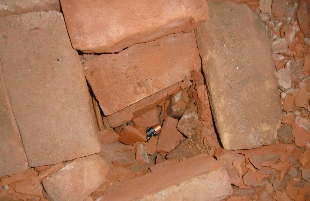

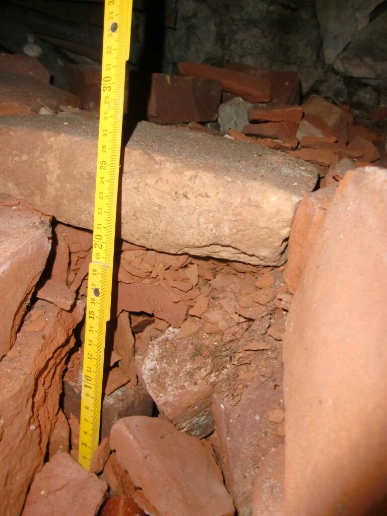

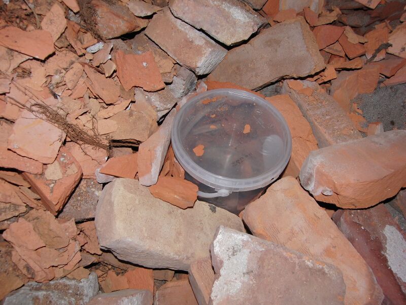

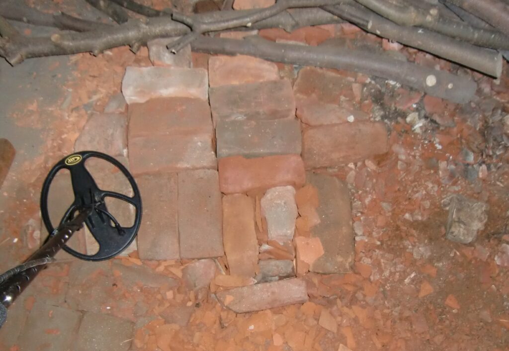

        battery 25cm under bricks test
        @ Orbit
        you're welcome

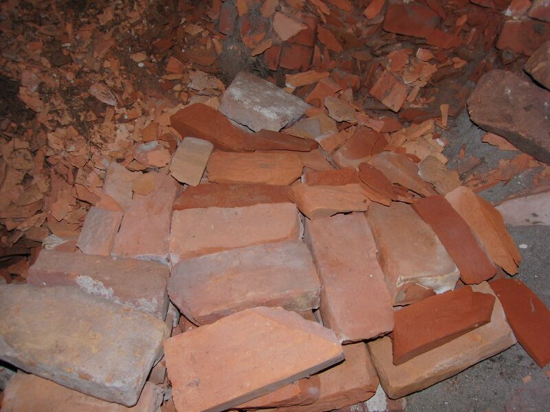

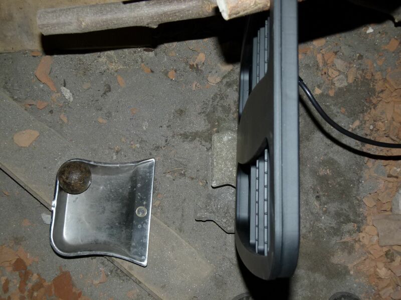

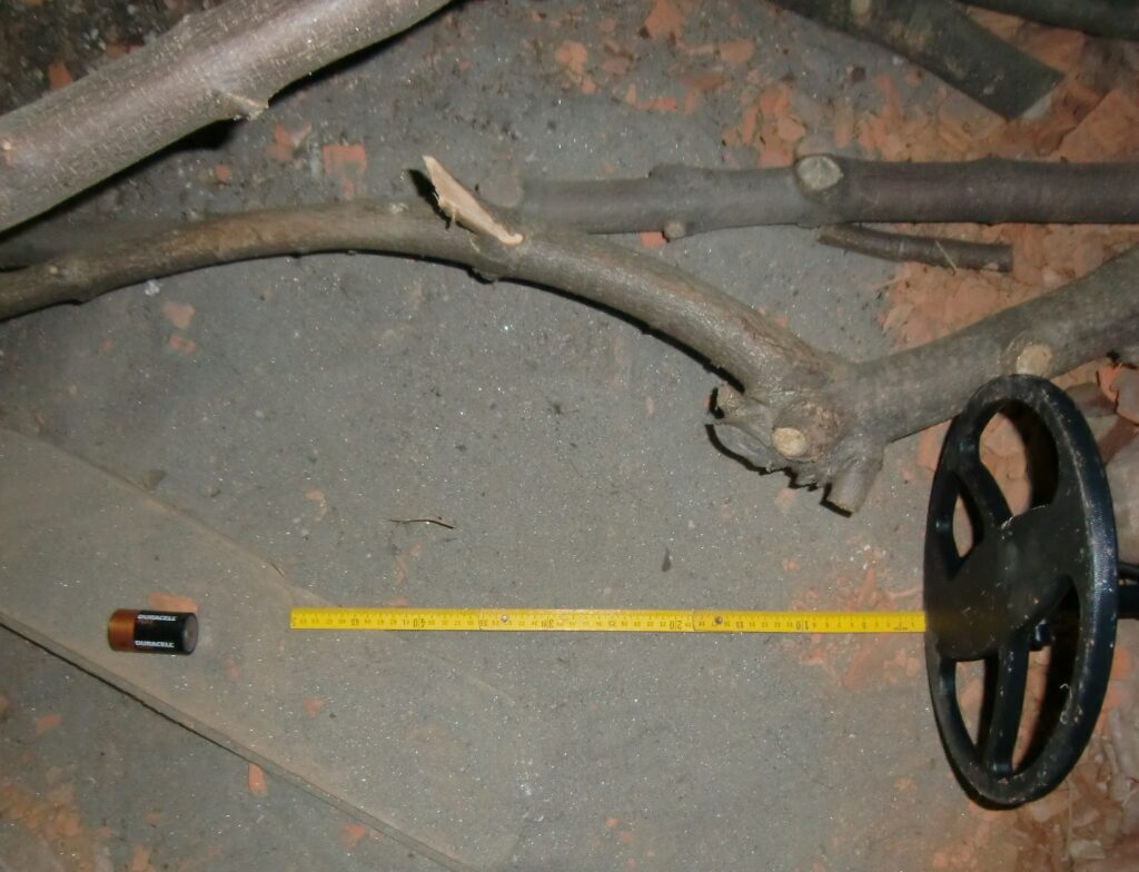

        The test object is a 5,5cm long and 3,5cm thick 1.5V battery. In air it was detectable at that medium electro-smog location at 60 cm with good signal!
        But also the buried under bricks test worked amazingly good. Those bricks have some small cracks and spaces inbetween and not all have the same mineralization degree, but the DeepHunter found the battery with a clear signal even 10cm above the bricks surface at that e-smog location - this is in total around 35cm or 1 feet deep.
        A much better test could have been made if those bricks would be pulverized or broken into very little pieces and if it would be done at an electro-smog free location, but that way now the test shows very good the performance of the DeepHunter under extreme tough conditions.

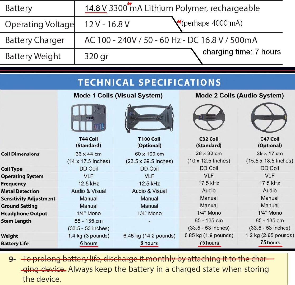

          Here are some corrections of the DeepHunter Info pdfs:
          - After testing it I found out that the Motion Mode 2 search time is 75 !!! hours (not 25 hours). This is a 3x improvement
          and a very long hunting time! Mode 1 is 6h, not just 4. Btw. the DeepHunter package contains already 2 accu packs.

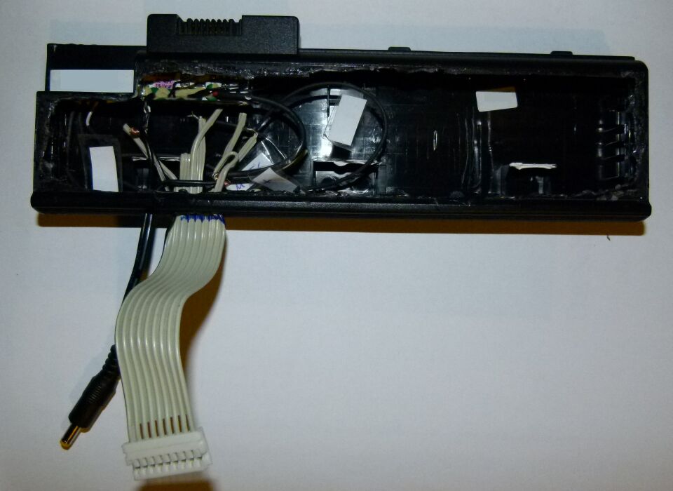

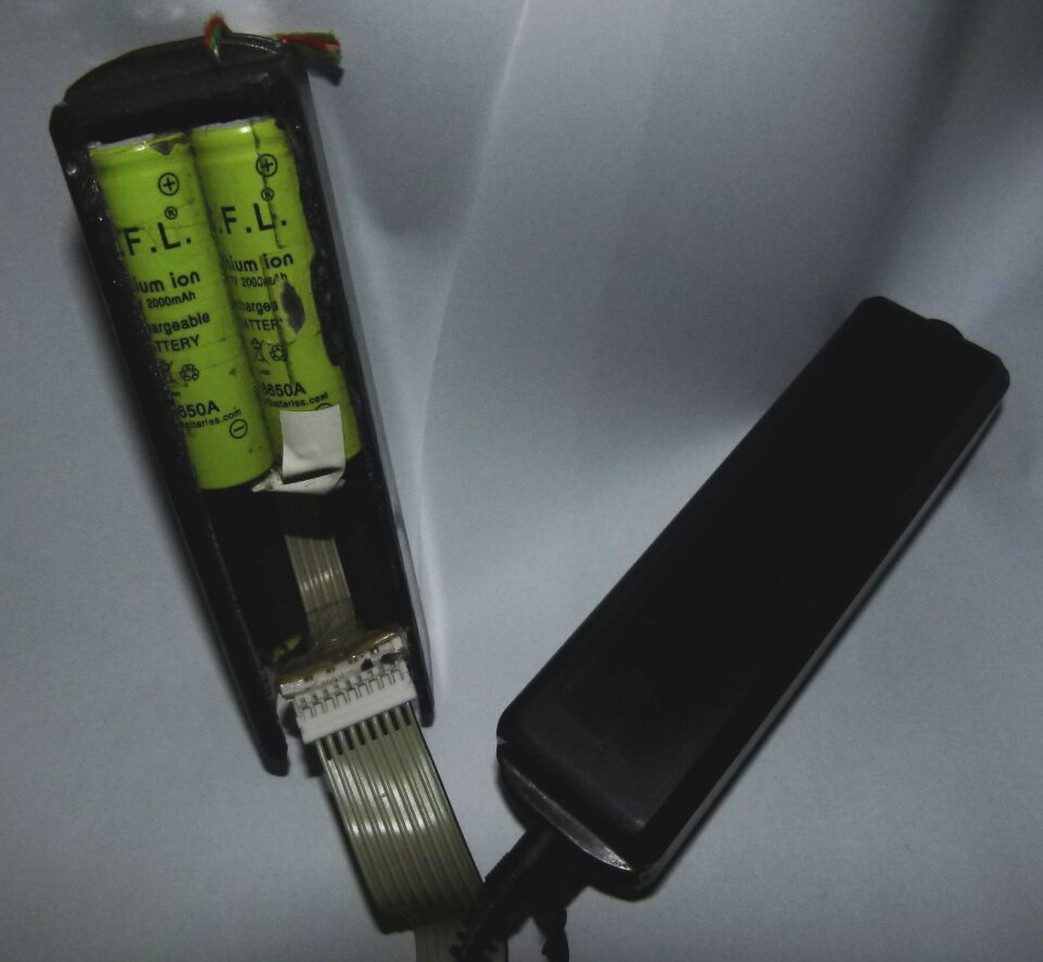

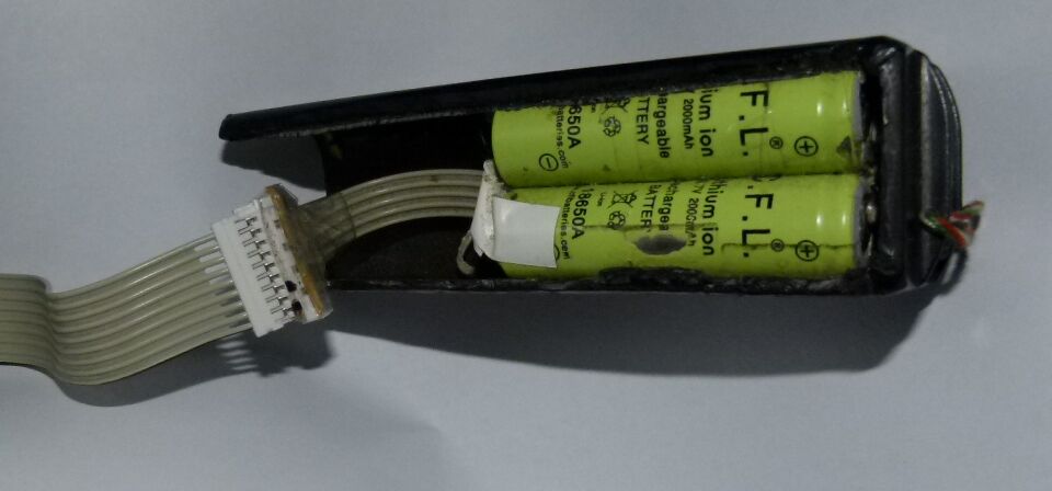

          - The LiPo accu-pack has 14,8 volt, not 16,8. The accu is 4 x 3,7V = 14.8v while the peak loading voltage is 16.8 ( 4 x 4,2 volt)
          the accu-pack contains two parallel wired 4 x 1650 mA or even 2000 mA accus, here a sketch:
          . /--3,7--3,7--3,7--3,7--\
          . \--3,7--3,7--3,7--3,7--/
          - The security info tells that you should discharge the accu monthly. This is not needed and perhaps not possible,
          because that way the charger would first have to discharge that high mA accu very fast, and there is no LED that
          signalizes this. I'm having now the old Jeohunter Accus since 2010 and they are still good working.
          To keep accus alive the only thing to do is charge them every 6 months and keep them stored at some cool and dry place.
          It's good to remove them from the device if those device has no complete off switch. Most smart-phones and digicams
          are all the time in standby-Modus and that way of course the accu-power will get empty after a few months.

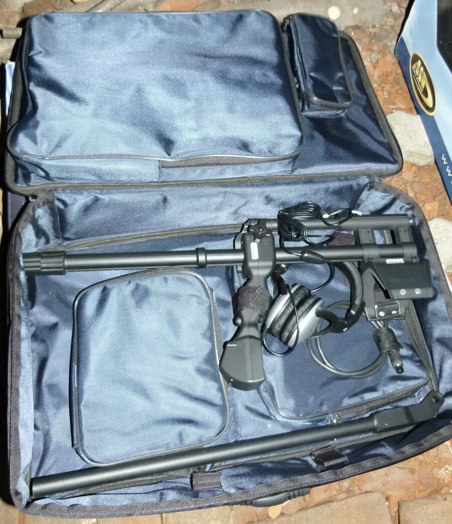

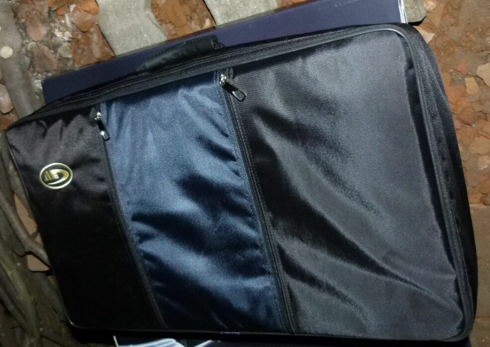

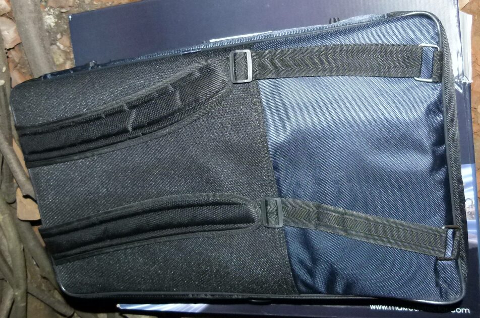

              And: the DeepHunter now comes with a much smaller carrying bag with rucksack-function:
              Jeohunter: 85cm x 50cm x 13cm
              DeepHunter: 60cm x 40cm x 15cm

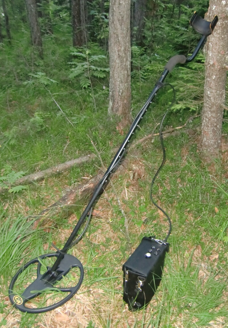

              Seen under real conditions at a so far unknown but antique site using the DeepHunter:
              it starts already by reaching a larger area 'cause the 45cm coil can be used much more comfortable.
              If someone found interesting old ruins or structures now he can check out directly if there is cavity
              or if there is something very deep - even already with the 45cm non-motion coil and Mode 1.

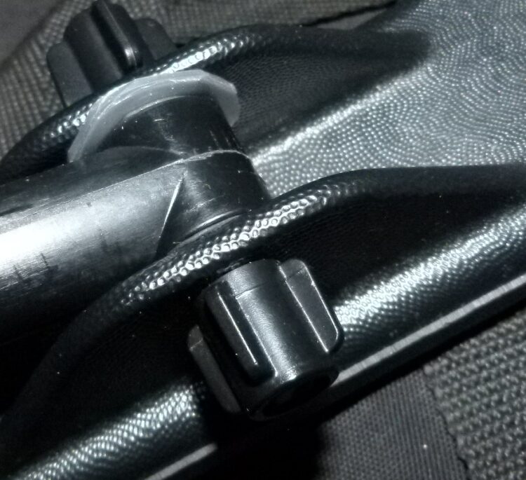

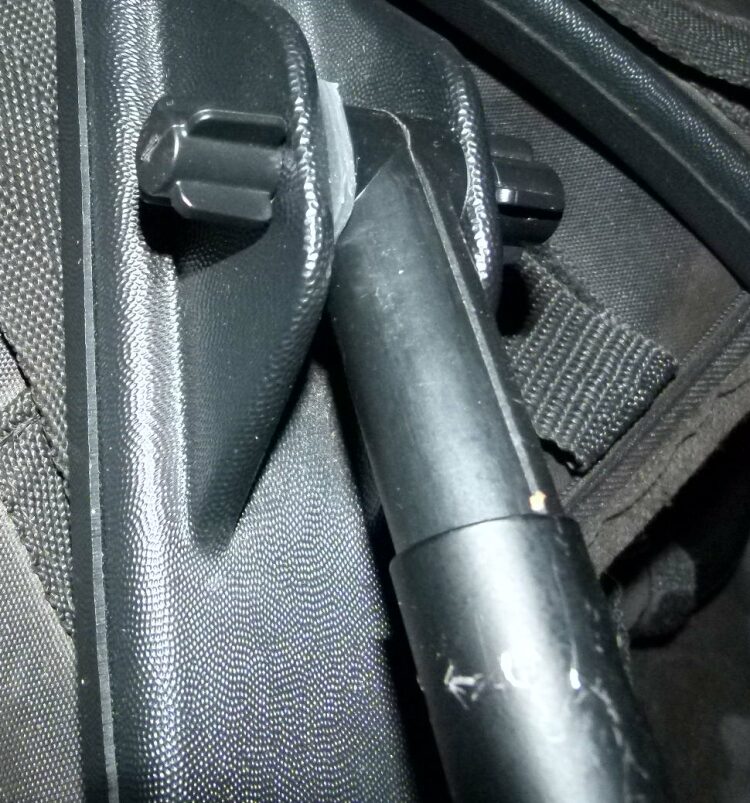

                  The usual holder for the 45cm non-motion coil contains a new very good push-button-field but for the motion coil this is not needed and
                  it is easier to work and directly start with hunting if the motion-coil uses a different pole and holder-handle.
                  But first I have to say that the weight now is really very good improved.
                  The holes for the plastic-screws have the same size so you can use the very lightweight poles and holder from Garrett with the motion-coils.
                  All what is needed is some around 1,5mm thick rubber disc with hole in it and the Garrett coil holder fits perfectly for the DeepHunter coils.
                  The holding weight really is fantastic this way:

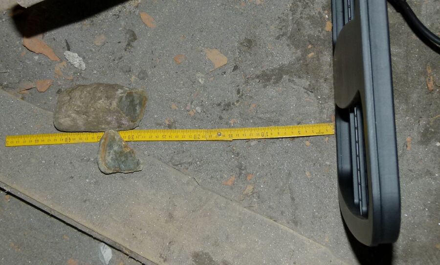

                          JeoHunter vs DeepHunter depth compare
                          including mineralized stone detection
                          I really must say that Makro-Detector also made a fantatic job by improving the non-motion-circuits depth and sensitivity !!!
                          As one of the few persons with Jeohunter and DeepHunter it was a Must to compare both detectors and the result is really satisfiying:
                          An improvement of 20% for coins and around 10% for larger and deep objects !!!

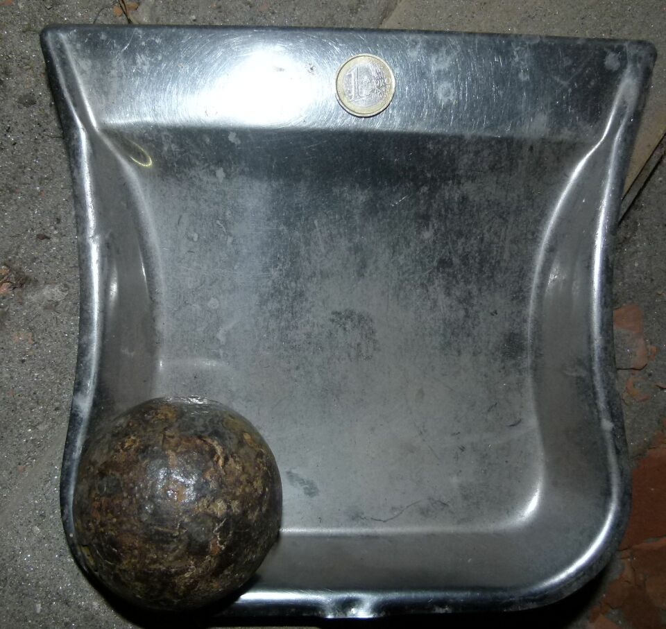

                          Here the in-air-test results at e-smog area, both detectors 90% sensitivity and Ground Balance value: 0 with the standard 45cm non-motion coils.
                          1 Euro coin, 23mm:
                          JeoHunter: 25cm
                          DeepHunter: 30cm
                          Cannonball, 7cm:
                          JeoHunter: 50cm
                          DeepHunter: 60cm
                          Dustpan, 22cm:
                          JeoHunter: 87cm
                          DeepHunter: 95cm
                          For larger objects (50cm and more) at around 2 Meters the depth-improvement also may be around 10% compared with the JeoHunter.
                          And if using the large 1m coil it may be even 15-20%, because that way the medium-large objects have the same size-to-coil ratio as
                          an usual coin would have to the medium 45cm coil.
                          So the improvement for the "professional-used" non-motion-circuit is really a hit and it will pays off while hunting for hard to find
                          very deep treasures for shure.

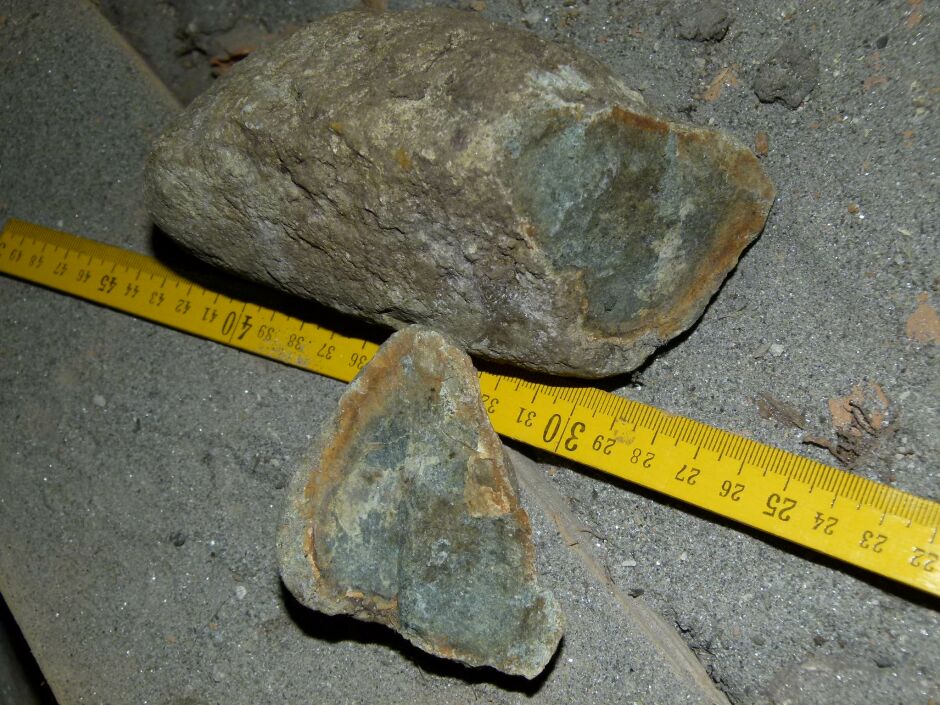

                          The mineralized-stone was around 15cm and detectable at 30cm with the DeepHunter.
                          But this was just a little demonstration that the DeepHunter can find it, because nowadays besides the Blisstool with its double-beep there are almost
                          no other metal-detectors that find cavity or such special things at all! What a pity for the treasure-hunting world and many metal detector producers!

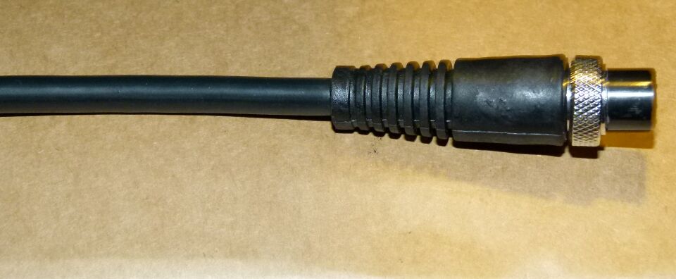

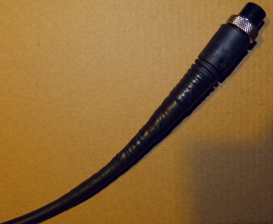

                          The DeepHunters coil-cable now also is improved because it has now a plug-diameter that directly fits through the poles.
                          For improved security the region directly after the connector should be taped a little bit because while sweeping this could be
                          a cirtical region where the movement-forces could concentrate so to prevent cable-breaks some tape at this region is always better.
                          This is totally simple work - see below the pictures.

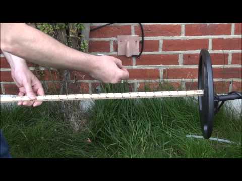

                            Can you show us video(you made it) how deephunter detects cavity?
                            Hi, I found the already made (for the JeoHunter) cavity test - please check out the pictures and the additional info below.
                            For a DeepHunter cavity video I need to find a special location with at least low mineralized soil. We have much limestone here but its not good enough mineralized.
                            Perhaps I will dig a large hole where the soil is loamy and leave there an empty room below. Just walking over some little bridge where the ground is 1 meter below is too simple.
                            _________________________________________________
                            Buried a ca. 20x20cm plastic-bucket surrounded by and under a 10cm strong cover of mineralized bricks.
                            The cavity had been detected but the ground balance was important.
                            It was at minus 60, which is slightly higher than the Ground Balance hot bricks zero level of around minus 85.
                            If the GB is set lower, as example at minus 120, the bricks start to give a positive (metal) signal and difference in ground-thickness can't recognised very good.
                            In my experiment the cavity started 10cm below the surface.
                            Conclusion:
                            Getting the best cavity detection the ground balance setting should have the same or a little bit higher value as the mineralisation grade of the ground.
                            Get that value by lifting the coil from 5cm to 40cm over the ground until there is no signal at all.
                            If you come near the surface and the DeepHunter starts to signalize "metal", the ground balance value is to low (raise it with the plus touchpad button). Same vice versa if you hear "cavity" sound.
                            After this press accept and you're ready to search.

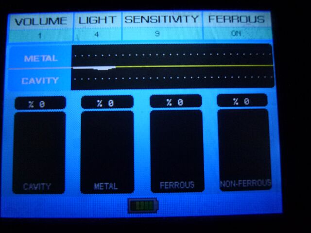

                            DeepHunter Ground Balance Info:
                            Correct Ground Balance really is important for getting the best depth and correct search results. It is not the fault of the Jeohunter if you get "wrong signals" or dig empty holes.
                            If you put the GB to -200, hot rocks, mineralic stones and even bricks will get recognised as "metal".
                            The "not detection value" of bricks / hot bricks is around -90.
                            And that same value for mineralic stones is around -150.
                            At GB -80 the sensitivity for meteorites or rusty iron or steel objects is maximum, while at plus 100 the sensitivity for noble metal is improved.
                            This applies to all metal detectors and means that at low mineralized soil the chance to find deep noble metal objects is higher (detectors work deeper there)
                            and that at high mineralized soil after adjusting ground balance to those conditions it is easier to find meteorites and iron or steel objects very deep.
                            If ground balance is set correctly, you even can detect some cavity halo around rusty iron objects. Shure, it is not "real cavity", but with this method you can skip digging rusty objects.

                              The shown tests have been made with sensitivity 9 which is already extremly high if there would be no e-smog at all!

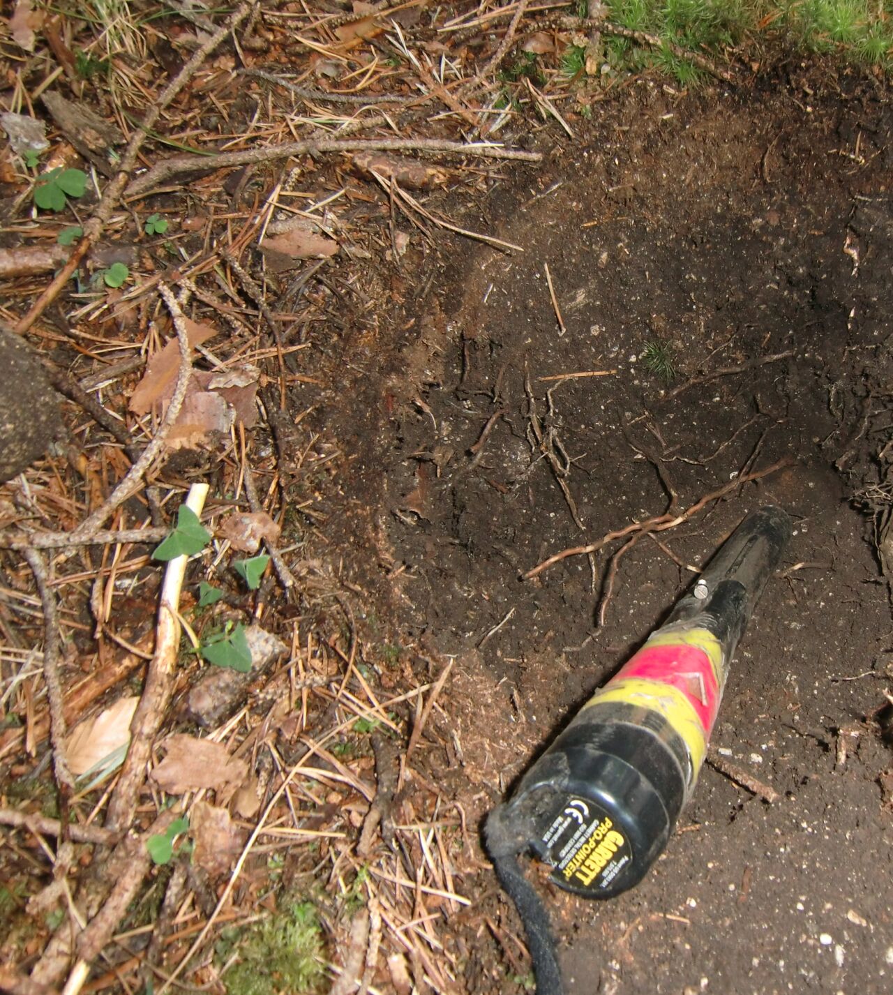

                              Pinpointer markings info: The lower yellow tape is at 15cm (6 inch) and the upper at 20cm (8 inch)

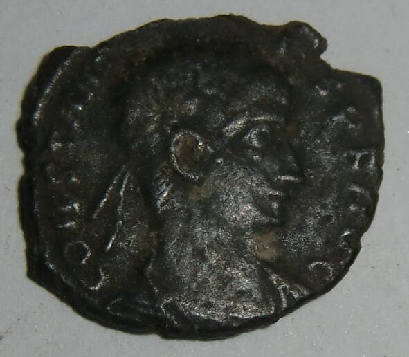

                              The just 13x15mm small, thin, low inductive and already very "de-metalized" roman Constant. coin was found there at 20cm depth.
                              The hard to detect special nail (nearly totally rusted since 2000 years) was vertically in the ground,
                              unfindable with the usual extreme deep Blisstool LTC 64 that I used to clear the region there so far, the DeepHunter found it at 15cm depth.
                              The unreadable half coin was at ca. 17,5cm, also at this extremly high-esmog location - the huge high voltage pylon is only 10 meters away.

                              Picture info:
                              The roman coin can be seen directly at the center of the first below picture. It was originally exactly at this position.
                                1st posting ever written with original Metal Detector battery !
                                Here you see what electronic knowledge can do -
                                replaced the old Laptop rechargable LiIon batteries by those of the JeoHunter / DeepHunter
                                (both detectors are working with the same type of accus)
                                So this posting now contains the true power of metal-detecting,
                                because it uses directly the metal detectors same power-source!
                                On a vacation this is great, one and the same batteries are usable for the metal detector and computer.
                                Instead of the before 2000 mA/h now I can use 6000mA with the Laptop which is 3 times longer.
                                First I tried to connect the full 14,8v directly, but the Laptops balance charging cirucit requires all 3 connection-contacts inbetween, too.
                                And the directly net-adapter input (19v) didn't worked with 14,8v, otherwise I just would have needed a adapter-plug-cable for the accu-pack.
                                There are many ways leading to success, if the total simple ones are too simple a bit more complicated can work!
                                But better first try the simple ones for saving sometimes alot unneeded work etc.
                                btw. the computers power management tried to fool me:
                                First it showed 40 minutes battery time left while the full 6000mA where connected (the below shown 2 accupacks)
                                but now the laptop runs already since 1 hour 20 min while all the time and still 2minutes (7%) left is shown.
                                This has to do with the special charging: the 4000mA accu pack charges the 2000mA balanced charge-wired accu pack.
                                Therefore it is important that both accu-packs must have the same high charging state before connecting them (= effective a 14.8v parallel connection)
                                This way the laptops charging circuit can be tricked, because it measures the internal cell balancing voltage and discharge timing.
