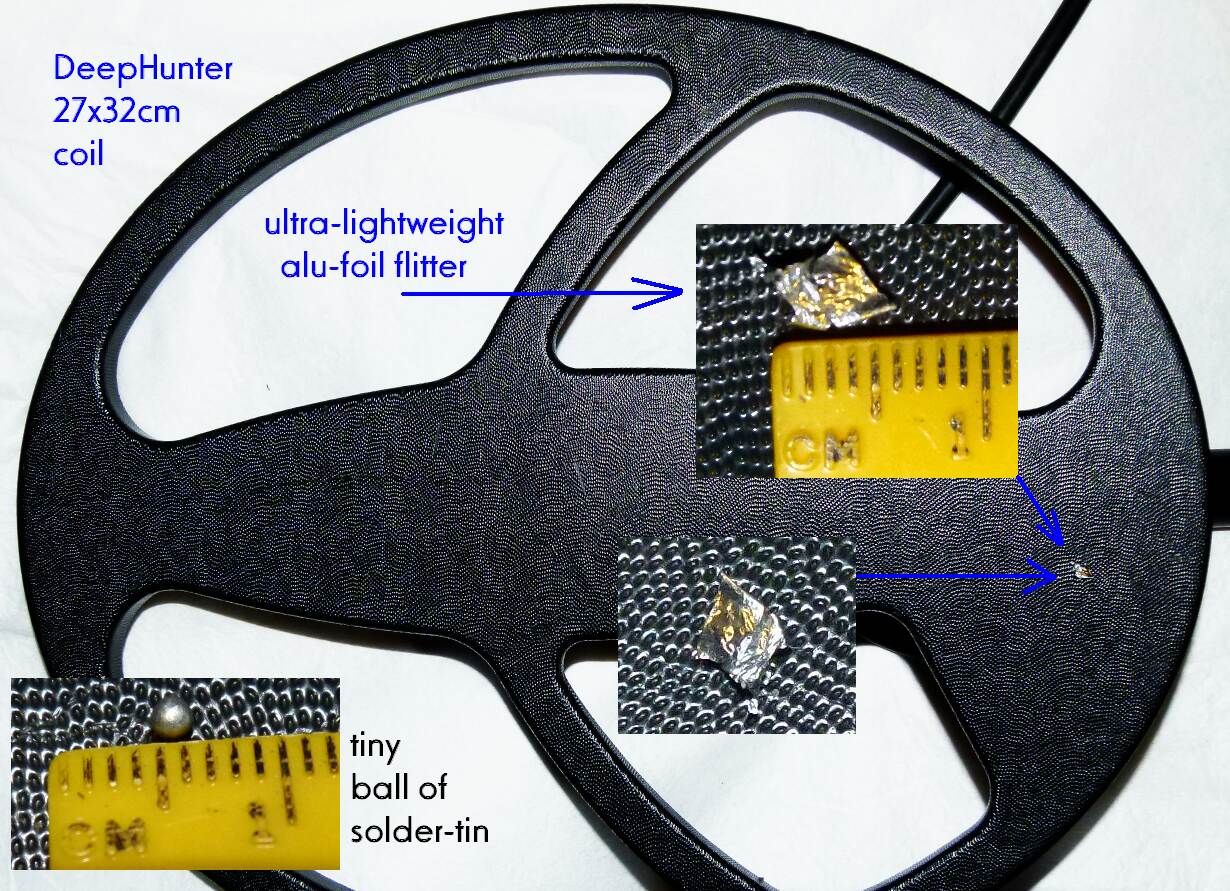

            detecting the smallest possible finds with 32cm coil - test
            Today I got some real interesting results - finding out what is the smallest stuff the DeepHunter is able to detect.
            That ultra-thin and perhaps 0,001 gram lightweight flitter of alu-foil was detectable nearby TV and computer
            from around 2,5cm (1 inch) at all-metal and sensitivity 8,5, the same with the 1,5mm small compact tin-ball.
            The coil has to be swept pretty fast at ca. each 25cm x 25cm spots for best ultra-small results.
            For a 27x32cm coil this is absolutly amazing, because this is not a super small 10cm goldnuggets coil but one
            that also is able to find beer-caps at ca. 50cm and large stuff at super depth where any 10cm coil fails completly!
            And because of the high electro-smog immunity it doesn't matter if the site is in the middle of the living-room
            or if its outside in the wilderness. Of course a very good pinpointer is needed to locate all the super small stuff.

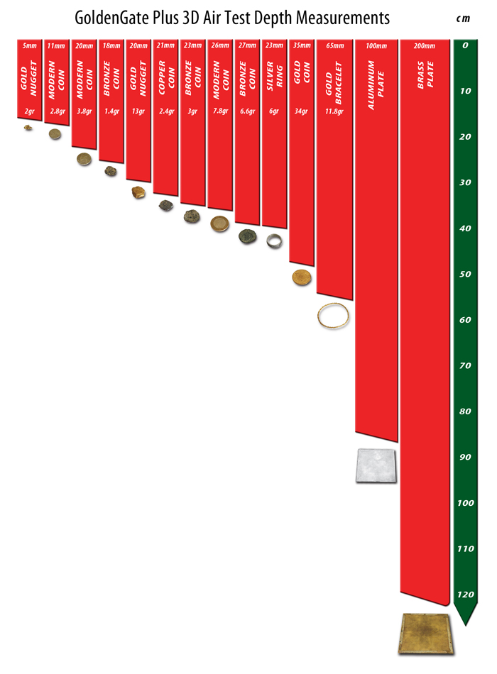

                  air-test:
                  http://www.youtube.com/watch?v=3DJRqHCHqOA
                  depth test:
                  http://www.youtube.com/watch?v=HpKWeBw8TCU

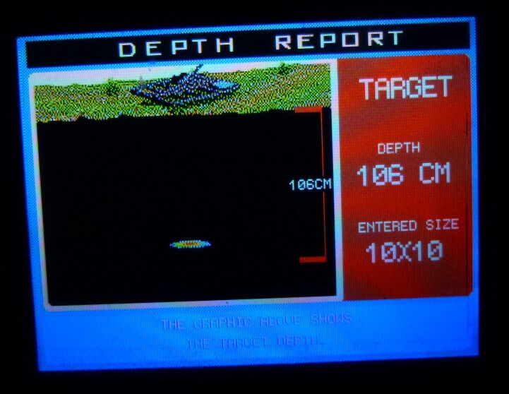

                    But this is not that much, a 10x10cm alufoil-plate will be still found at ca. 70cm with the Golden Gate.
                    btw. I have tested it - the DeepHunter with C47 (39x47cm) motion-coil also is able to detect a
                    10x10cm alufoil-plate at 85cm in air which is the same distance as with the nonmotion T44 coil.
                    The T100 coil found the 10cm alufoil-square even at 90cm while it detected a 20cm alu-square from 1m15.
                    The depth analyses was very exact. Those tests were made in the living-room with all kind of metal-stuff
                    nearby. This is absolutly no problem for such detector. Sensitivity-setting: 9 (one step below the highest).

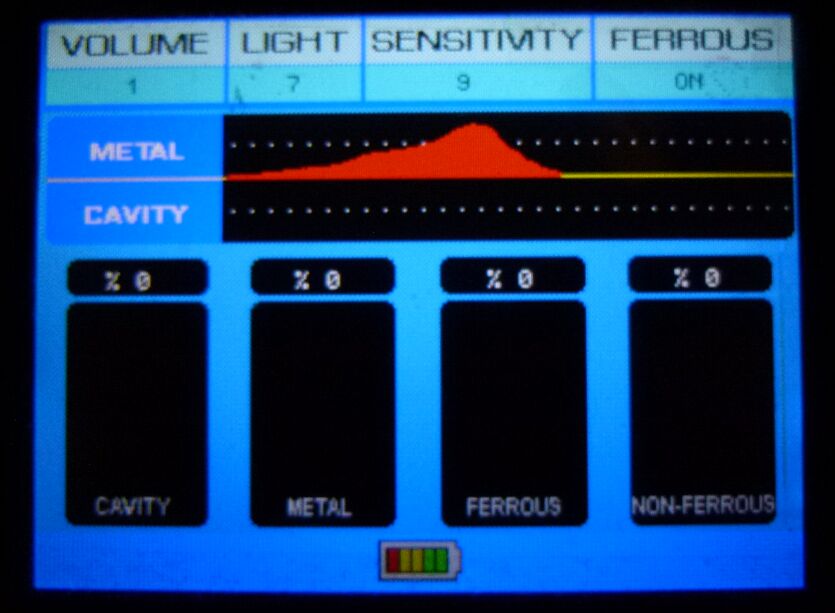

                    Interesting also is the oscilloscope-curve:
                    For the 1m coil T100 the 20x20cm alufoil gives a very weak signal starting at 1meter20 while the
                    100% power-peak shown on the screen already is reached if the foil is still 75cm away from the coil!
                    This demonstrates how sensitive the DeepHunter is, because the closer 2/3 of the whole detection distance
                    and ability already is far stronger and over the shown 100% limit.

                      • Hi Funfinder. Buying the Goldengate was just a cheaper way of getting into the 3D detector game. it's my new toy and I'm excited to see what it can do. If it surprises me and I find a good application for it that will be a bonus. I'm waiting till the summer of 2015 for the new Nokta. If that looks as good as they are alluding to then that will be my next purchase, otherwise I'll join you with a deephunter. See attached.Click image for larger version
Name:	golden gate (5).jpg

                          • Originally posted by landman View Post
                            Hi Funfinder. Buying the Goldengate was just a cheaper way of getting into the 3D detector game. it's my new toy and I'm excited to see what it can do. If it surprises me and I find a good application for it that will be a bonus. I'm waiting till the summer of 2015 for the new Nokta. If that looks as good as they are alluding to then that will be my next purchase, otherwise I'll join you with a deephunter. See attached.[ATTACH]31726[/ATTACH]
                            Hi landman,
                            thank you for the depth jpg - I assume it shows the 40cm coil values and with 120cm for a 20x20cm brass plate in air
                            it may detect it at medium mineralized soil at 90-95cm but at sensitivity 10, so you really need a good practise first
                            because usually, depending how high mineralized is the soil, searching at sens. 8 is the intermediate standard.
                            btw. from my point of view it's not about the 3D stuff and all the additional gimmicks - what counts is depth, quality
                            and reliability. Thats why I prefer Makro-Detector over Nokta, because The Jeohunter and meanwhile the DeepHunter
                            focuses on what really counts and don't wants to create some kind of "Multi-Apps Computer-Metal-Detector" with all
                            kind of additional stuff. Depth analyses and visual 3D images are great but they only count for the real deep hunting.
                            If ca. 85% of all finds are not that special deep, you will proceed much faster forward if you don't bother
                            with scanning and analyzing it at all, just dig it out within a few seconds or minutes and save your time.
                            Or even better - clear the area with a Garrett Ace first until all the surface near stuff has been removed
                            and afterwards look with the professional equipment for the real deep stuff. The larger the coil, the bigger
                            and deeper treasures you will find anyway. And often this is absolutly true: The deeper, the more rare it is!
                            Infact its not the "3D detector game", its the ultra deep detector game including using large coils and
                            of course this only is useful at real promising and "rich! locations. And by the way those non-motion detectors
                            simply are super-immune against electro-smog, though I only can speak for the Jeohunter and DeepHunter
                            but I guess the Nokta may be pretty the same if it comes to that. If there is an antique roman street directly
                            nearby a town or highway with electricty lines etc. only the best motion-detectors still offers an useful depth.
                            And of course thats also the reason why are nonmotion deepdetectors much better penetrating mineralized soil.
                            They use a very powerful but stable EM-field which doesn't gets blurred away by the motion-circuit.
                            Btw. with some good bungee-cords from a gym or sports-shop you can built your own weight-reducing-vest,
                            just be careful that the material is strong, thick and secure enough so there can't occure any health-problems.
                            And also important: Good luck for finding some great treasure-locations where your detector really can show
                            its full power because this is not for gold-nuggets but for the real deep and so far undetectable special stuff!
