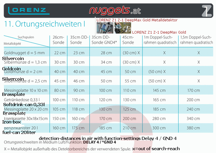

    I can not speak about the Deep Tech Pioneer 4500 but the german company Lorenz is know as expensive
    but of course reliable quality.
    The price here is 5.200 Euro (info in german):
    http://nuggets.at/LORENZ-Z1-Z-1-Deep...Metalldetektor
    or google translated in english:
    http://www.google.com/translate?u=http%3A%2F%2Fnuggets.at%2FLORENZ-Z1-Z-1-DeepMax-Gold-Metalldetektor&langpair=de|en&hl=de&ie=UTF8
    I have translated and attached the depth-info:

    landman, if you know one who has a P.I. with 1m coil bury some testobjects and walk over with it.
    Only that way you see the difference of the posted in-air depth values and in real.
