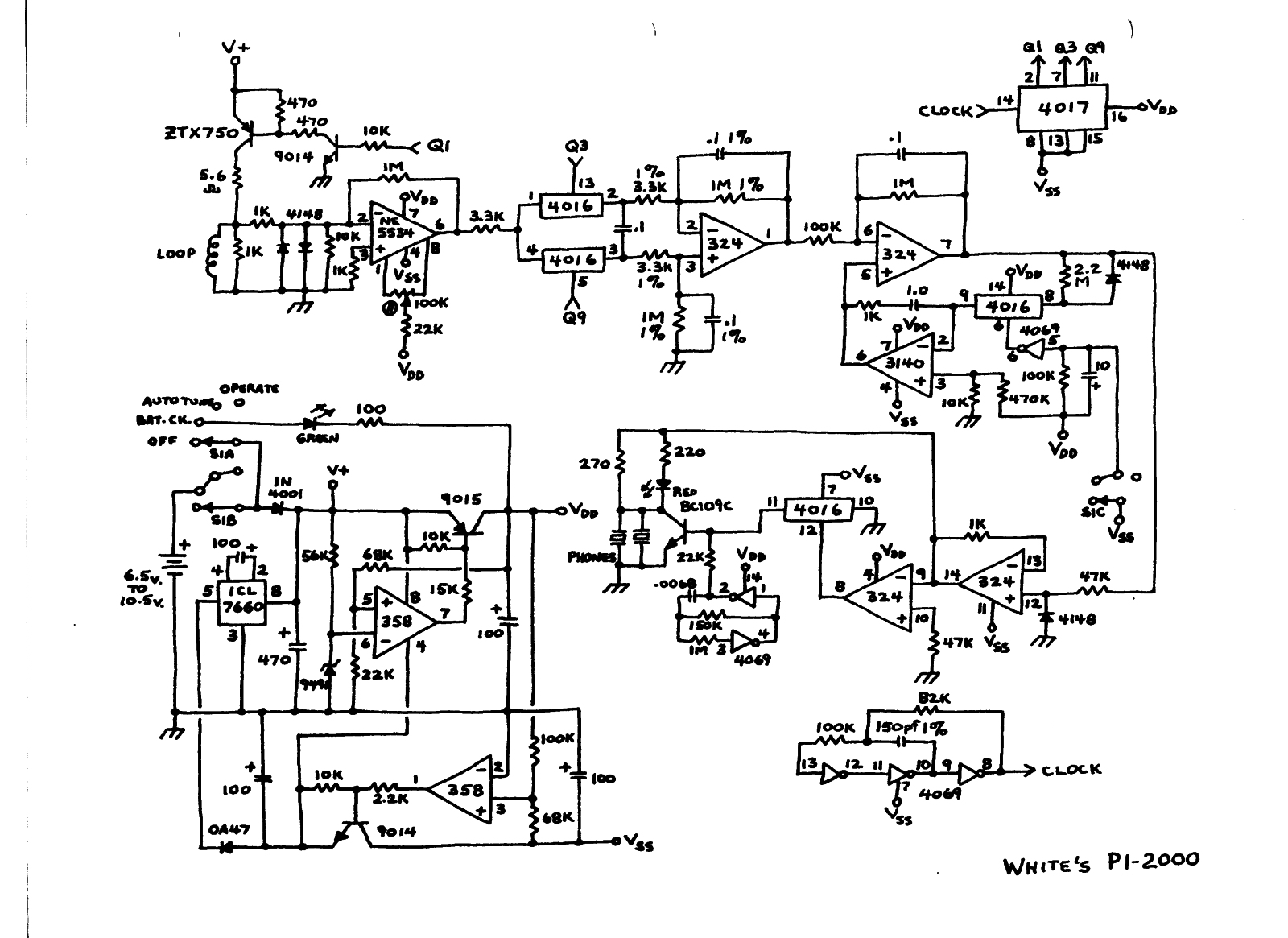

    I have the 2000 pi the next model up from 1000, which is a good detector,
    could you please attach the lay files thanks

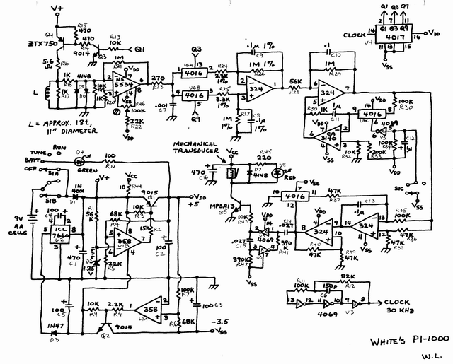

        The 1000 has been around for a long time
        and work well, the main difference between the 1000 and 2/3000
        is the 1000 had a mechanical knocker that you put inside your wetsuit
        in the 2/3000 they went to tones in head phones.
        With my 2000 to tune it, you put the coil on the ground and turn
        the control to tune, wait a few seconds for it to settle
        then turn the control back to operate.
        The clock runs at 30Khz and is divided down to 3khz TX pulse via the 4017.

            In the PI1000 the mechanical transducer was a 6 volt 4PDT relay. It was loud under water.

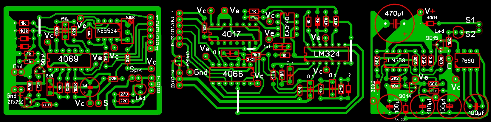

                  WARNING: My boards are still not tested. I THINK they are fine, but I can not confirm now. Any comments about errors detected will be welcome.

                    Some bugs fixed...

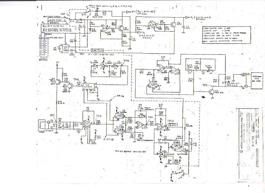

                      The news is that the boards are of the White's 2000, not 1000 (according to the diagram posted here by 6666) and is entirely consistent with the PCB´s of the copies and my PCB´s, which are not yet fully confirmed (yesterday I found two or three gross errors).
                      I Will keep you posted.
                      Fabian
                      PS: 6666, Have you got some pictures of your 2000 pcb¨s? Maybe with some photo´s we can confirm that.

                          The final PCBs
                          I think it's all good, I did not find errors. I found inconsistencies between drawings of PCBs and diagram are the values ​​of some resistors I guess I'll have to experiment when assemble. Now I am a bit complicated with time, but when I can, I will build and test.
                          Ah! I forgot: from now on, this thread should be called Whites 2000
