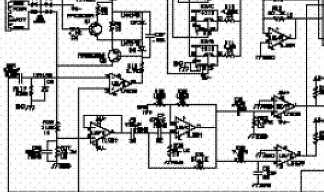

      In this schema fragment Whites XLT. A similar scheme synchronization Egle spectrum. The quality is poor but the principle is important. It consists of HPF. filter that cuts off part of the influence of soil, its range of subsonic frequencies. 2 comparator controlled very simply. It's not in the younger model "6000" appeared only in these. The expensive devices and apparently is, a compromise.
      Either the generator depends on the parameters of the circuit TX, its inductance. Inductance varies from the environment, the current phase of TX is shifting. Has an instant shift. PLL will be looking for a stable point for a while. Synchronization MD will also be some time resent.
      This is a parasitic effect, which is then amplified in 1000
      If there is a coil and a capacitor is in the circuit - there is phase deviation.
      This practical results: put a coin on the ground from above. Change the synchronization of the sync detector circuit TX. All right, the device is working properly and recognizes the coin. Change sync detector of quartz, the device is not working properly, the coin is not defined. This means that the circuit TX with Q = 5 (!) Does not retain a stable phase. The amplitude of the voltage in the circuit does not change.
      By itself, the amplitude is not important because the synchronization occurs at a transition sine 0V
      Reference phase of the primary field TX should be fixed under any external disturbances. The amplitude is not critical to parents, it is the reference phase. It defines the parameters of the detected targets, the size of the vectors XY.
      The high Q of the circuit in the oscillator does not yield immediate stability phase. That it's for. TX generator should be considered as a metal detector, not as the generator itself.

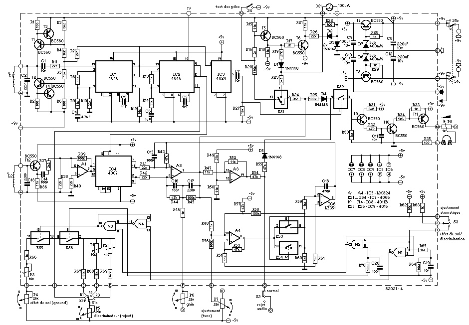

Name:	Elektor VLF 02.gif
ID:	335993These questions have already been raised many time ago. But were ignored.Click image for larger version

            I agree with your conclusions and methods. This is really a normal subject. I will check it as much as possible.You did not try to bridge PLL?
              The Elektor circuit is a fine catch, I was not aware of that one. There are a few problems with Elektor Tx that I can see, primary in sense of off resonance phase sample. But in essence it is very similar to my tank locked loop. Funny thing is that I also made some experiments with simulating this principle in off resonance, and it has potential for a good pinpointer.
