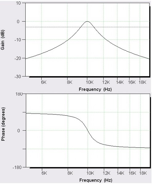

        Phase slope steepness is related to the tank Q, so it is of less consequence if tank Q is low. In case of Tx tank it is almost irrelevant because it is the voltage across the coil and the resulting current through the coil that matters, not the current through the tank capacitor, hence Tx Q is of little consequence if you drive your coil with voltage. In case it is tuned badly - it will just use more current. (PI machines do that all the time )
        Rx front end can be realised with parallel tank, which is in effect a low pass filter, as the voltage source is in series with the inductance, and with a capacitor it forms an L topology low pass filter. It improves input noise by means of up-transforming the input impedance and cheap op amps can deliver good results. It must be operated off-resonance because at the very resonance the phase slope is very steep.

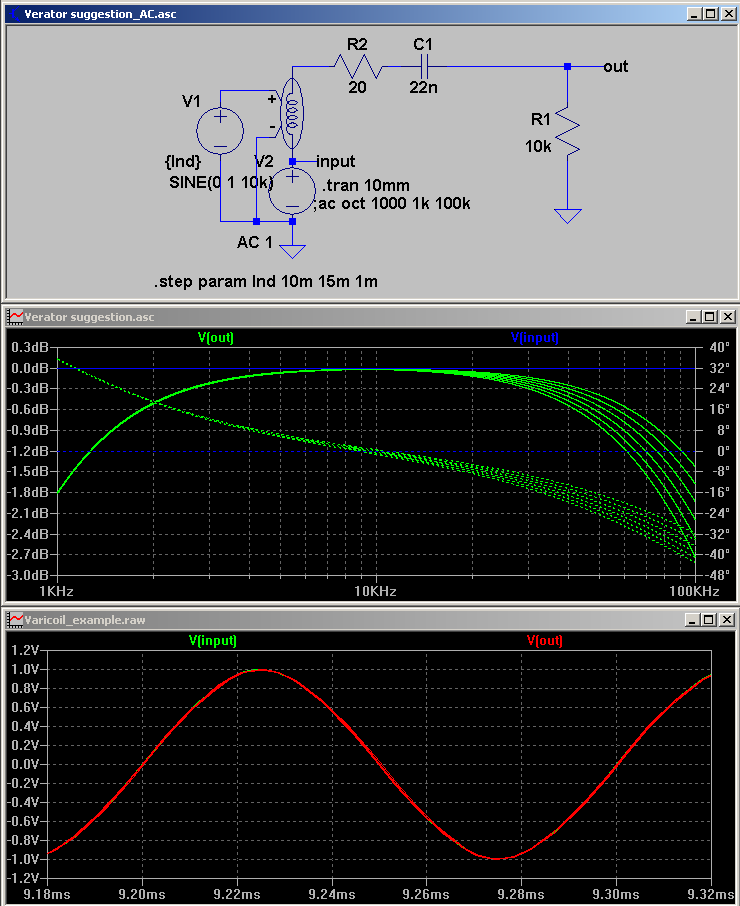

        Using a better op amp makes series tank a better solution because of very low Q (<0.5) but it does not perform up-transformation so there is no noise improvement in this topology - the op amp must be low noise. The way to fix it is using transistors to reduce input noise. I think this is a far superior solution because there is no AM->PM problem related to phase slope.

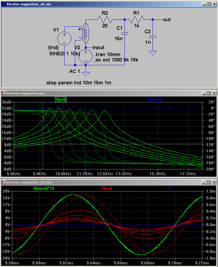

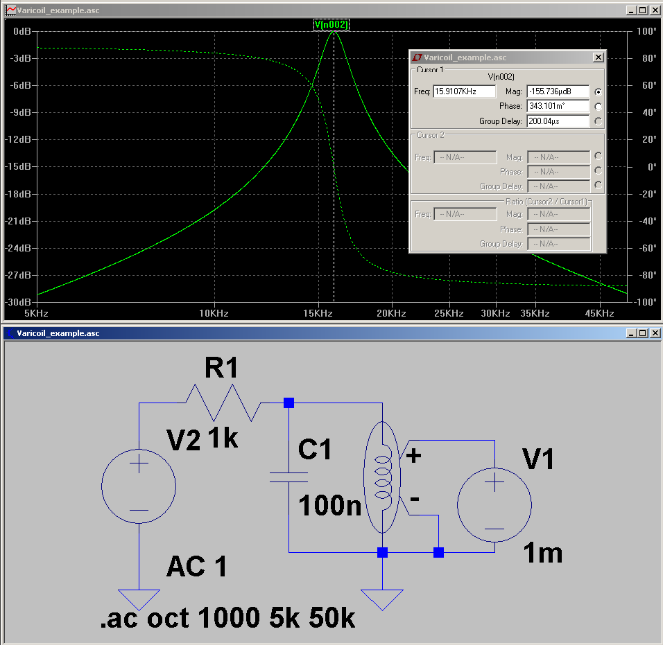

                        I played with a voltage controlled inductance, so called "varicoil" which may become handy for modelling behaviour of coils in varying environment. It is controlled by a voltage in a way that the sensitivity is 1H/V. In the example circuit below 1mV of control voltage stands for 1mH inductance. This is an idealised component with no possibility of magnetic coupling. It is a hierarchical model so it must be accompanied with files Varicoil.asc and Varicoil.asy
                        Let's see what will Sergey come up with. I'll proceed with modelling a Verator Rx front end to see what happens with phase when inductance changes up to 50%.
                          And now the verdict. I assumed Verator to have 10mH Rx coil because I have no idea what the actual inductance is. I was very merciful with placing the resonance having the 50% inductance change in my mind. And I assumed 10kHz as operating frequency. As inductance rises, the Rx tang gets closer to resonance, so the amplitude rises, and phase also shifts. It is obvious that the voltage on the input of an op amp is 3-18 times larger (the impedance transformation effect), but the most important feature is a rapid change of amplitude and phase. It is also apparent that the parallel tank is in effect a 2nd order low pass filter...
                            On the other hand, a series tank does not provide impedance transformation, but instead it features band pass characteristics, and a very small phase change over 50% inductance increase. It would, however require a better op amp on input to maintain the same noise figure, but it provides great improvement over the original layout in terms of phase and amplitude stability.
                            See for yourself...
