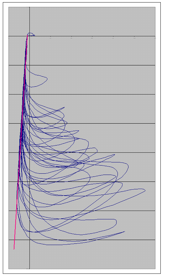

    Output synchronous detector: ground + coin ->
    http://md4u.ru/download/file.php?id=9364
    filter output:
    blue - the classic filter frequency
    red - filter by phase of ground (W6000, K18, K20, Verator…)
    http://md4u.ru/download/file.php?id=9363
      But what I see here is more deviation for ground signal in your proposed solution. Isn't that a bit odd?
      I see that the ground filtered solution is compressing the ground response, which is good, but somehow the second picture is showing more deviation for ground vector angle than the initial ground + coin response. Could it be that phase noise is that much at play?

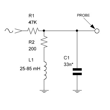

        To evaluate the characteristics of the phase I use here is the inclusion of the circuit. The phase shift for operation should be less than 75 degrees. Generally 77-83.Click image for larger version
        The fact that the offer to apply a linear course, but it's more for pure sine wave. For my application is too broad band.Will be an opportunity to keep in mind. Allocate time to see your generator PLL.

          Assuming Verator Rx coil comes in a range between 25 and 85mH, and according to a table of Verator schematic frequencies can be set between 5 and 20 kHz. Assuming 200ohm being a coil resistance, it's minimum noise is ~1.8nV/sqrt(Hz)
          So in case you are using some real low noise op amp in non-inverting configuration you'll benefit from series tank configuration. The other option is replacing the op amp preamp with a discrete preamp, where you can easily achieve input noise below 1.5nV/sqrt(Hz) and keep your money in your pocket.
          The quasi-resonant parallel tank front end is a thing of the past when op amps with 20nV/sqrt(Hz) were considered low noise. It serves a purpose of transforming low input impedance of a coil to some higher impedance near the equivalent noise source of a bad preamp. We really do not have to do that any more.
              The suppression of the signal with the phase of the soil for both methods is possible with a stable phase of the ground (red straight line drawn by you). This is achieved by a crystal oscillator and Qtx<1. Oscillator is not able to ensure the stability of the phase of the soil.
              Distortion of the signal from the target method for GB caused by a distortion of the signal function: S=(G+T)*sin(dф).
                  I think it is largely overrated, as the device with sweep driving signal would not have much problems attenuating ground. Multi frequency devices show precisely that: the ground response does not change significantly over wide frequency spans.

                              @Verator, Sure, that's precisely the reason I'm not discussing absolute noise but spectral noise density instead. The whole point is that the ultimate noise source is the coil's resistance, and it's spectral noise density is ~0.13sqrt(R) nV/sqrt(Hz)
                              This way 200ohm coil produces about 1.8nV/sqrt(Hz) noise. As NE5532 has about 5nV/sqrt(Hz) it will be some 9dB noisier, and will give some 10% or so detection depth loss (unless there is some kind of impedance transformation). Of course, keeping everything else as ideal as possible.
