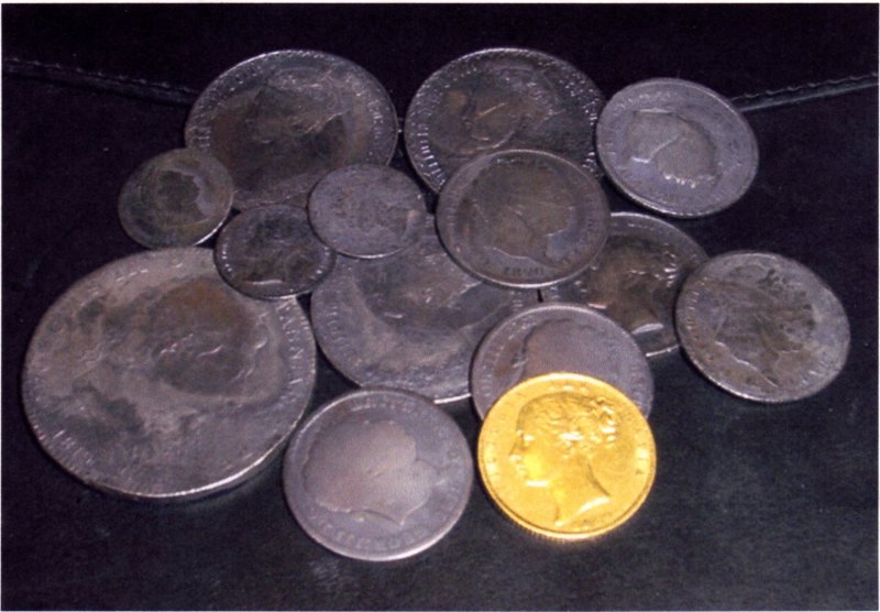

I've just monitored the same targets but now looking at the DC out of the main diff integrator with the Ground Balance circuit disconnected results below.
Sample is 10us in width and 10us from TX end.
No spacer...
1x 50c = 180mv
2x 50c = 176mv
3x 50c = 185mv
A4 spacer...
1x 50c = 180mv
2x 50c = 178mv
3x 50c = 192mv
5mm spacer...
1x 50c = 180mv
2x 50c = 252mv
3x 50c = 315mv
