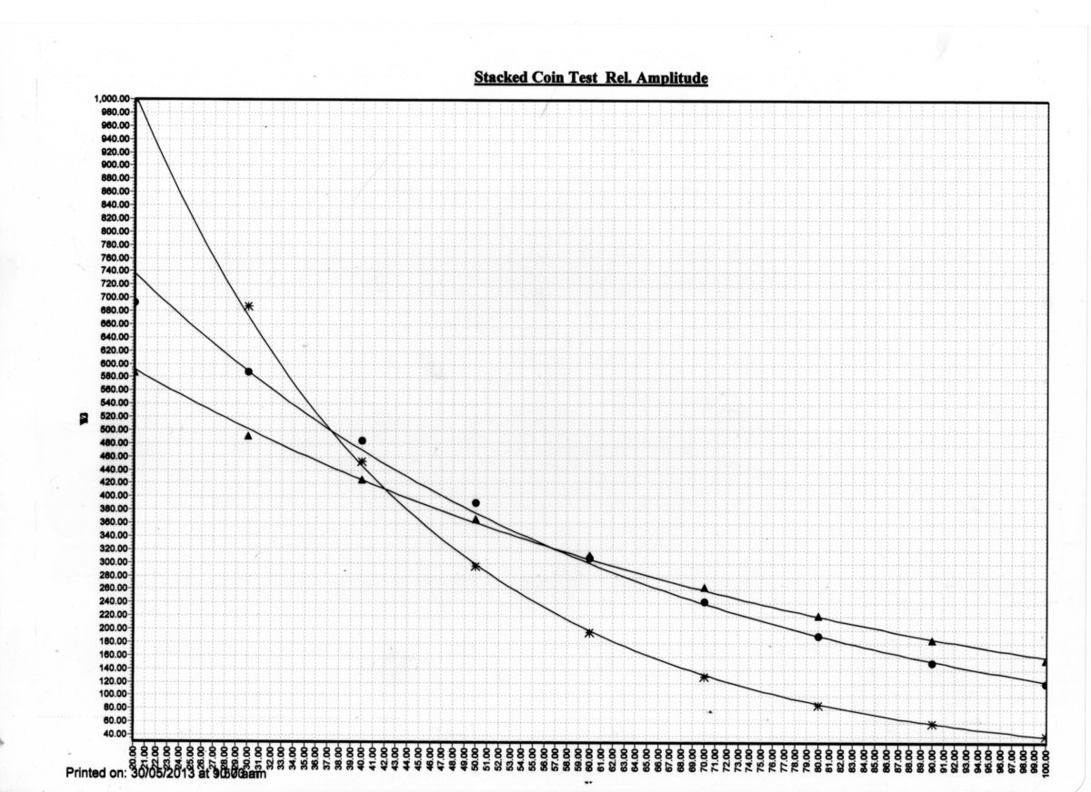

              Hi Allan and Mick,
              Paralleling inductors that are not coupled is like resistors in parallel. However, for coupled inductances it is different and you can end up with a value that is little different to that of a single element. Stacked coins would classify as coupled inductors. I had to Google information on "coupled inductors in parallel" to sort this out as I initially thought the TC would remain the same and I was puzzled that my test results showed otherwise in quite a dramatic way.
              For horizontally space coins, the coin-coin coupling is greatly reduced and there is little change in the TC over one coin. However, the amplitude goes up for each coin added due to the increasing surface area of radiation. All the individual eddy currents will be circulating in the same direction and although there will be "cancellation" at the edges of two adjacent coins the net field is now that of two conductors in parallel. Much like the adjacent turns on your TX coil. If you looked at the field between turns it would be zero due to cancellation, but the external net field increases the more turns you add.
              I just found 6 off 20c Oz coins so I set my measurement at 100uS delay as most of the signal will have gone by then as cu/ni alloy. Any increase in amplitude at that late delay will relate to a TC increase i.e. if the TC for two coins was the same as for one, then the reading should just double. Starting at one coin and then stacking one at a time we get 10, 90, 188, 262, 312, 345.
              Eric.
              • #67
                Star = 1 coin, Circle = 2 coin, Triangle = 3 coin.

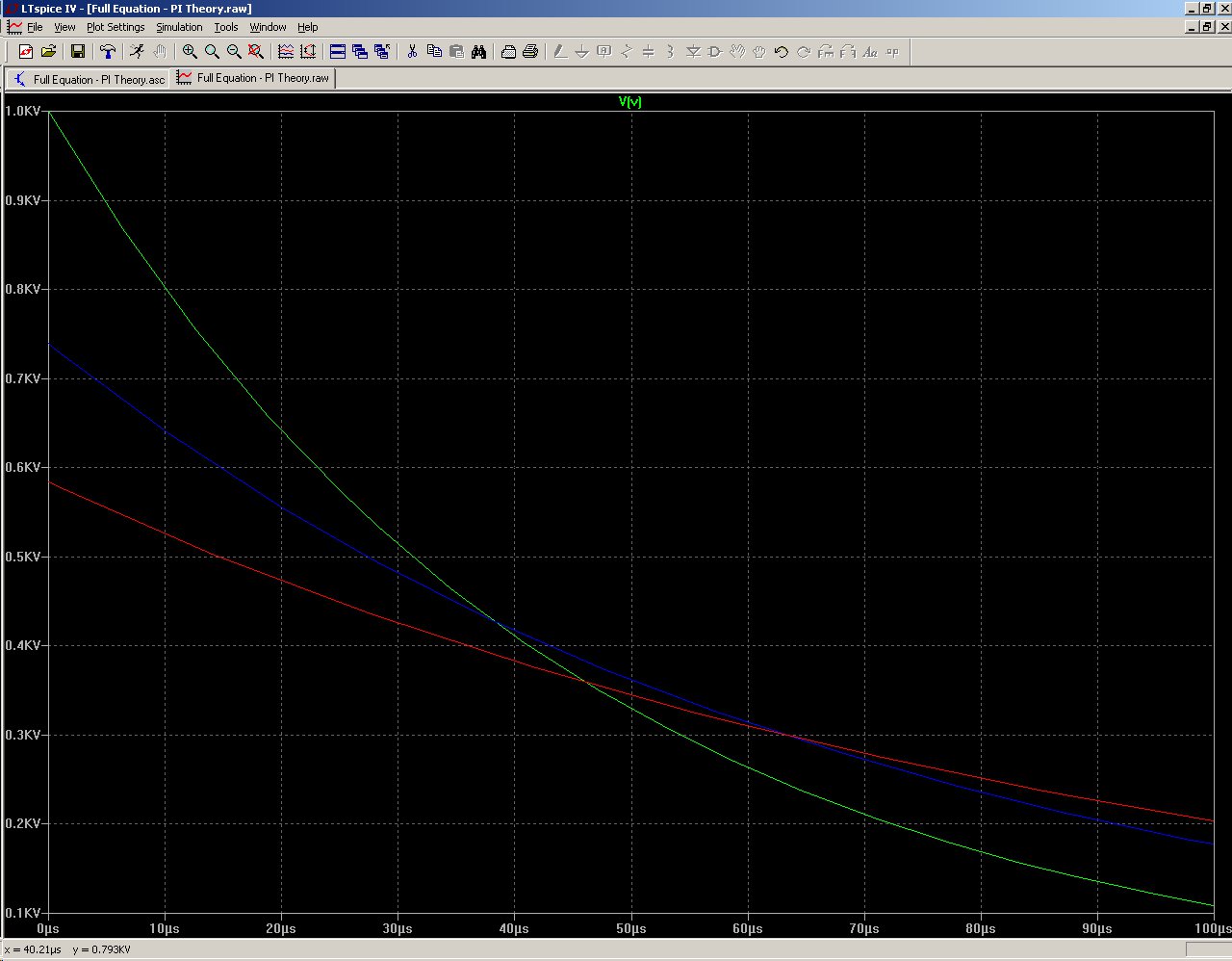

                Here is a further plot for my coins where you see the initial amplitude reduced for the next coin in line, but the enhancement at late times. I am hoping that some brave person will try a Spice simulation - if it is possible.
                Eric.

                Does this look familiar?
