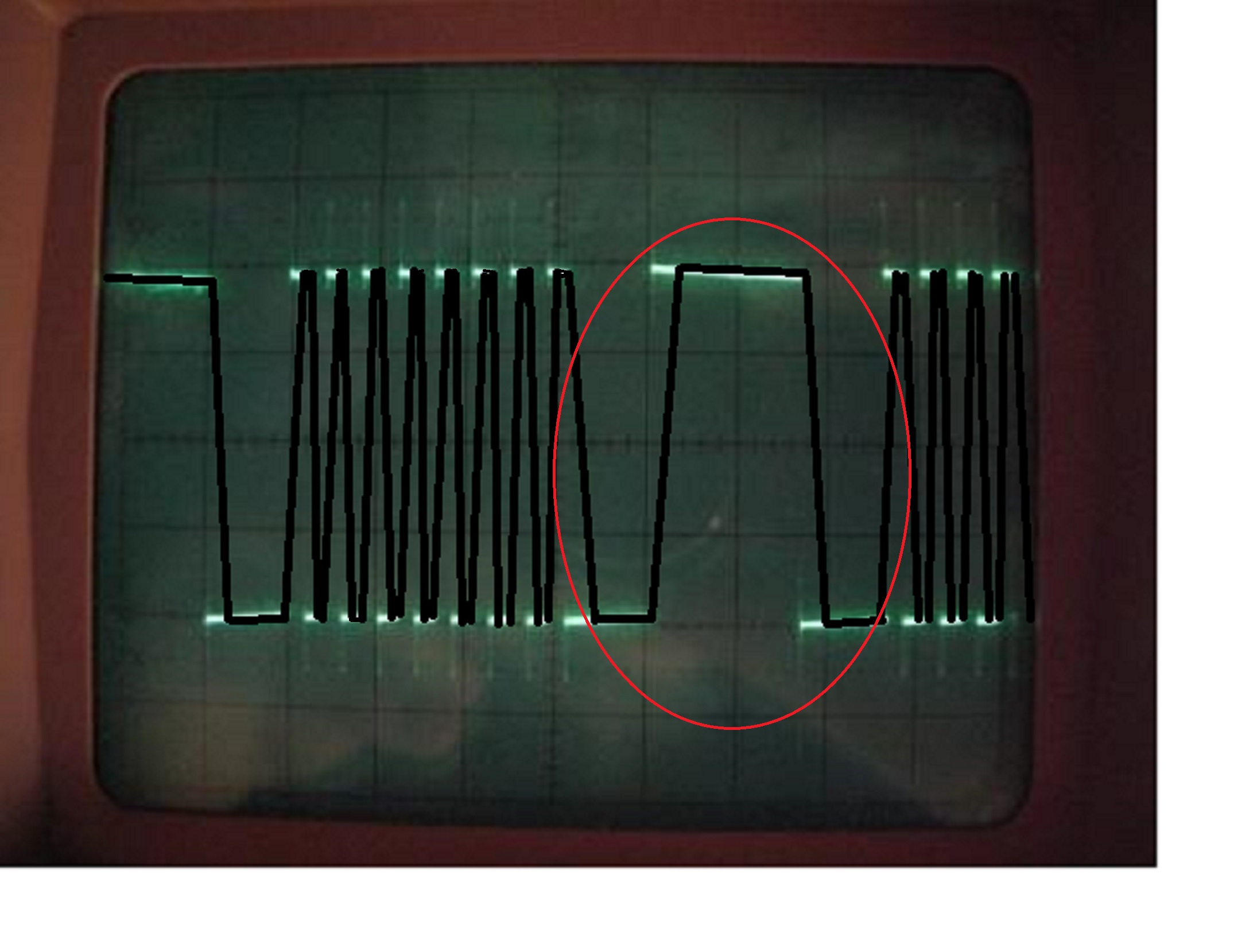

                • #53
                  The basics of the Tx drive look fairly simple on exp2 i.e. fast, not so fast and slow and back.
                  [ATTACH]25324[/ATTACH]
                  S
                  I see. What it looks like they are doing there is issuing a string of 8 pulses and integrating them together to get the equivalent of 1 pulse for a PI type detector.
                  • #54
                    When you look at the TX voltage it doesn't make sense. When you look at the TX current it becomes crystal clear.
                    • #55
                      I'm not sure about 'crystal clear', but it does give an important insight. The fact that the receive coil then differentiates the resulting target response rather complicates matters.

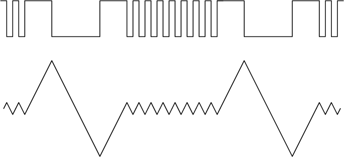

                        The current is something like this then,
                        what is odd and looks like a third frequency is probably a 180 deg phase reversal
                        so freq A for a while then one cycle of freq B then phase flip and one more cycle of freq B

                        • #57
                          Here's the voltage & current:
                              [ATTACH]32502[/ATTACH]
                              That's precisely the way frequencies are seamlessly tailored together. With aperiodic coil and no flim-flam with Tx switching, you get any frequency you wish in a sequence. Sadly, the market leader did the very flim-flam with compensating coil resistance (L/R of a coil) to improve wave shapes, and lost the significant portion of energy conservation ability of a simple design - the way Fisher did before them.
                              A big number of frequencies announced by marketing was backed by the ability to run any combination of frequencies this way. But two frequencies in sequential repetition was all you got. The Candy gospel says you got all those frequencies simultaneously, which is misleading and a fine example of defunct marketing.
                              Anyway, this may start to take shape. Discrimination-wise this is a bit more interesting, but solvable even in analogue solution.
