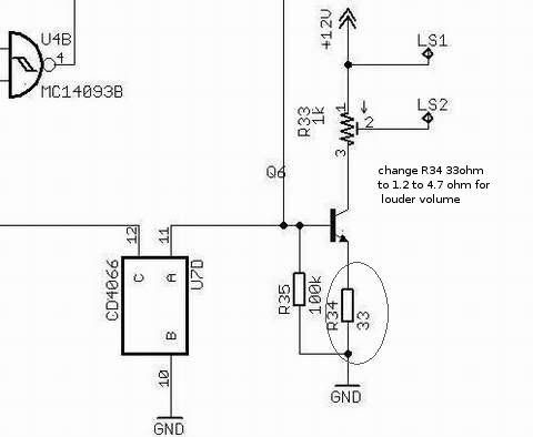

            Not sure if your problem is related to resistor R34?
              tryed the resistor no joy no sound unless i get coil near hed phone leads ?
