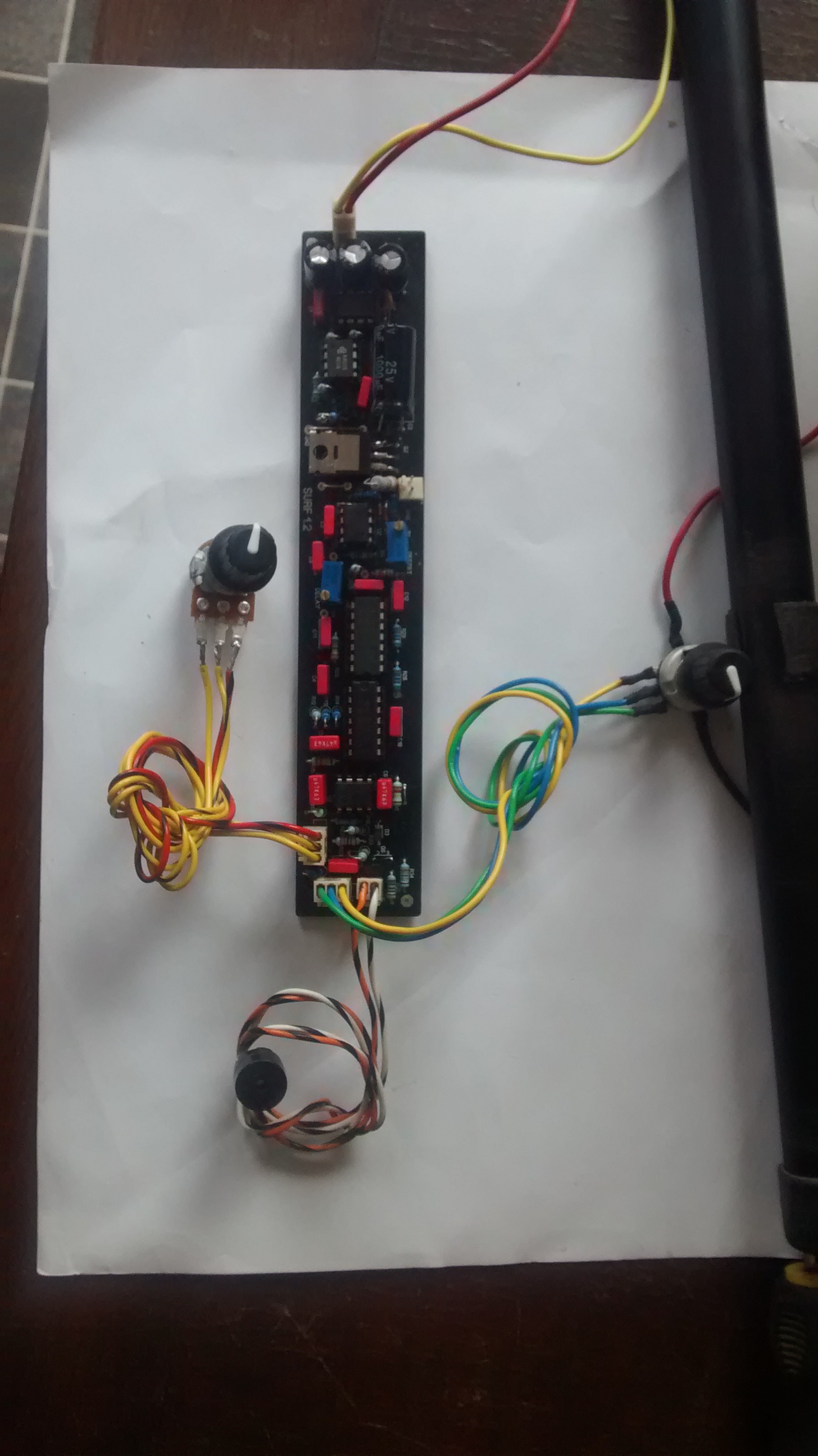

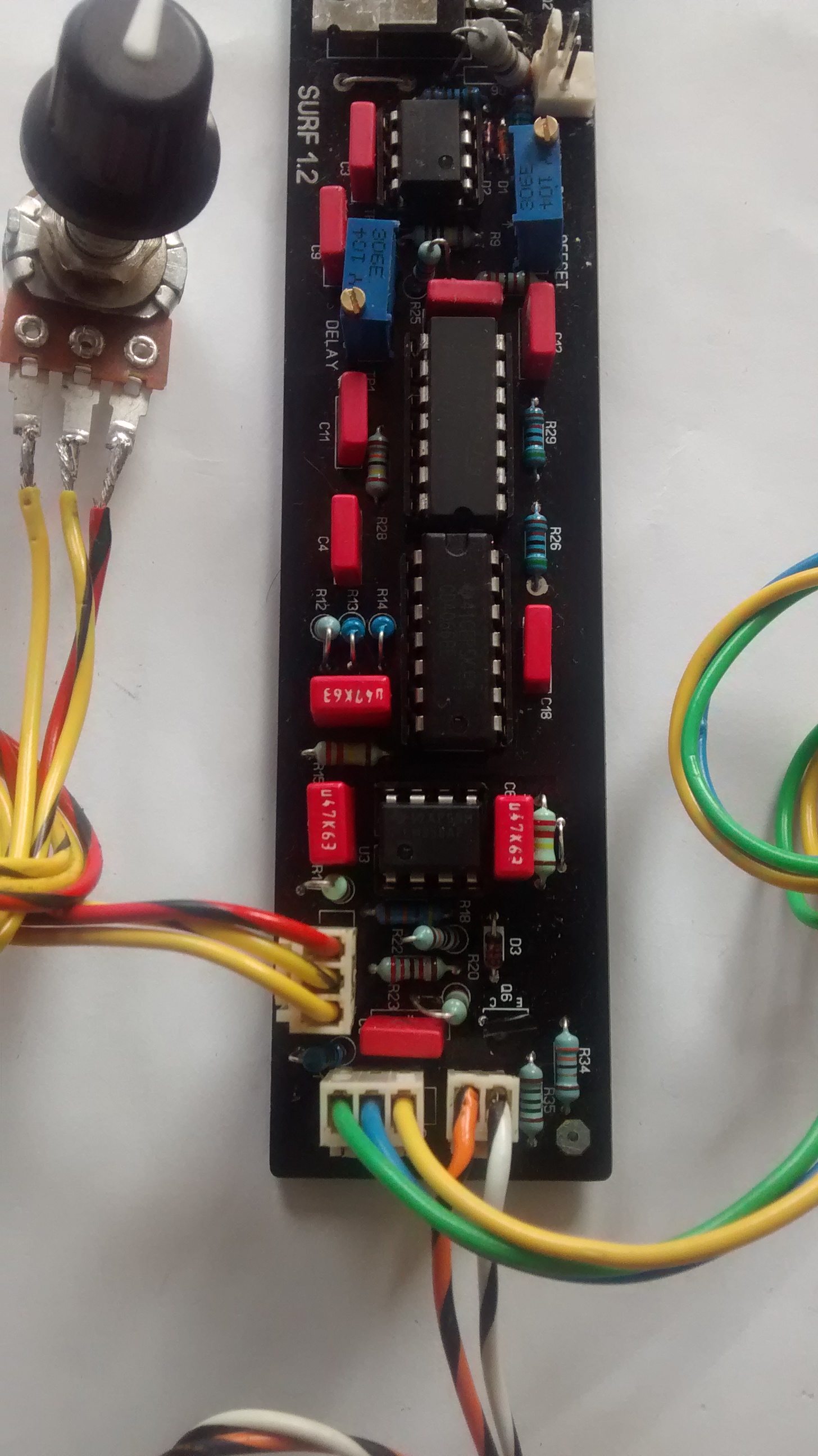

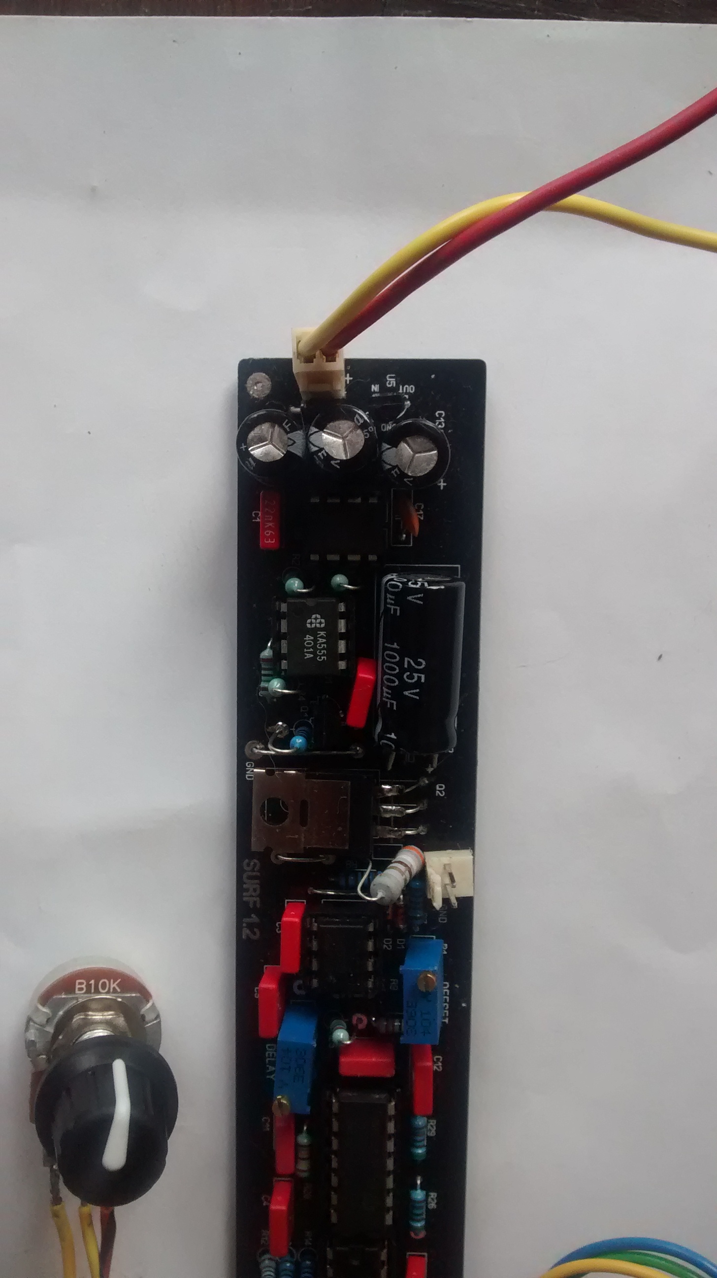

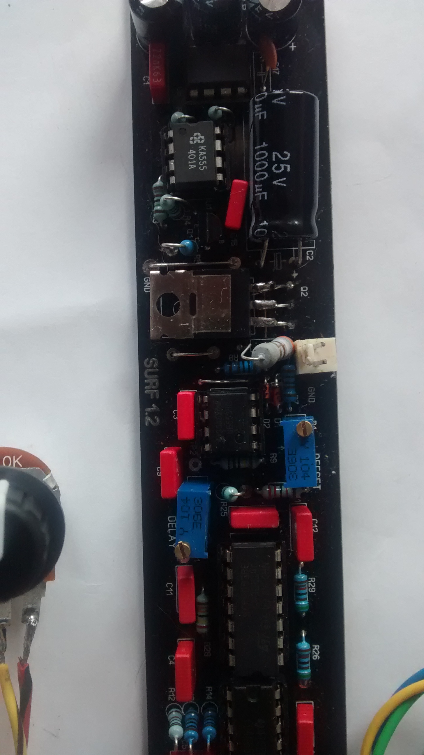

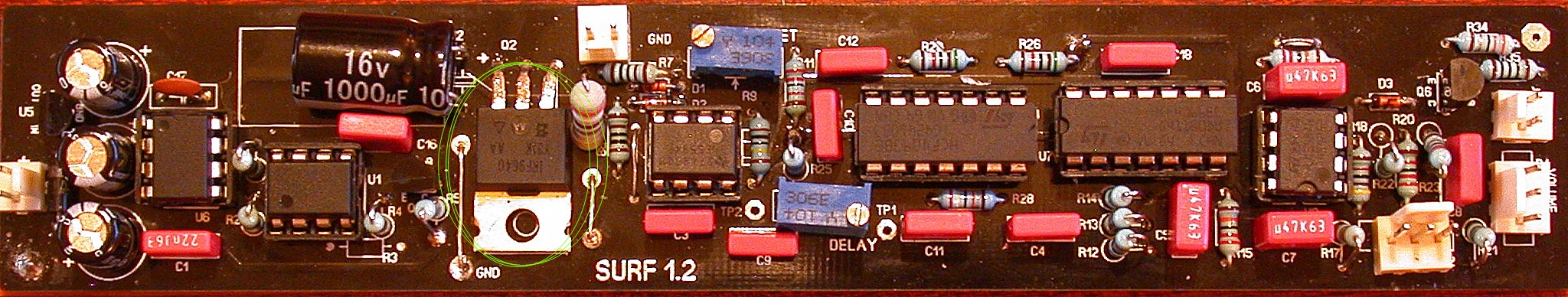

As requested by some guys here I have taken some pics, can anyone spot anything i have cocked up so badly IE that i cant see it
pic's 1.2 3& 4 board

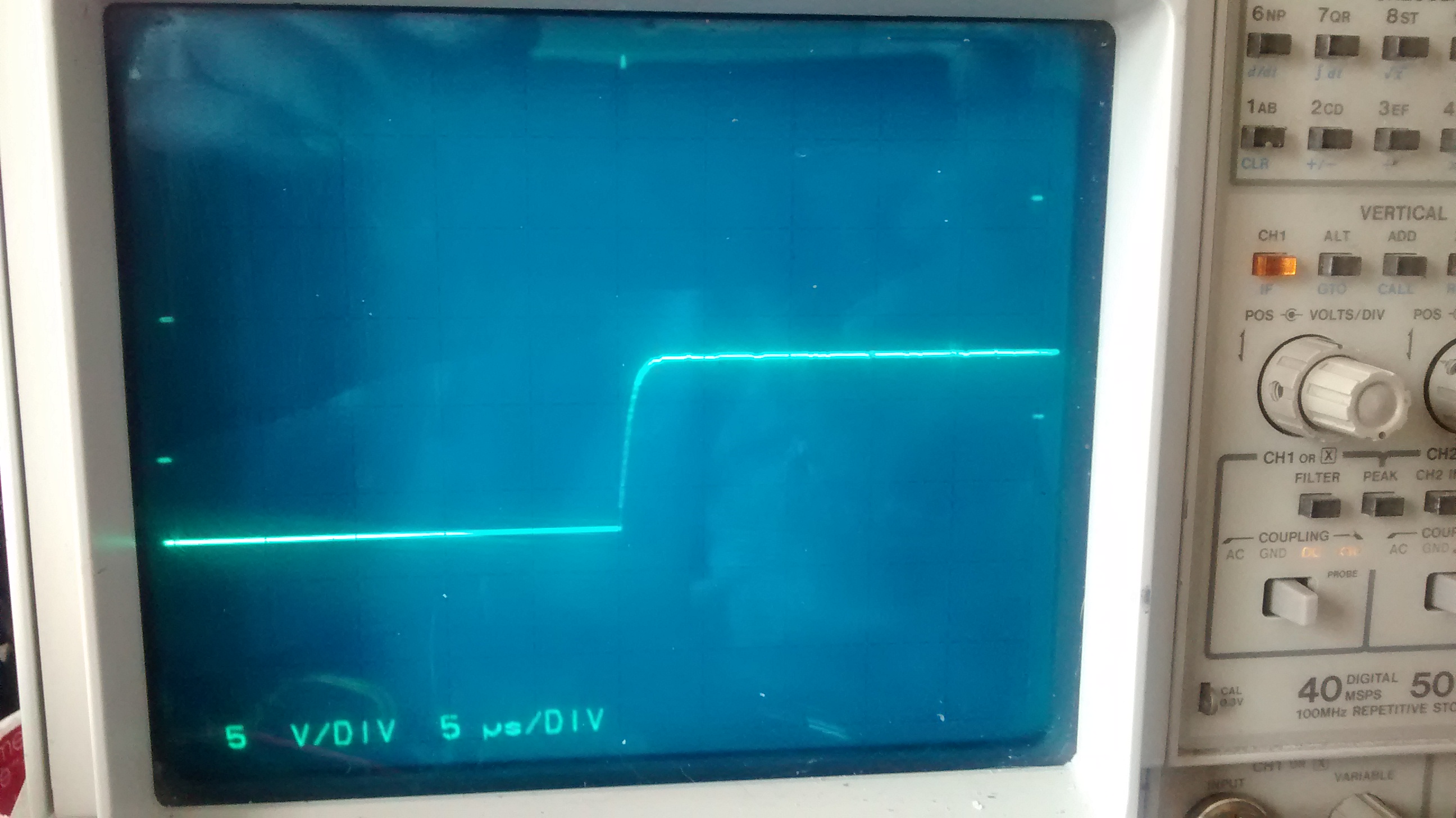

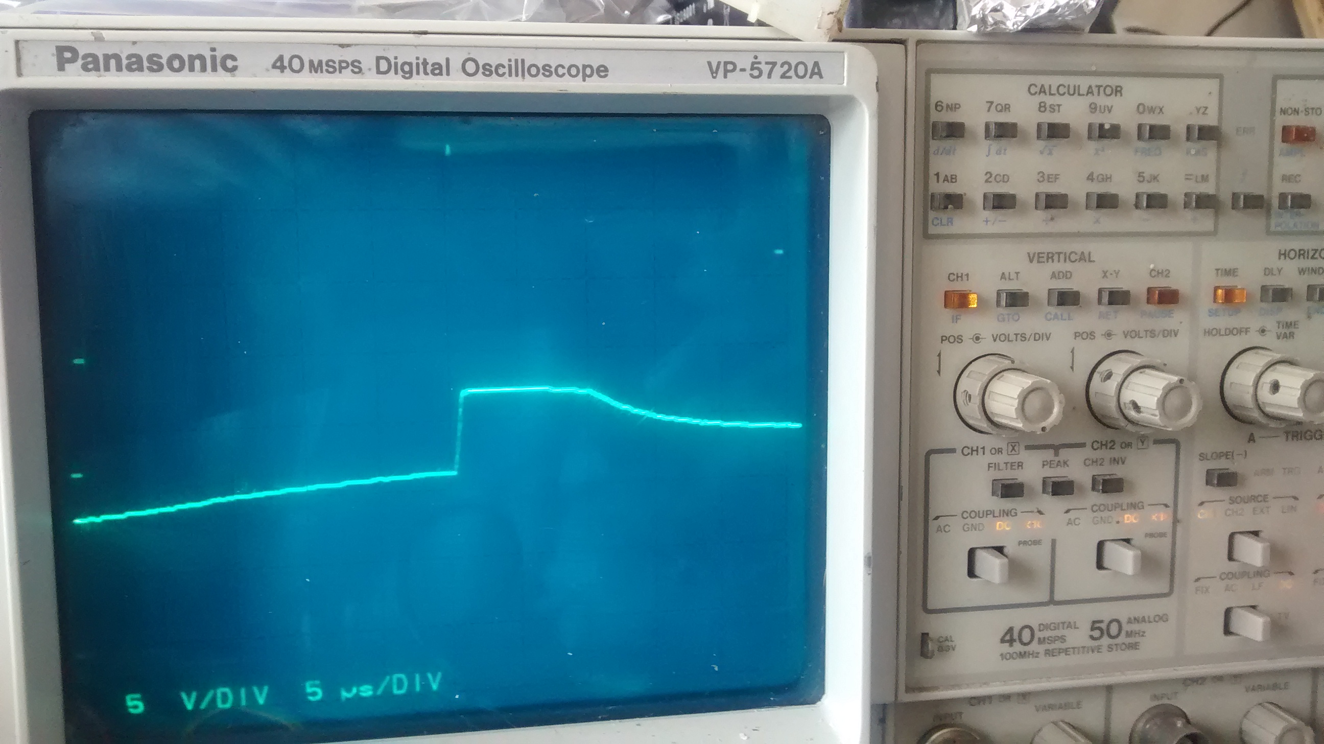

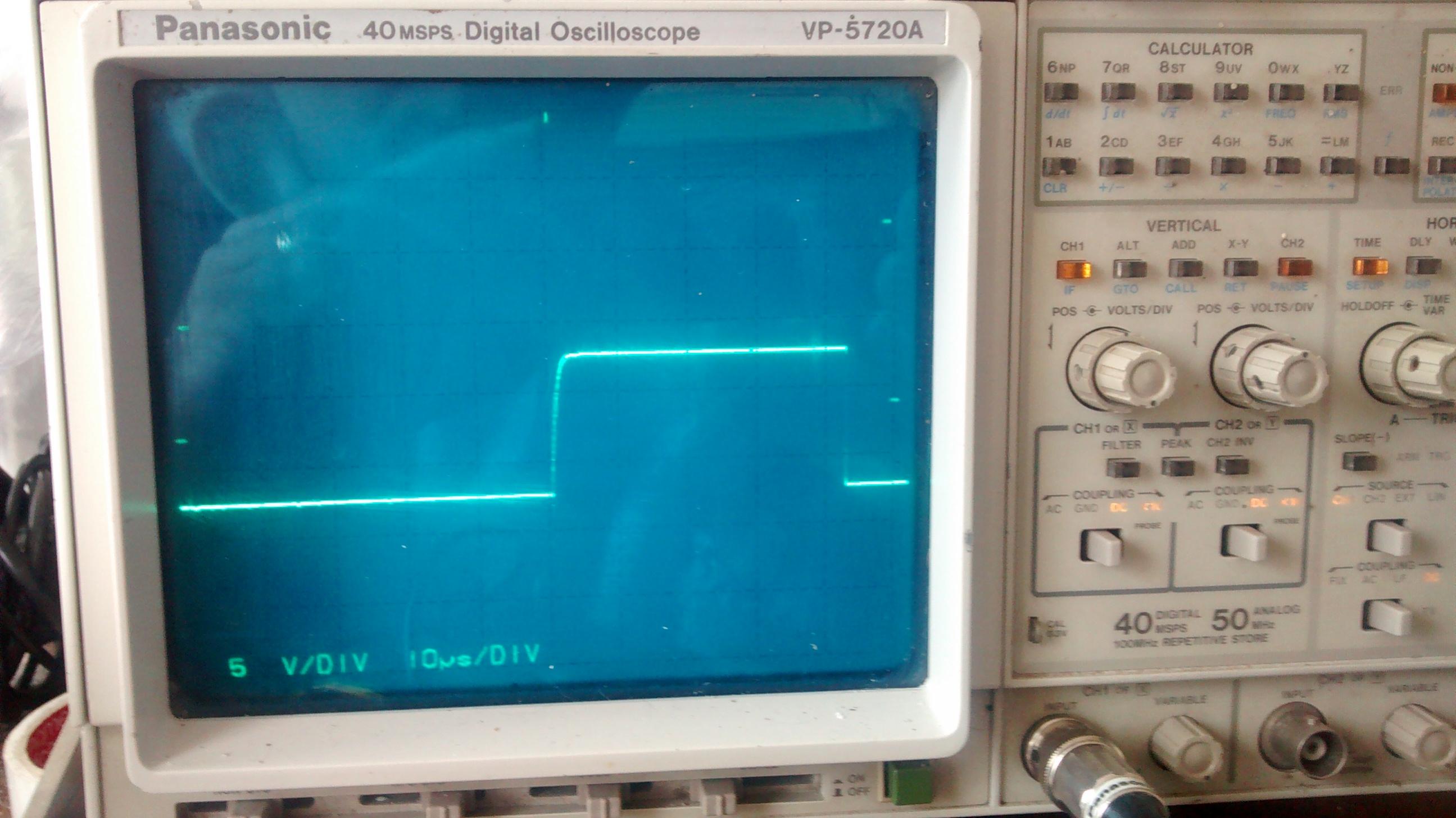

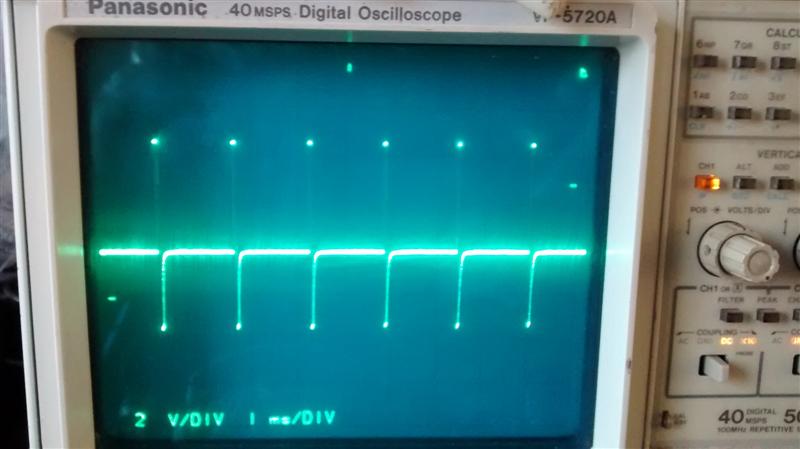

pics 5 & 6 scope signals from TP1
pics 7& 8 scope signals from TP2Attached Files- IMG_20140620_112752858.jpg (811.2 KB, 59 views)

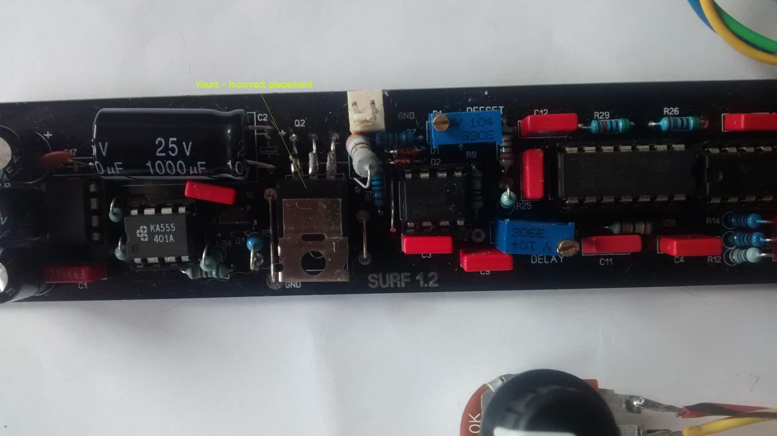

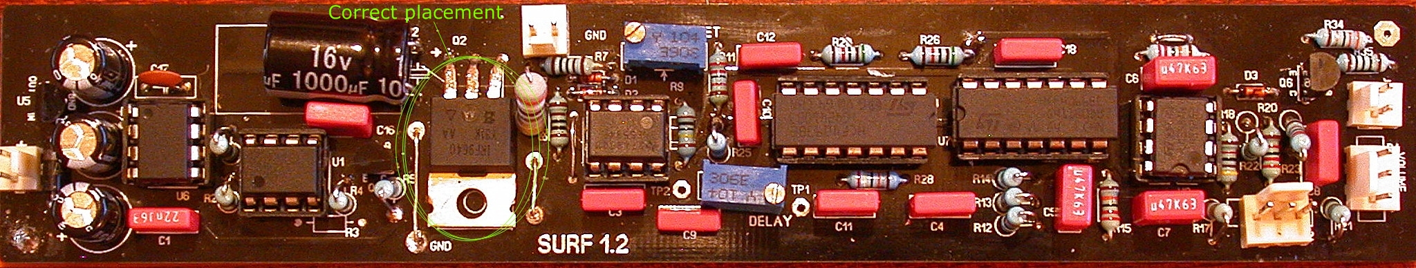

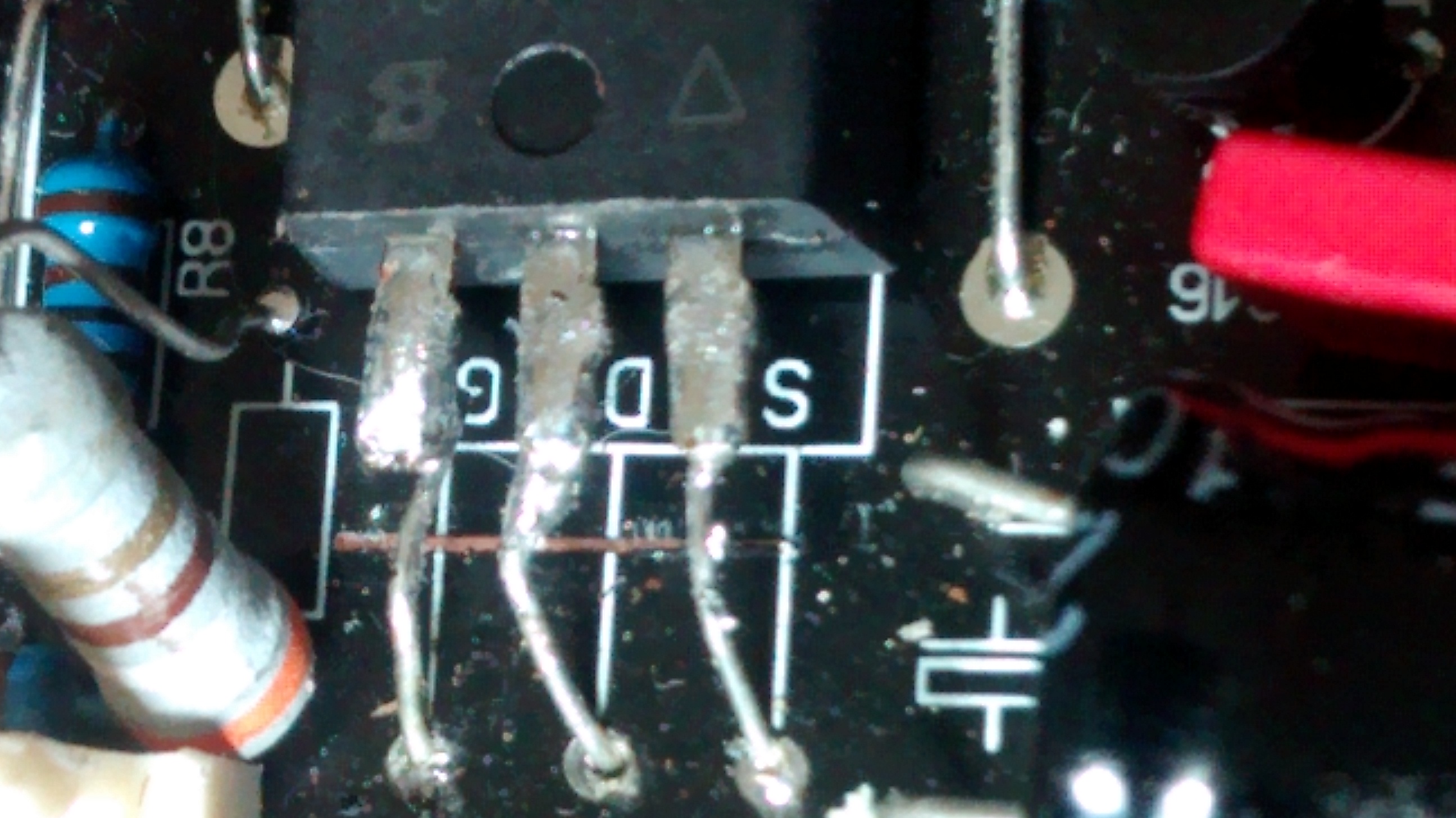

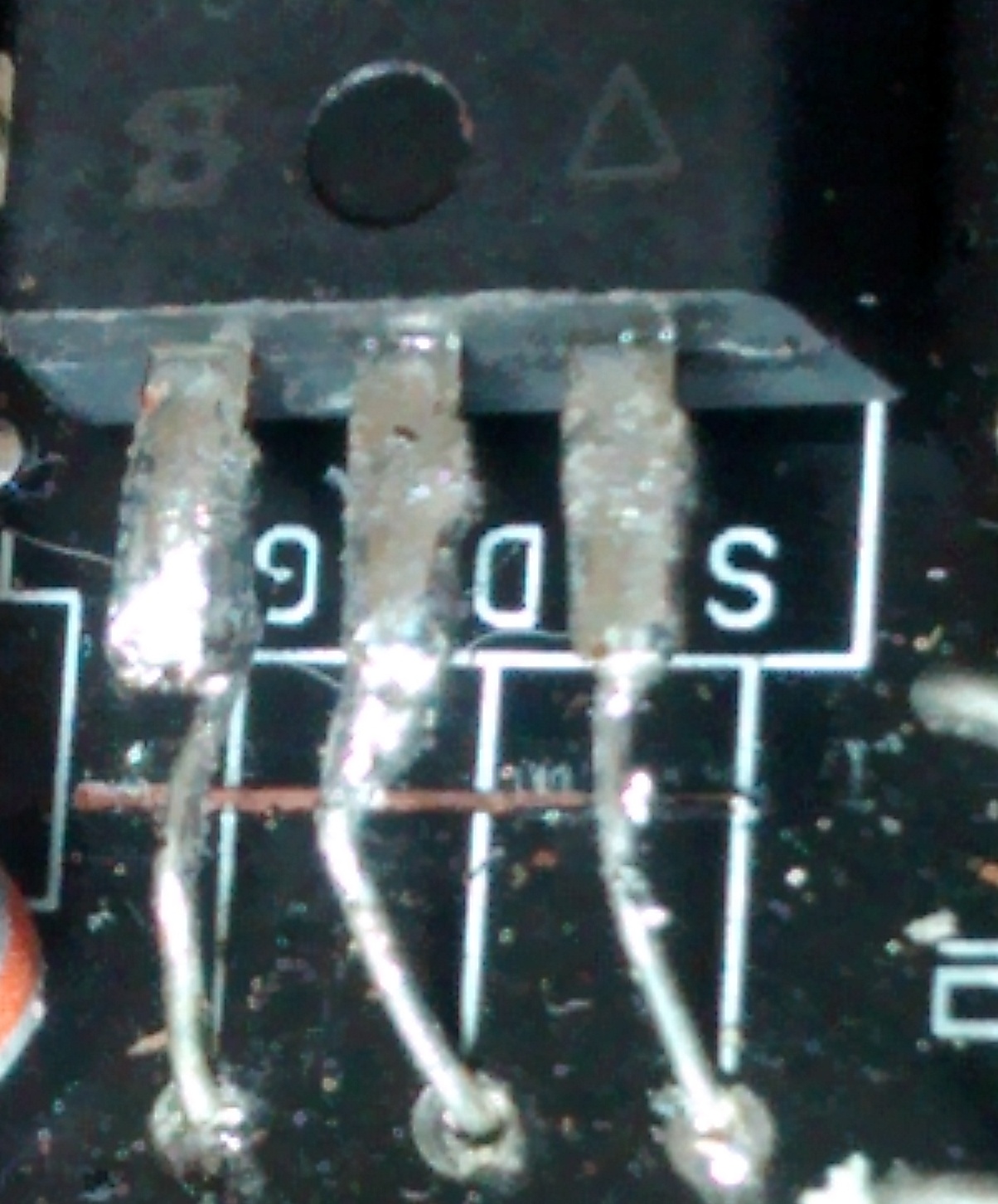

here is a photo. still not certain if it is the right way round though? also seem to have the very simillar voltage on the S & G Pins is this normal ?Attached Files
Just make sure it has the writing facing up with the drain sink laying against the board like in this image.

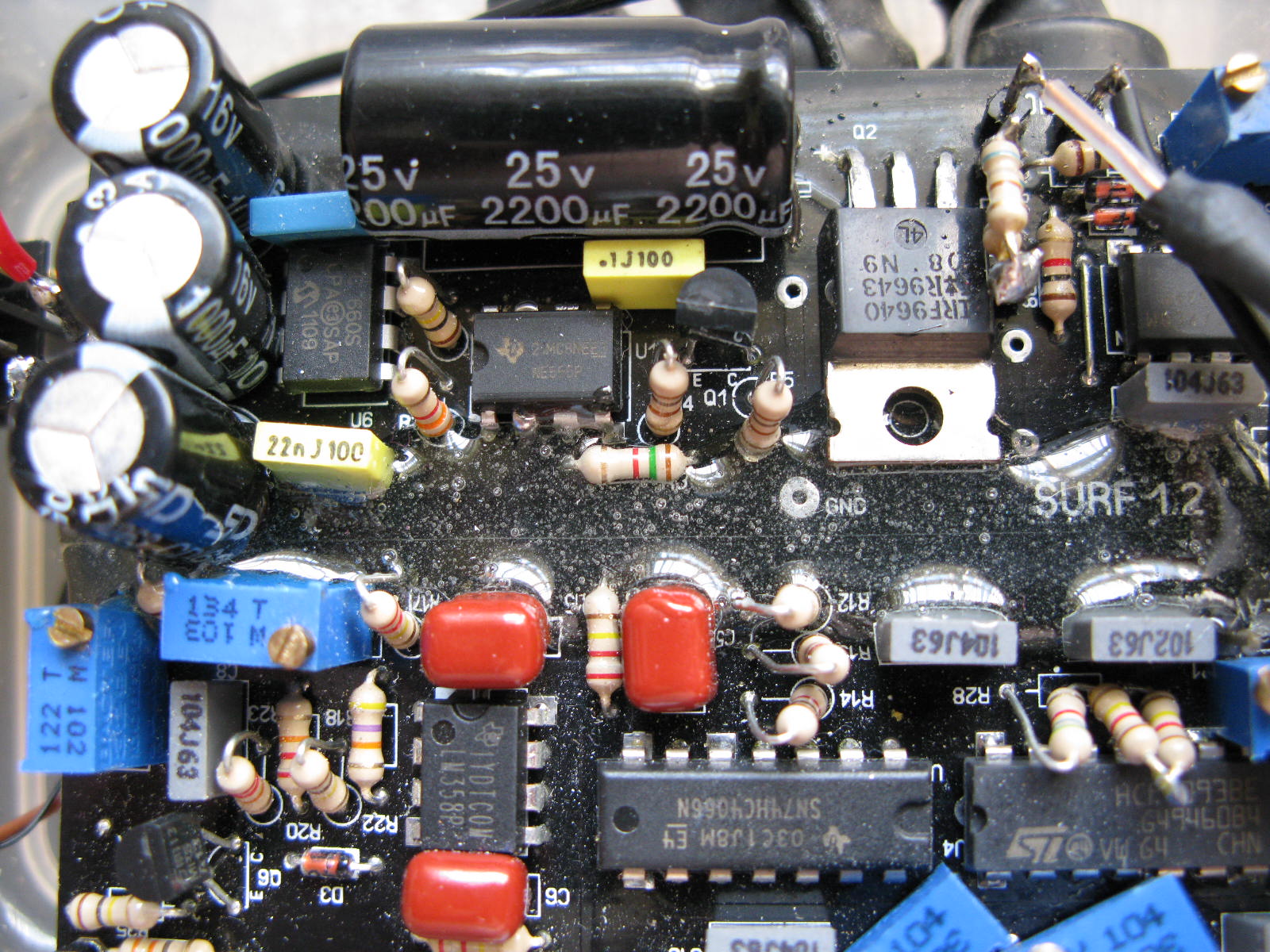

Check Q6 and R34 along with your solder joints over the whole board. I believe R34/Q6 controls your audio so make sure R34 value is correct and
then check the transistor, if I remember correctly it should be the MPSA13.

here is the fet cropped.but for some reason it keeps blowing it up to fill the page you can see the pins marked s 0 And A triangle on the fet but on the silk screen it seems to suggest it should be the other way around.
The "S" you're showing appears to be the Siliconix logo and should not be confused with a source pin designation.

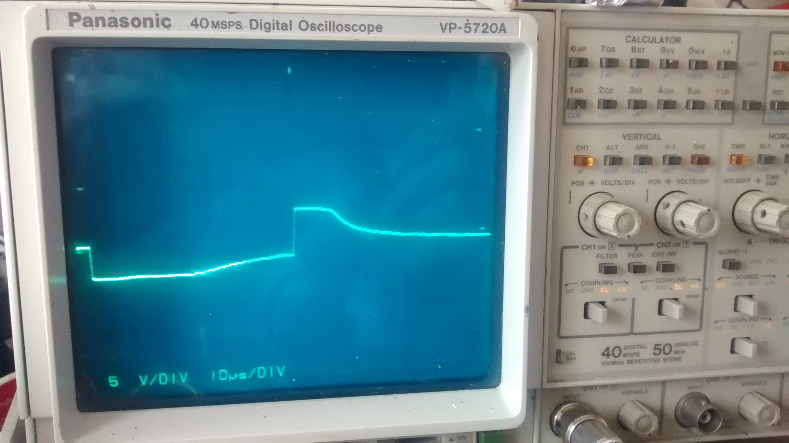

thanks guys another step nearer it looks as though we have some kind of life attached pic is on the scope from TP1. I have had the tester on the MPS A13 and have 12.46 on the collector 0 volts on the base and the emitter am i correct in guessing that this is not right and the transistor is Kaput defunct let out the magic smoke.
pic quality is also better used image re-sizer to make it fit better please let me know what you think thanks again for all of your help,Steve.Attached Files
