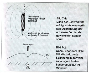

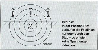

                First and foremost, a wave consists of two components, E and H. They are mutually orthogonal. Separate wave components may be detected by short (<< lambda) electric or magnetic "dipoles". A short magnetic dipole is a ferrite rod, or a small loop. To make it completely separated from E field it must be well shielded, or working in a balanced mode. Friese chosen balanced mode (FKK approach ). Over an unobstructed homogeneous terrain, a ferrite antenna would have a minimum for detection of near surface (ground) wave when pointed vertically. Any conductive object, or void, shall act as a wave scattering point, and thus perform as a new field source of minute amplitude. Because it is close by, it will ruin the minimum reception as you approach to the buried object, yet right on top of it the minimum reception conditions will happen again, hence a sharp notch. That's the reason these detectors are designed as hanging contraptions to maintain vertical orientation, very similar to certain magnetometers.
Name:	Bild 7-1 7-2.jpg

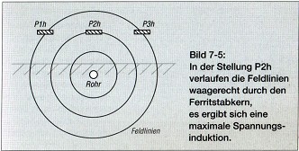

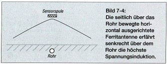

                The other option is a gradiometer configuration, where difference between two sensors indicate a buried object (or void). There is no notch on top of the object, but pairing two sensors, and observing their difference will create it.
                I'm struggling with my German so I still have no idea what is meant by "sensitive selective cable search" other than "lost in translation". There is a method of actively exciting the cable at it's end, so perhaps it is the "selective" part. I'm not sure. Anyway, this is a very legitimate method, and if any device classified as LRL follows this path, it is classified wrong. Any abrupt change in soil permeability, permittivity, or conductivity can serve as a scattering point, so if someone calls it "anomaly" does not automatically mean the device sensing it is a LRL.
                  There is nothing LRL related in this book. Only hard facts, and working principles. If by any chance some device was condemned as LRL, but working on this principle, it was unjustly classified.

                                by the way the completly vertically coil position of such detectors may not lead to good detection results if the wave was diffracted as it happens
                                with FM (UKW) at regions with mountains - and this applies not just for ultra-short waves.
                                Some years ago I found a sketch with the best ferrite coil position for best AM radio reception gain - no idea where it is now.
                                here is some info: http://de.wikipedia.org/wiki/Ferritantenne
                                If the end shows to the transmitter (horizontal ferrite showing to the radio-transmitter antenna) the signal is minimal.
                                But if the ferrite-antennas position is 90° to the sender and 90° to the polarization, it is maximum.
                                This means that such a long-wave anomaly (distortion) detector with vertical hanging ferrite antenna only works correct
                                for long wave stations that uses a horizontal antenna (which is common because of the huge wavelenght).
                                AM-radio stations (MW) often use vertical antennas thats why the radio-receiver all have horizontal positioned ferrite antennas.
                                But if the longwaves have no problems with huge angle diffractions and the transmitting antenna is horizontal
                                and the land is flat without hills or mountains it should work with vertical ferrite-antenna.
                                So good luck and keep us informed about your radio-metal-detector experiments!

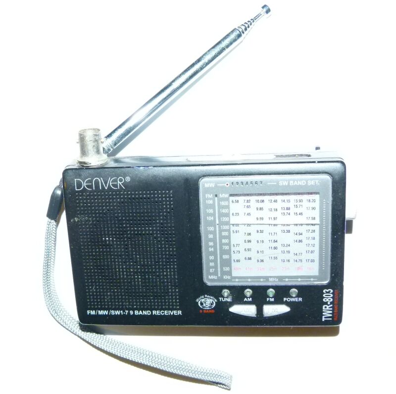

                                PS - for technical inspiration - below one of my BNC-jack-moded world-receivers so its usable with RG-58 or thicker coax cables
                                which are attached to roof- and other large or amp'd antennas incl. grounded shielding.
