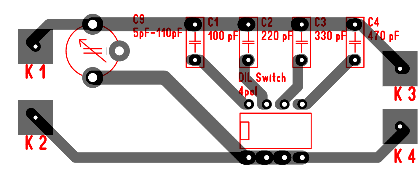

                  ok here is first part of the 77,5 khz passive locator
                    @ bernte_One
                    The PCB lauyout looks real good.

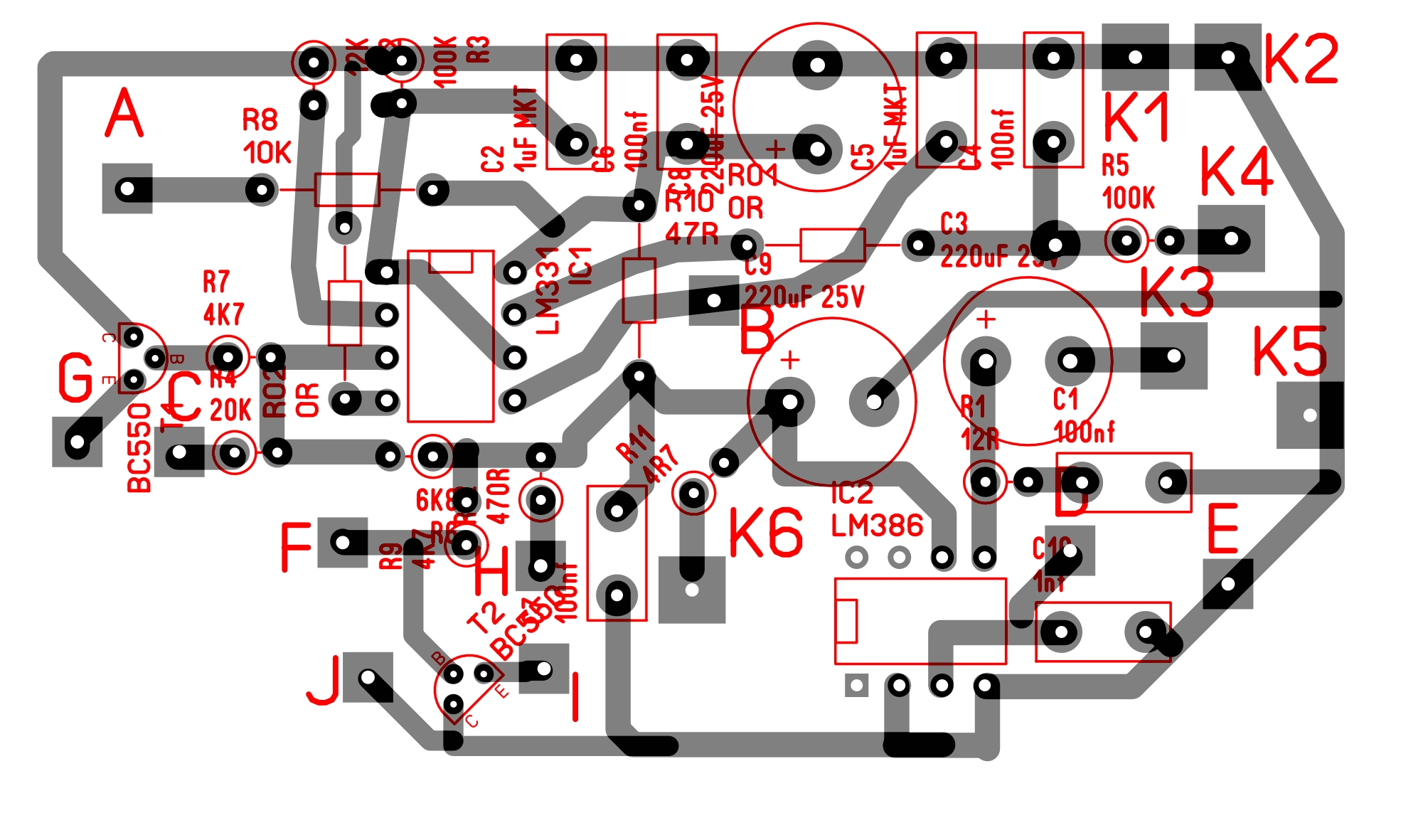

                        next part
                        tone and optical exit part
                        p.s. thats my second design with sprint layout 6 i´m totally a noob in this case
