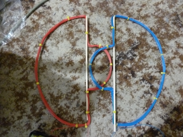

        Finally got around to testing the WM6-Davor-ATX dd coil for IB.
        It takes a surprisingly very small amount of over lap to make these coils IB.
        see attachment.
        I can only assume that the original ATX DD is not a true IB coil,
        to get the coils into the shape of the atx dd would have a huge amount
        of over lap and be be very out of balance, any comments ?
        • #49
          ATX is a PI machine and it does not require a true IB. However, with a little tweaking of inner loop radius a perfect balance should be achieved with a more agreeable shape. The critical thing is mutual proximity of the straight sections, as they provide anti-balance. So with straight sections further apart you need less overlap. I believe this arrangement has 2 minima, and more interesting is the one with straight sections separated by a few mm.
