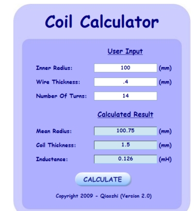

    my coil is 20cm ,0.4,14 laps is it ok ??

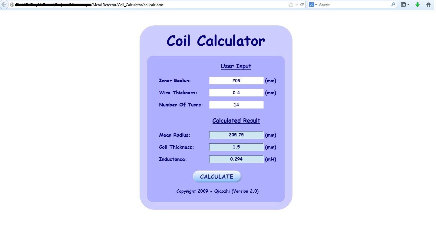

              If I understand you correctly you say your coil is
              That calculates to only about 126 uH, you need more turns something like 20-21.
                oh noo what a miss :\
                its said inner radius i thought it inner diameter what a mistake
                sorry my fault
                  i made new coil with diameter 20cm ,0.4 , 22 lap and it made a little progress

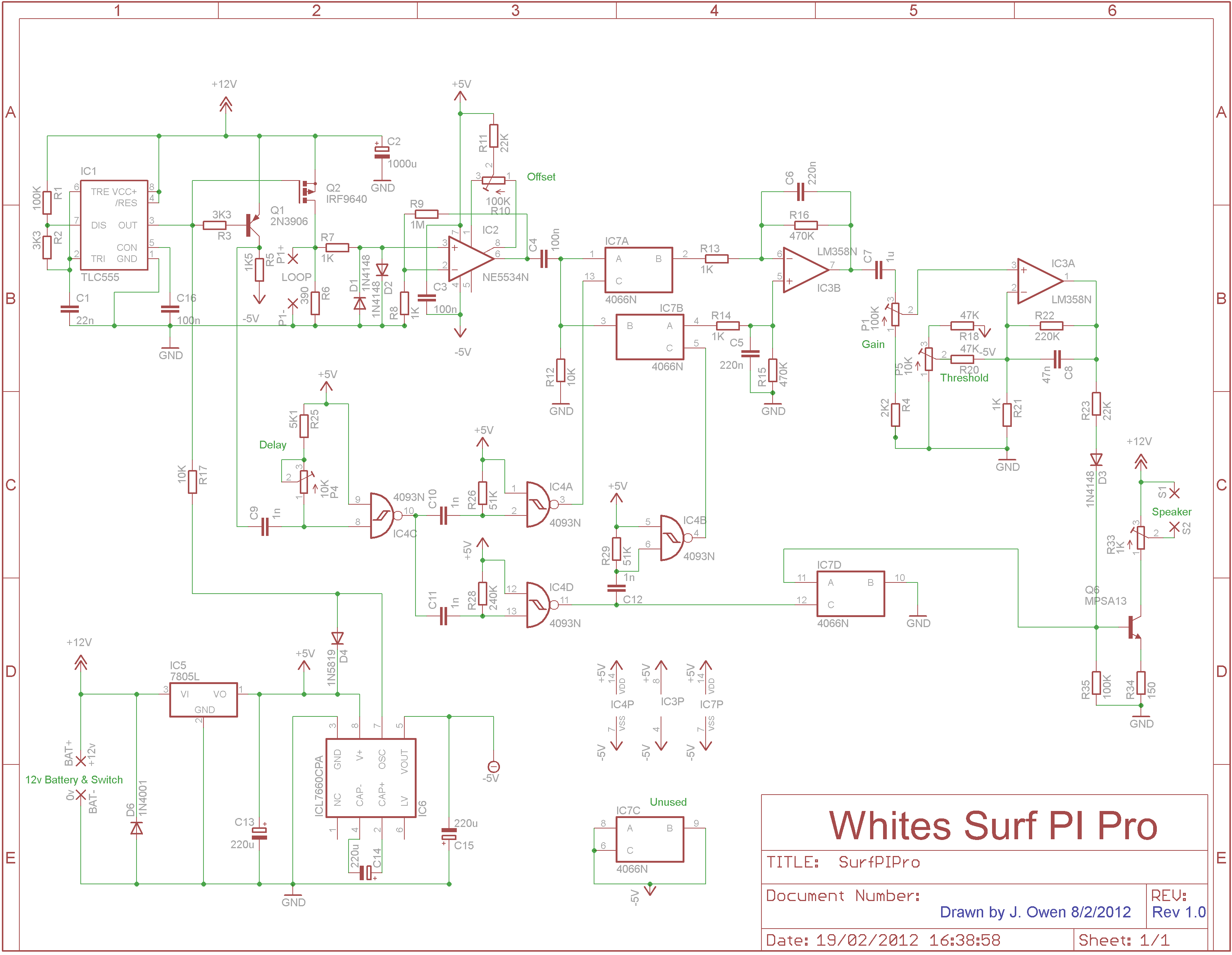

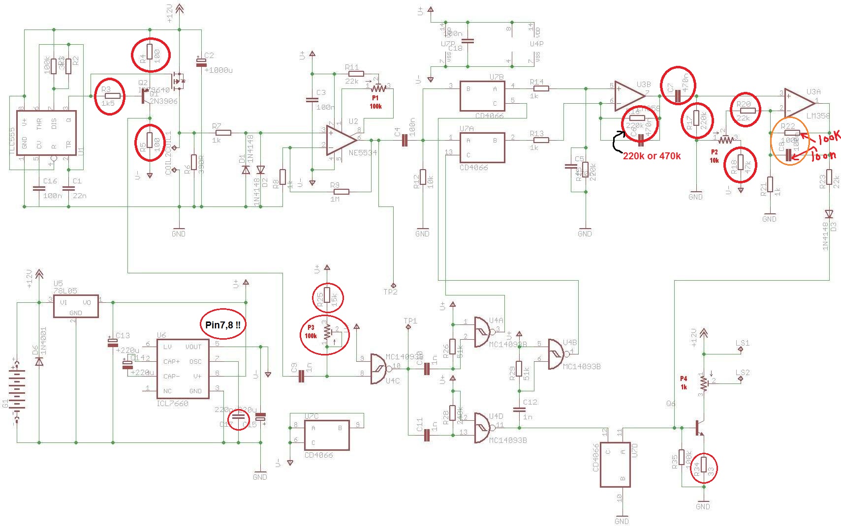

                        hi all iam advised to update my Surf pi Pro
                        from this one
                        to this one
                        i marked the differences with red circles
                        so what is your opinion ??
                        for more information about my Surf pi MD its working good all ic`s are OK but it only detect very short range it can detect medium object at 8 cm max so i need your help please
