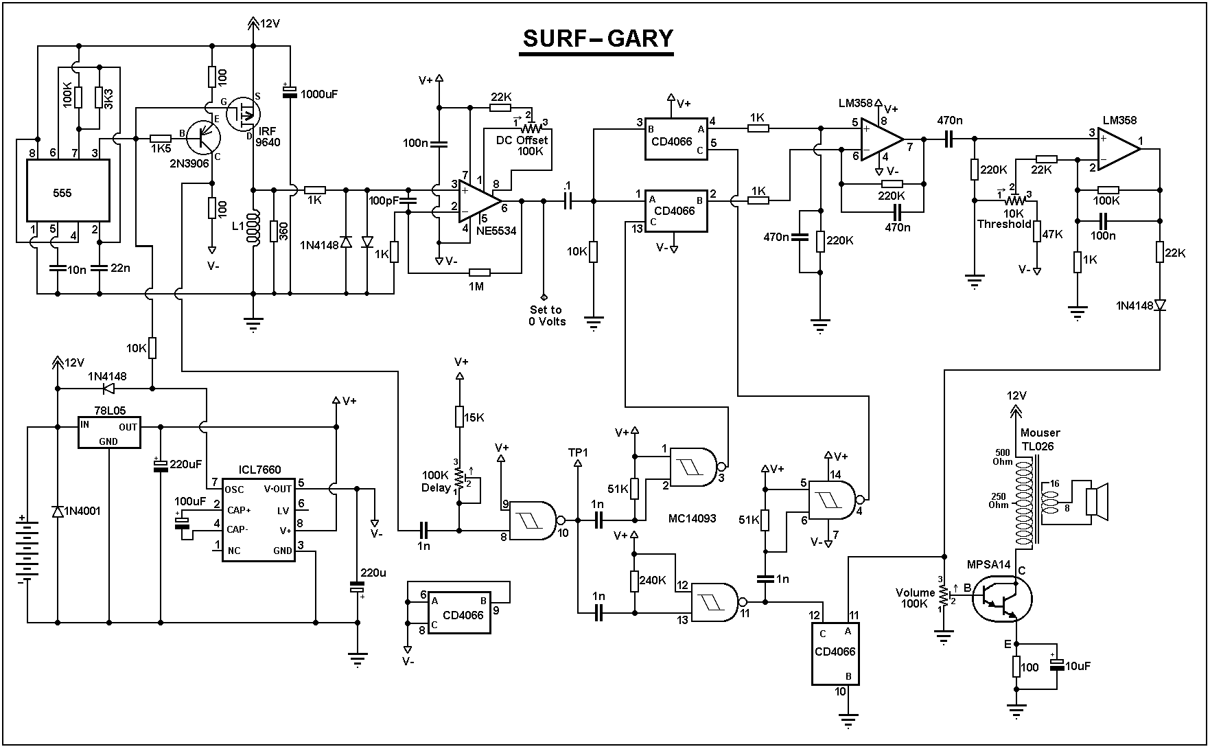

    • #62
      On the Schematic, I just Corrected the Manufactures Name for the Audio Transformer.

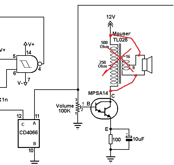

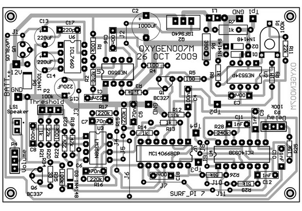

        Hi Gary
        could you just post the component placement pcb to help us putting the component in its right place
        one more thing could you post your pcb with .LAY file
        last question can i put the speaker probs direct to the PCB without using the transformer ?
        i mean like this
        thanks in advance
        Mohamed Ghitas
        • #64
          Hi Mohamad, If you are Not going to Build it EXACTIALLY AS SHOWN, Than DON'T Build it.
          You can't just Modify things the way you want and still expect the Same Results.
          Take care......Gary.
          • #65
            I've checked the transformer because TL026 calls for a TI amplifier, and it turns out to be 42TL026 by Xicon.
            IMHO such transformers could be excelent for improving input noise, yet I did not try it in a lab yet.
              Okay
              but as i understood you are using this transformer for the speakers
              in fact iam going to remove the speakers and replace it with led
              because iam using this detector in making a robot that could discover metals underground and i just need signal i don't need sound
              if it possible to replace it with led ok please tell m how
              if not iam so sad to not trying this perfect detector

                • #68
                  Originally posted by Mohamed Ghitas View Post
                  Okay
                  LED?
                  Than Why did you put the Speaker in place of the Transformer?

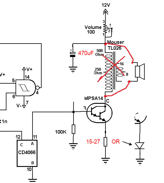

                  • #69
                    try without the transformer. it is not so batt power economely, but you have volume control too and no noised.

                      any way i made another one but it also didnt work
                      iam supplying my circuit with computer power supply and when i plug power the MD gives discontinues
                      this discontinuous beeb stops when i touch the power supply metal body and the circuit works fine
                      but with very low sensitivity so i gues the problem goes with GND connections
                      i fixed it many times and its absolute correct
                      any idea ??

                        The Transformer is only Required for a Speaker.
                        A Speaker is Low Impedance, so Yes it will NOT beBatt Power Economy
                        If Connecting this to a Microprocessor, I Doubt you even Need the MPSA13 transistor.
                        Remove that transistor and take off your signal at the Transistors Base connection to your microprocessor.
                        But I also have some doubts that Either of these signals are good for a Microprocessor.
                        You Might need to convert it into a Digital Logic.
                        • #72
                          You are right so i was intending to seek the source of signal before MPSA13
                          and for turning it into logic iam intending in using op/amp as comparator and take the output signal to the micro direct
                          thanks
