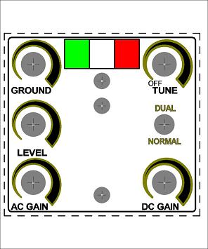

      Such graphic can you draw by using simple and widelly awailable tools as MS Paint:
      At back side put duble-sided adhesive tape, and front protect by transparent adhesive foil
      and you have self-adhesive "plastic-laminated" control front end for your apparatus.

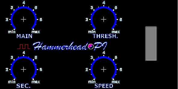

          You do not need special or sophisticated tools.
          [ATTACH]26573[/ATTACH]
          yes thats what im looking for as on your volume control and also i want 1-10 volume scale.

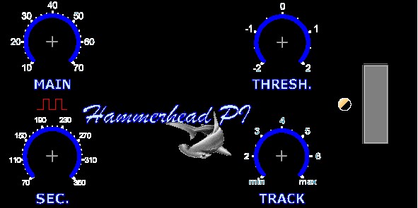

                    frontdesigner

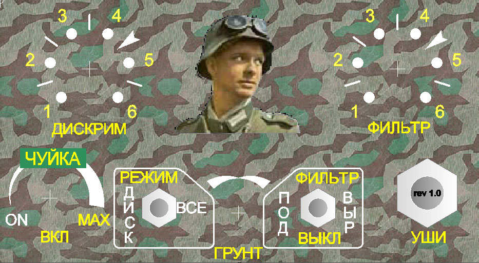

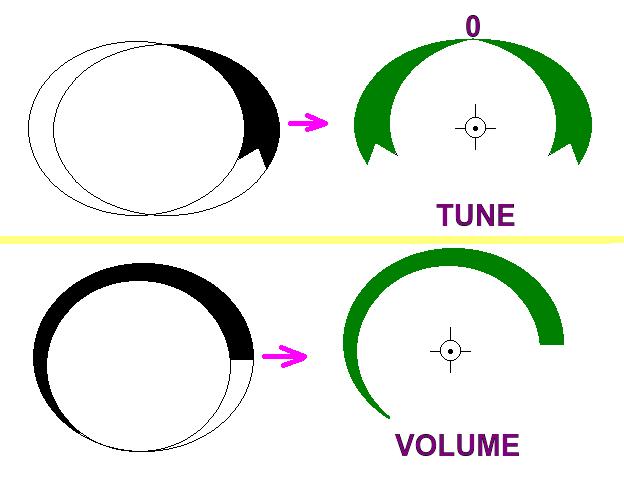

                      To draw circle with MS Paint in different divisions, you can use circle division template from this site:
                      http://www.enchantedlearning.com/gra...zers/piechart/
                      So you can draw your own front elements like this:
                      and using your elements create in MS Paint your own Front design:
                        i like your layout...thats what im looking for and does the $5 dvd have all this on it so i can print my own decal ?????
                          Finish (again):

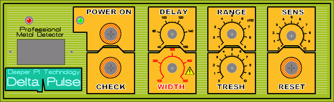

                              Dave, mine version of Radiofactory is Russian translated... I do not know where keeping English version you could take if you need I will share some my FPL files for the soft I made and you will be able to begin make own decal... Radiofactory is simplest soft to use IMO.
ID:	337894Click image for larger version
