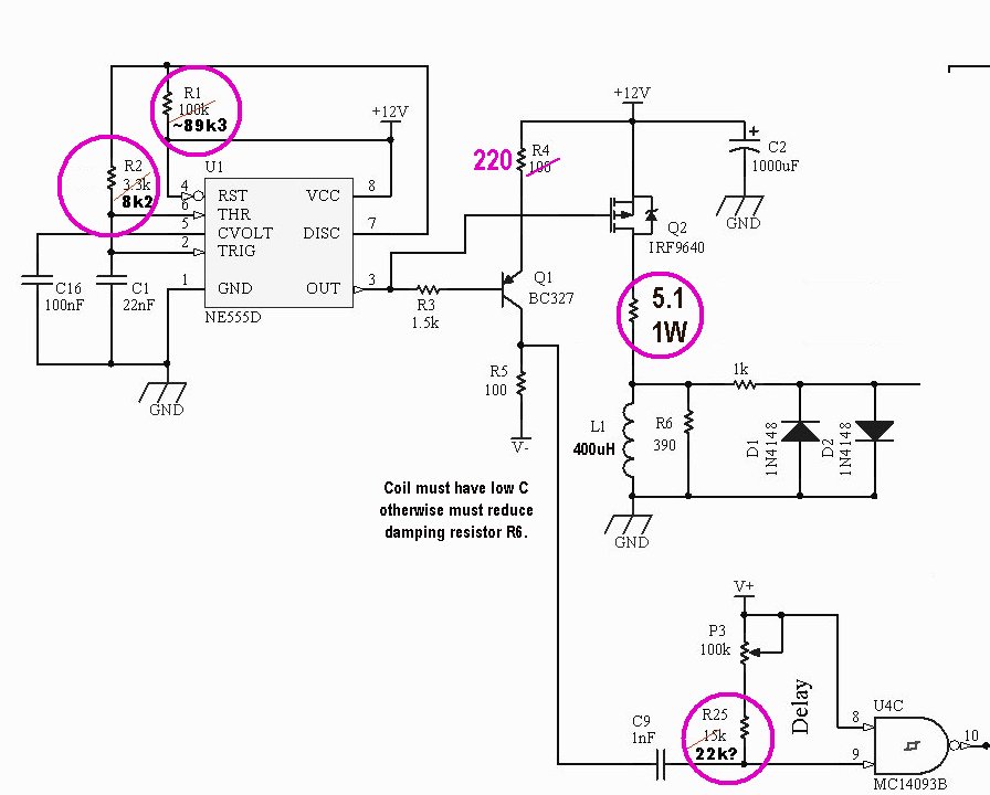

    The original Surfmaster used a trimpot on the PCB to set the minimum sample delay time.
    If your primary sample is colliding with the trailing edge of flyback, you may need to increase the value of the fixed resistor in the primary sample timing circuit.
    To try and stabilize the coil field before switch-off, you could try this mod:
    1. add 5.1Ω series resistor.
    2. Replace R2 with 8.2kΩ
    3. Replace R1 with some parallel combination that totals ~89.3kΩ.
    note: The original tx timing circuit used precision resistors. Changing R2 to 8k2 increases PW, but lowers PPS. Reducing R1 to ~89k3 will re-adjust the transmit PPS to approximate its original value.
    The 5.1Ω resistor dissipates less than 1/2 watt but I would use a 1W resistor if it turns into anything permanent.
    This mod would allow the coil to charge to about 95% of its maximum value. There are other combinations of series R and PW that would work.
    But, seriously I don't know if this would be worthwhile and it would increase battery drain by about 50%.
    good experiment?

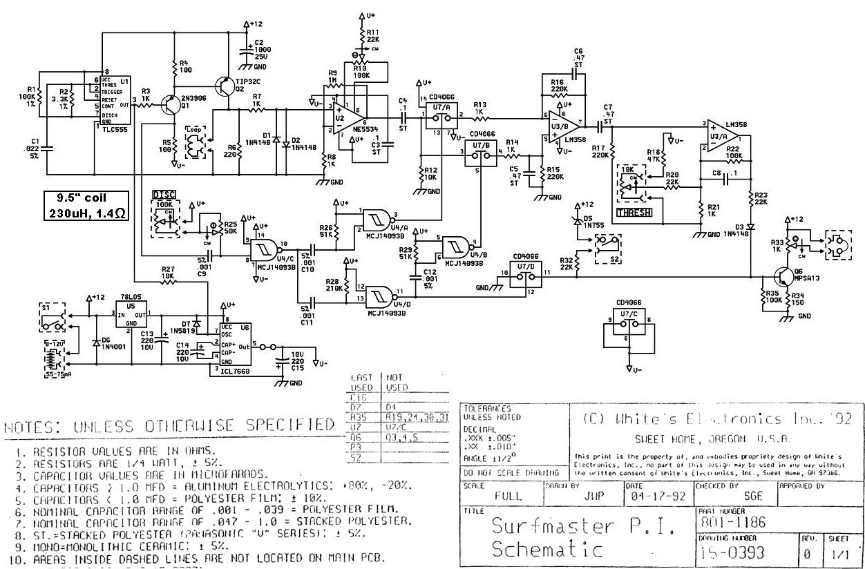

      im grateful for all your help to me on this...i need to try this cause i know that the detector can proform better than its doing...the diagram you enclosed..is that the original whites pi spec ???? if so why was the original altered ??? for now rather than mess around with my original pcb im going to partly make a second pcb and experiment with that and if i get improvement then i will alter my original pcb.
        This has been doctored, but I think it is a pretty fair representation of the original drawing.
          Change out #Q2= TIP32C with a IRF9640
          Replace the 220 ohm resistor with a 390 ohm resistor (1/4 watt)
          When finished installing the components cut a piece of aluminum foil 3/4" square.
          We will use this to adjust trimmer pot #R25 turning on the unit and adjusting
          the threshold so you can just hear it, adjust R25 for best response when the
          3/4" foil is passed by the coil. This should do it.
          You can try removing diode #D3=1N4148 and installing a jumper in it's place.
          This will allow a little finer adjustment of the threshold on the soft deep ones.
            thanks mate for that original spec...did the original surf pi work better than the modified version ???
