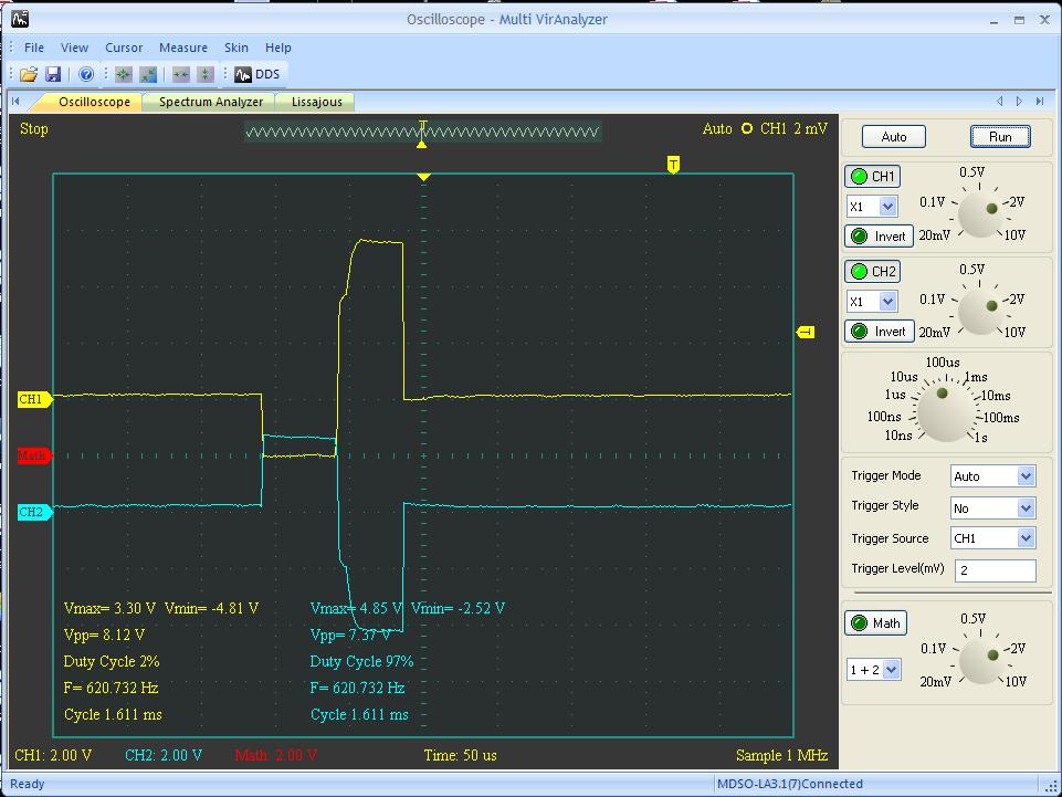

Below is a screen shot of the scope without a coil connected to the board:
[IMG]
[/IMG]
Below again is a screen shot of the scope with the afore mentioned coil connected:
[IMG]
[/IMG]
As mentioned before I'm very much beginner when it comes to using a scope, the same is true with electronics as a whole.
