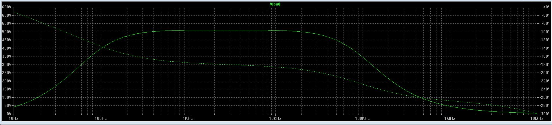

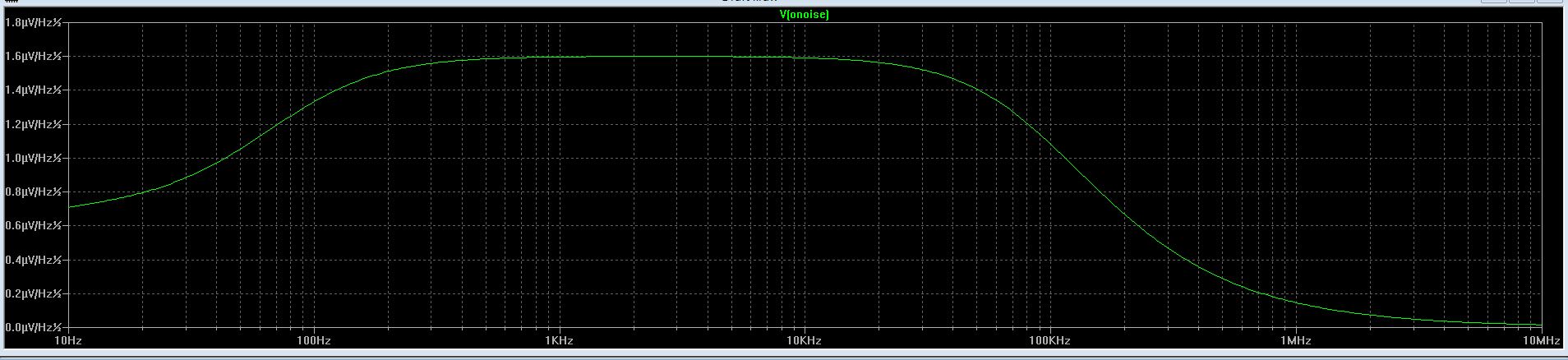

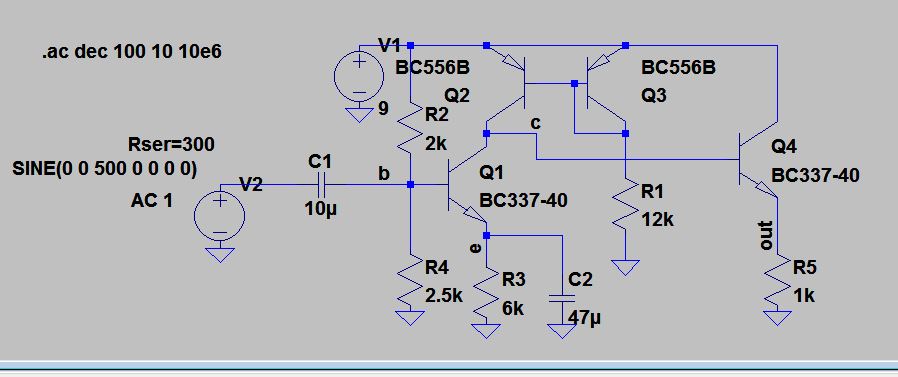

            OK, in case it is of interest, here is a 500x, large bandwidth, low noise, fully thermally stabilised 4 transistor amplifier:
              Originally posted by Beenthereuk View Post
              The main problem with it is I cannot seem to get gain above 800 without an extra stage.
              Gain is fundamentally limited by Early voltage, namely VAeq/VT, where VAeq is the combined Early effects of Q1 & Q2, and VT is thermal voltage. It sounds like your VAeq is about 20V, which seems low for these transistors. What do the models say?
              How much preamp gain do we need? I've seen a gain of 100 being enough in some of the threads.
              This is a system design question. Generally, 50-1000.
              Still not a stable-biased amp. It will spend most of its life railed out.
                Yes, it is the current mirror pnps with low VAF leading to low collector impedances. I stuck with them because I have a draw full at work.
                With 4.4 V of negative feedback on the emitter and a diode clamp fixing the current through it?.. I think its more stable than the pound. Still, have to build it to see.
                  You're still trying to match 2 uncorrelated currents at a high-impedance node, with no overall feedback. You can tweak it in, but it's just not going to stay there.
                    You dont consider the DC voltage across RE feedback?, the circuit should need no tweaking.
                    http://www.zen22142.zen.co.uk/Design/bjtbias.htm
                      RE has no useful effect on Q2's current. Build it and see what happens.
                        Very true, but it does regulate the current through Q1 thereby regulating its Q point (which is what matters most here), to a considerable extent, by auto-biasing to cancel out Vbe variations due to thermal drift in the mirror transistors. It simulates well for a range of input temperatures (-10 to +75 deg. C.) and works with every small signal BJT I've thrown at it, which qualifies the topology.
                          Build it and see what happens!
