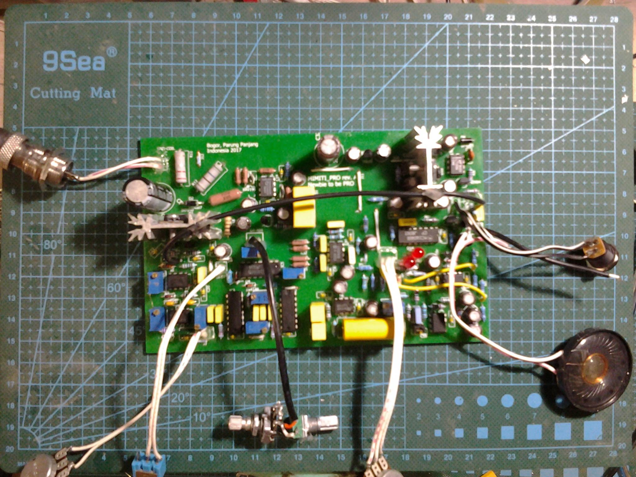

                • #53
                  Hello, 6666, mickstv, and green,
                  6666 thank for helping me
                  I have done for balance EF and GB , and can elimate redbrick, ferrite, and smooth tone treshold, no more flip flop tone
                  I use trimpot 100 ohm and adjust slowly for this
                  For video i will upload to youtube,
                  Many thank for helping me, and i learn how to use GB
                  My timing
                  Delay 7us, first sample 20us, delay 10us, GB sample 20us, delay 150us variable to 200us for best result sensitive and emi, EF 20us
                  2000pps , pw 100us
                  Wahyu

                    • #55
                      Hi 6666,
                      PCB project MIMITI_PRO , simple P.I with Ground Balance, schematic i combine from this forum,

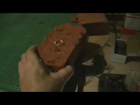

                      for TX and timing i use TD3X, Preamp i use 2 stage preamp, integrator i use tepco and lowpass filter add, and for audio stage i use mickstv schematic, and Power supply +5v i use MPP
                      Video GB test
                      first GB off, and last GB on, sorry for chatter i test at home at night, test outdoor less chatter.
