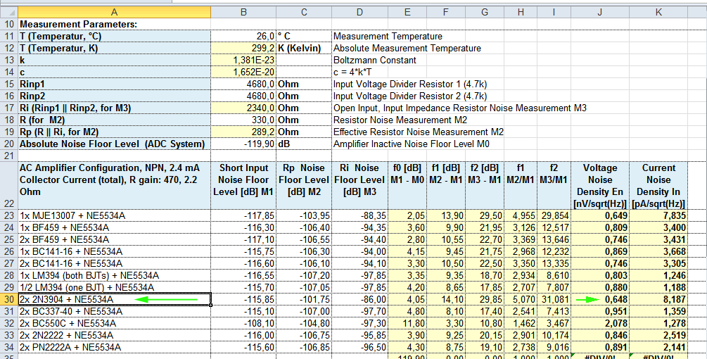

  • Was wondering when you going to thinks you forget current noise.
    J1 = (Johnson noise R1)^2/Hz, J2 = (Johnson noise R2)^2/Hz
    N1= (measured noise R1)^2, N2=( measured noise R2)^2, N0= (measured noise 0 Ohms)^2
    (Amplifier voltage noise at input)/sqrt(Hz) = sqrt{[J1(R2/R1)^2-J2]/[(R2/R1)^2(N1/N0-1)-N2/N0+1]} = 0.65nV/sqrt(Hz). This math independent of gain as should.
    • BTW, this preamp noise figure poor compared to good low noise opamp because of very high noise current = sqrt([N1(J2^2+V^2)-N2(J1^2+V^2)]/[N2R1^2-N1R2^2]) =7.8pA/sqrt(Hz), V=preamp voltage noise.

        Bravo Clancy,
        I'm very impressed! I get the same voltage noise density en = 0.649 nV/sqrt(Hz). And current density in = 7.835 pA/sqrt(Hz).
        The formulas are somewhat f**kn complex (see below). Anyway. I have to check them once again. But I'm satisfied to get the same voltage density result.
        Who would have thought, that my first simple measurement method would fail so much? The current noise can't be neglected with resistor noise measurements. I'm happy, that we have now a nice & more accurate measurement method.

        • But this is a very bad news for the 1k series resistor fraction.
          In the example above of in = 7.8 pA/sqrt(Hz):
          in is causing 7.8 pA * 1000 Ohm = 7.8 nV voltage noise. This is all screwing the performance of the ultra-low-noise thing.

            • Hi all,
              I have updated my Excel file and have put a few measurements this morning (see below zip-file). So you can check, whether I have calculated it correctly. I have to check it yet. But these noise figures make more sense now!
              Ok, up that new goal to 0.5 nV/sqrt(Hz). Oh boy!, this is going to be very very difficult now.

              • Interesting. The 2x 2N 3904 is performing very well for very low source impedances.
                And very cheap (0.04 EUR per BJT).
                Again the poor performance of the BC 550C. Forget it! Throw it out of the window. *LOL*

                      • Latest Measurements
                        Hi all,
                        this is the latest measurement list (see below the Excel zip-file). I have to make more measurements with different collector currents yet (only for some interesting BJT's of course).
                        AC-Amplifier-Noise-Measurements-04.zip
                        See, how a parallel of super cheap 2N 3904's excels.
                        Cheers,
                        Aziz

                            • Hi all,
                              I'm very excited about the 2N 3904!
                              Total collector current 5.8 mA (seems to be the best value so far). I have added a complementary NPN/PNP BJT driver stage to the output of the op-amp.
                              Results:
                              4x 2N 3904 + NE5534A (Gain resistors: 470 Ohm, 2.2 Ohm):
                              en = 0.376 nV/sqrt(Hz), in = 6.356 pA/sqrt(Hz)
                              3x 2N 3904 + NE5534A (Gain resistors: 470 Ohm, 2.2 Ohm):
                              en = 0.398 nV/sqrt(Hz), in = 6.505 pA/sqrt(Hz)
                              4x 2N 3904 + NE5534A (Gain resistors: 1k Ohm, 2.2 Ohm, more gain):
                              en = 0.284 nV/sqrt(Hz), in = 6.051 pA/sqrt(Hz)
                              (Cheap trick of course! *LOL*)
                              How is that now?

                              • Emitter degeneration is beneficial for 1/f noise. It is a proven fact for oscillators and it can't hurt to have some, provided it does not ruin the noise performance. In your setup emitter is in a feedback path so the emitter impedance is actively lowered by feedback in case of a signal, but not so much for the error (1/f noise etc.)
                                Current noise is not a problem for low impedance sources, and also the source - a coil - has a finite resistance and hence noise. There is something called "optimum impedance" that occasionally pops here and there, and it is simply ein/iin (voltage noise/current noise) and your input impedance is ideally matched if it is near it.
