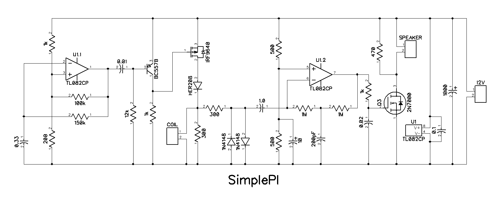

                              OK, here is the circuit with a choice of clocks for either a pMOS or nMOS FET coil drive stage. You only need to make one clock using the second TL082. Both circuits produce pulses that are 50 uS wide with a frequency of 333 Hz using the values shown. Make R15 a 200 k pot to tweak frequency.
                              [ATTACH]28226[/ATTACH]
                              [ATTACH]28227[/ATTACH]
                              [ATTACH]28228[/ATTACH]
                              [ATTACH]28229[/ATTACH]
                              And the LTSPICE file for the whole circuit:

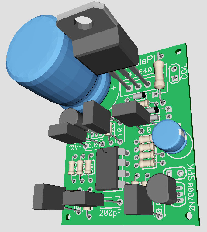

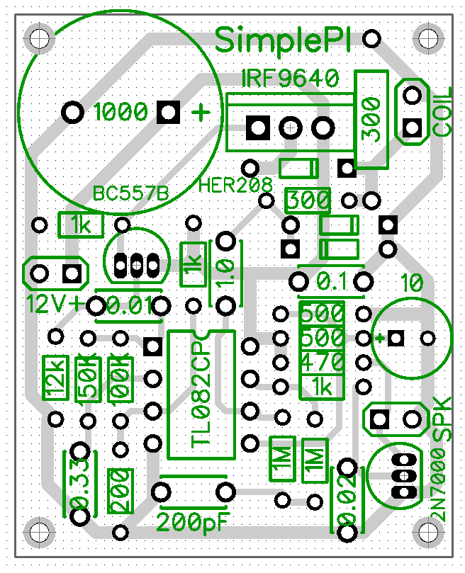

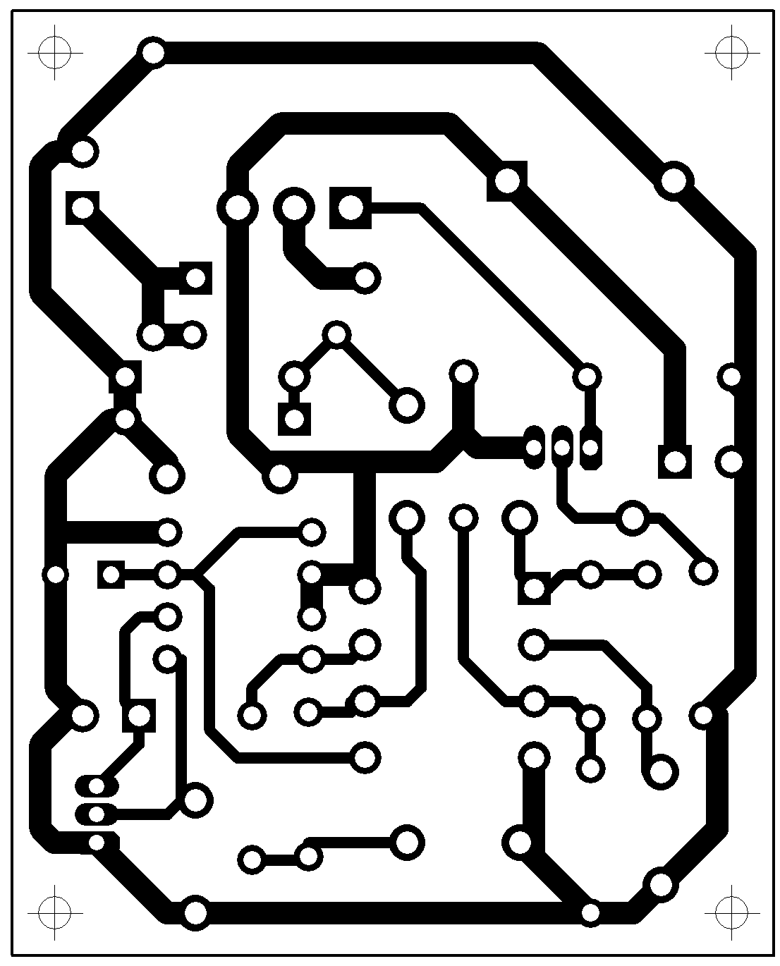

                              Because this schematic is very interesting and probably may be really small and cool device I have designed PCB by using authors sketch for P-channel MOSFET.
                              Not yet tried is it works at all. Hope it works. What replacement for 2N7000 I can use? Is J201 OK?

                              SPEAKER is PIEZOELECTRIC. Do not connect 8 or 32 Ohm or it will burn.
                              Board size 1.35" X 1.675" inches or 34.3 X 42.5 mm. Really small.
                              Any corrections required?
