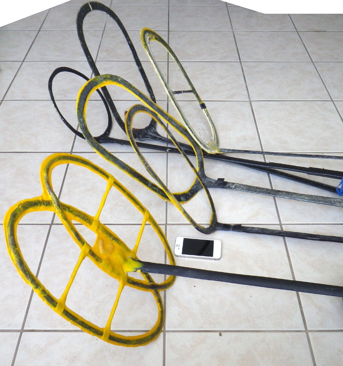

          Thank you guys for your reply. I will try to explain problem more clear.
          After few years of detecting in salt water and building some coils and detectors I can say that
          Every millimeter of coil thickness creates approximately one pound of drag in water.
          Can't believe in it? Buy Whites Dualfield or Minelab Excalibur or Garrett Sea Mark II or Tesorro Sandshark or any detector so called "for water". Go to water and move it.
          Better shape of coil to reduce that drag is "flat spiral". But flat spiral has huge coil to shield capacitance. If you add a spacer or insulation between coil and shield, sure you will have a good coil but again it will have huge drag in water.
          So I am thinking how about to build a "bad" coil with high coil to shield capacitance but "good" for water (3-4mm. thin) and than use some smart dumping to accelerate decay of that slow coil for a moment right before to take sample.

            Yes. Spider coils, basket coils are good but anyway if I have wire over wire design it will have more than 4 mm. thickness once coil will be finished with all insulation, waterproofing and fiberglass armoring.
            Only flat spiral adding that small amount 0.5 mm of wire thickness to total coil thickness.
            May be winding can selfshield in air but salt water much more conductive and can create capacitors even with very small unshielded areas. Practical test can show it works or not.

                      I am not only making shaft flat but hiding cables inside and making it sharp like two edges sword using sandpaper.
