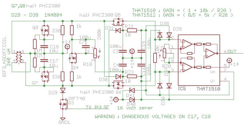

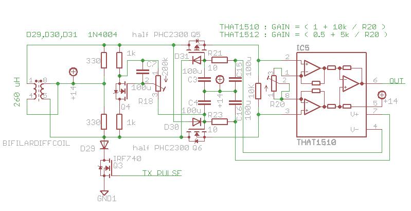

      Here's a circuit Moodz was playing with a while back. It has semiactive damping and power
      generation for the front end;
Name:	New Fronend R18DampingR20Gain.JPG
      R18 sets the damping...
        [ATTACH]28844[/ATTACH]

                              I like the FET with a pot as you can easily adjust it. The problem is if you don't protect the input
                              parts can fry if the flyback gets through. Here's a protected version of Moodz frontend;
