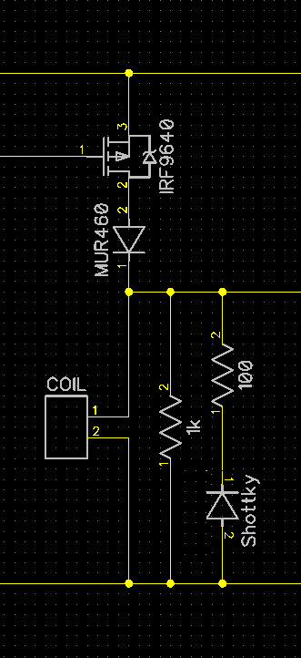

      But with using different damping resistors we can see a different decay curves.
      Idea is to bring coil voltage into preamp input range with low resistance load as fast as we can than use higher dumping resistance to read samples.
      Probably we just need to connect additional damping resistor for a short moment before first sample.
      How about 1k dumping resistor and 100 ohm resistor in line with Shottky diode.
      When flyback is more than 200mV diode is open and damping is 100 Ohm. Once it goes below 200mV diode will close and damping will stay 1 kOhm.
      No, you will underdamp coil this way, with low resistance value, making it even slower. Due to LC circuit nature, coil will not release energy any faster with any other resistance value other than optimal. Low resistance value will tend to short it and prevent energy release.
          So low damping resistance will prevent flyback to start releasing energy? I am so stupid to understand it. As I remember diodes in opposite direction (zero damping resistance) on relays or electric motors shorting and sinking that energy of flybacks.
          If 1 kOhm is proper damping resistor for my coil why use overdumping with 100 Ohm resistor for a short period of time will slow decay?
          Oops. I have fixed polarity of Shottky diode here: Click image for larger version

              Good old story about impedance matching, maximum power transfer is when circuit is loaded with one particular resistance value to burn energy fastest. If you reduce this resistance, energy will remain stored in coil magnetic field and charge of parasitic capacitance inside coil for longer period of time. Like in Chance, during short circuit phase, energy remains stored, no flyback, just slow dissipation due to circuit losses. This is not like power rail, or capacitor, to discharge it faster by shorting it to draw maximal current, circuit itself will not generate maximal current to short circuit. Actually even real capacitor (with real ESR and internal resistance) shorted with some “ideal zero resistance superconducting short” will discharge slower compared to say, real few or few tens milliohm short, bang and arc, but this may not be best analogy for this case. Analogy with motors or relays is not good too, diodes etc will clamp flyback peak, but this is very slow way to get rid of excess energy, useless for detectors. Connect one diode across your coil and measure what happens. No one use diodes to damp coils this way. With resistor in series, you will find fastest response with resistor value about equal to normal damping value.
              • #52
                Unfortunately it looks reasonable. I will try to see it on oscilloscope.
