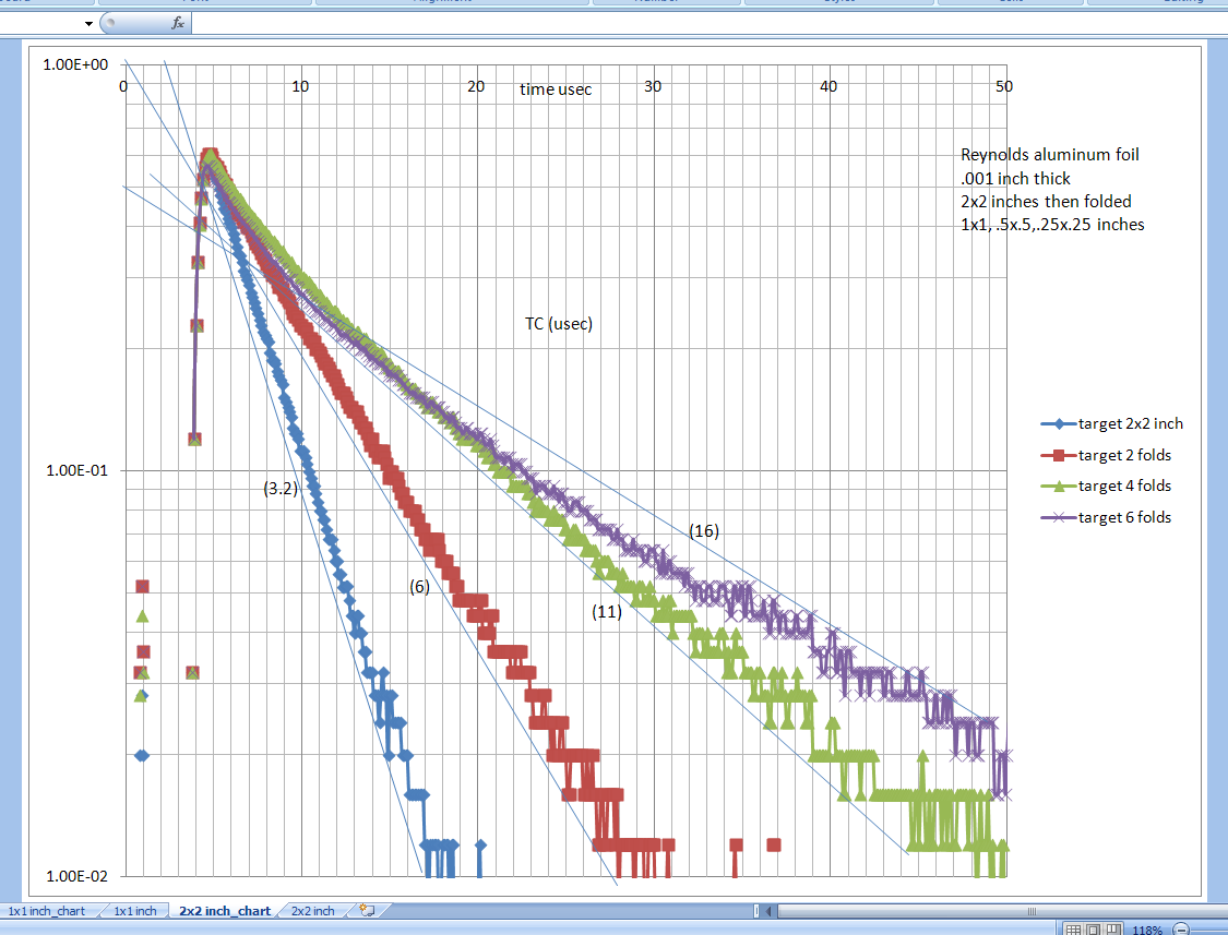

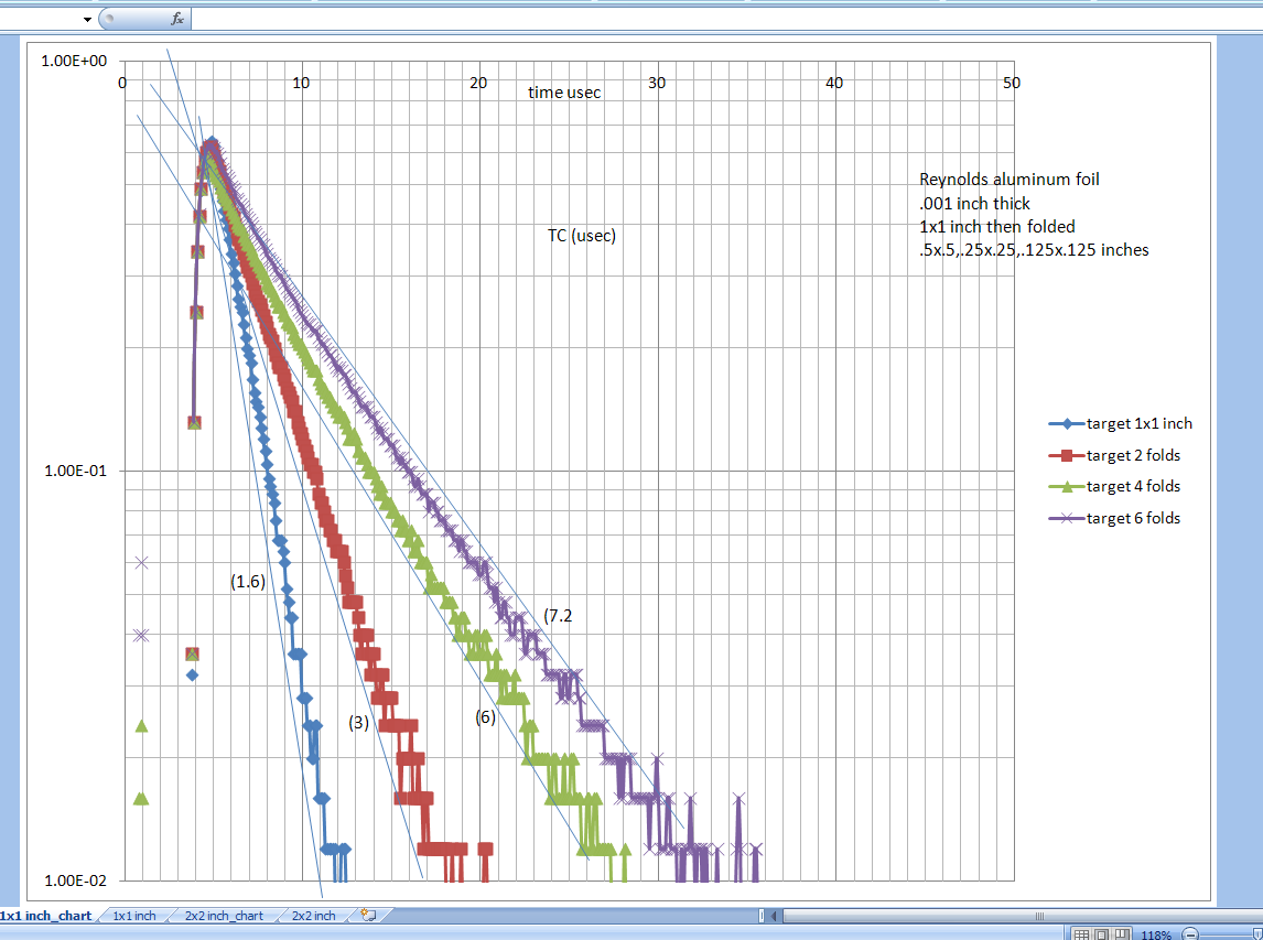

    I've been searching for gold nugget time constants. Found one reply suggesting 5 usec, didn't give size. Another metal detector site states, can detect one grain nugget at 1 to 2 inches, a match head size at 3 to 5 inches. Aluminum foil has been suggested as a target material. Size and shape are a couple variables effecting time constant. I plotted a 2x2 and a 1x1 inch piece not folded and folded. If I calculated correctly and they were made of gold they would weigh about 1.3 grams and .32 grams. What size nuggets should I expect to find with a PI detector with a 8 inch coil? I don't have any nuggets to measure TC's. I was wondering if someone with a PI detector and gold nuggets could compare nuggets vs the folded aluminum targets. Maybe there is to much variation in shape to give a good comparison or TC number for a given nugget weight. Folding the foil around a needle worked best for me.
    Interesting tests and results. In my mind the two things that are required for gold detection are the ability to sample fast enough and the surface area of the target. In your fold tests surface gets less as the T/C gets longer. It seems to me that the 1" square folded 6 times to a 1/8" x 1/8" near cube makes a pretty good/tough target. I'll have to try it and see how it works.

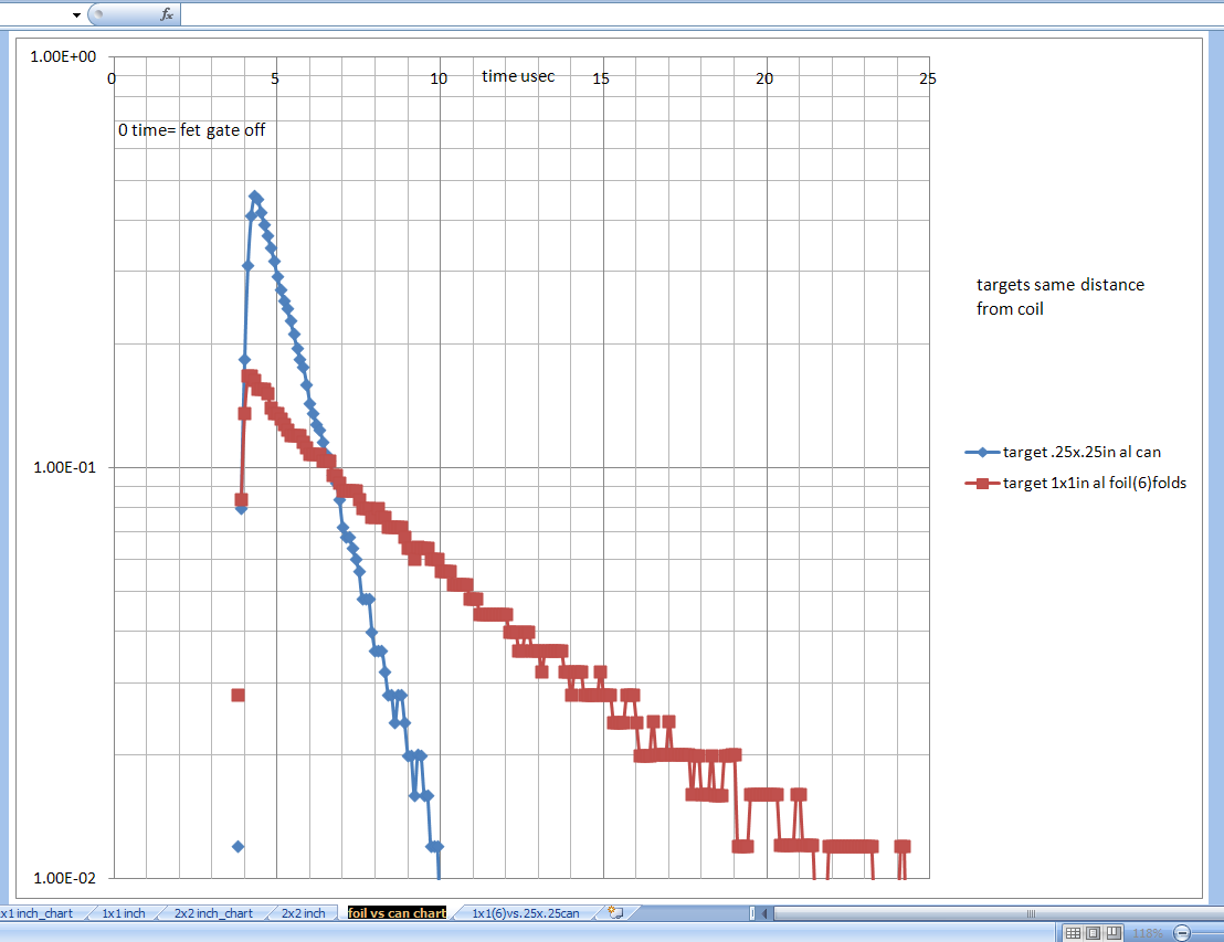

          Plotted the .25x.25in aluminum can vs 1x1in aluminum foil to see why the can is harder to see. The data was plotted using a small coil, targets were in the same location. Sample time determines which target is the highest amplitude. Not sure if using a smaller coil has any effect.
            I think it is due to the longer T/C of the foil being a slower decay is easier to detect. The surface areas are about the same in reality so it seems the biggest difference is in the T/Cs. A small fast coil should have the advantage of a more concentrated field necessary to see the targets. The foil target is effectively 16 times thicker than the soda can is.

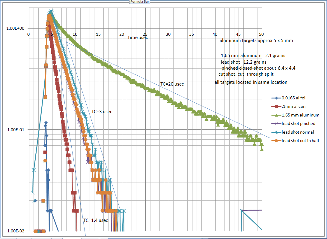

                        Charted some more data. Don't have any round aluminum, going to get some. Cut a square 5 x 5 mm x 1.65 mm out of a piece of aluminum. Recorded a fishing lead split shot, 3/0 I think. The time scale was to large to plot the aluminum foil and plot the other targets. I had ball parked the aluminum foil at .001 inches in the past. This time I weighed a 200 mm x 200 mm piece on the reloading scale, .1 grain resolution. If I did the math correctly the thickness is .00063 not .001 inches. The aluminum piece is equivalent to a 1 gram gold in volume. The lead shot a 1.35 gram gold. Want to record smaller pieces of aluminum. Think the square aluminum or Dan's slugs would be a better target for simulating gold nuggets. How small a nugget should we try to simulate for a PI detector? Don't think the lead shot would do. Was surprised all the targets plotted close to the same amplitude at the same distance, and that there wasn't a bigger difference between the lead shot as is, pinched shut ( not smashed), and cut in half through split. Coil on time was 85 usec. Probably have to record some actual gold nuggets to verify simulation and get an idea how much effect shape has.
                          Plotted two more aluminum targets. 5.7 x 2.77 x 1.65 mm aluminum and 4 x 3.66 x 1.65 aluminum. Both targets plotted almost the same with a time constant of 11.3 usec and a peak amplitude about half of the 5 x 5 x 1.65 aluminum target at 5 usec. The volume is about half of the 5 x 5,so they simulate a .5 gram target. Expected to see a difference do to shape. If they do simulate gold the time constant is higher than I was thinking. Will chart the aluminum targets when done with recording all of them.
                            The split in the lead target probably generates 2 different sets of eddy currents, not the same as a full round lead target.
                            You could try just one half of the target as half sphere and flatten the other half down to about 0.5mm thickness, to see the difference in response.
