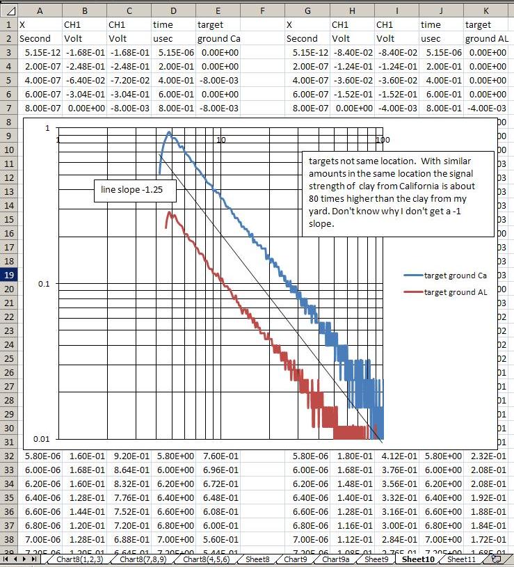

    Chet sent me some targets from old hydraulic mining areas east of Sacramento Ca. A chart of some clay he sent. The x axis is time in usec after coil turn off.

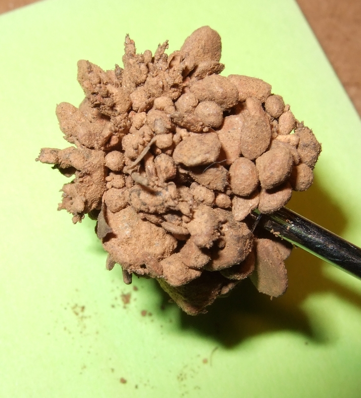

      Hi green
      The clay I sent is attracted quite readily to a rare earth magnet. Does Alabama clay have the same magnetic characteristics?

        Hi Chet
        You weren't kidding. I got two or three pieces when I stirred the magnet in the Al clay. Shaft diameter .075 inches (2 mm).

          Hi green
          That is some hot clay! Severe ground balancing problem.

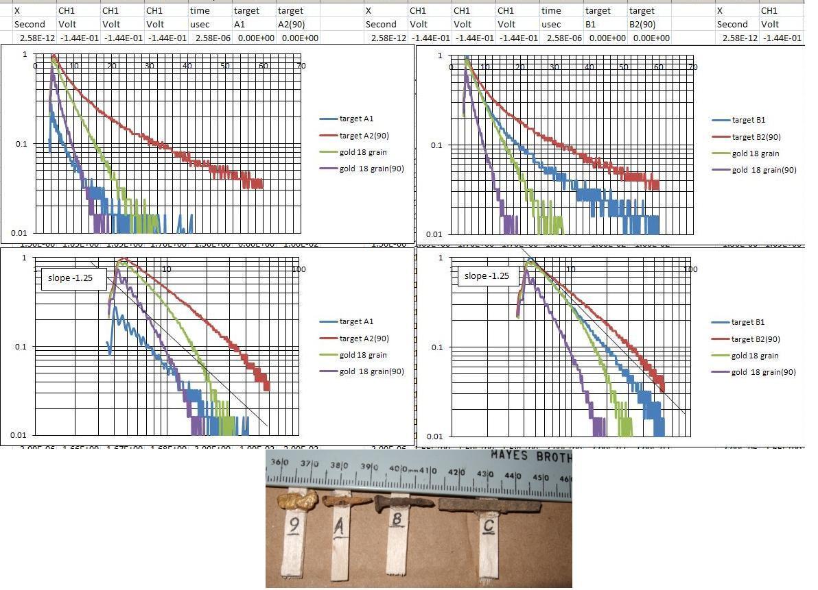

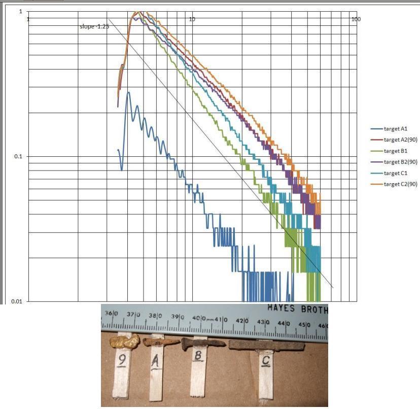

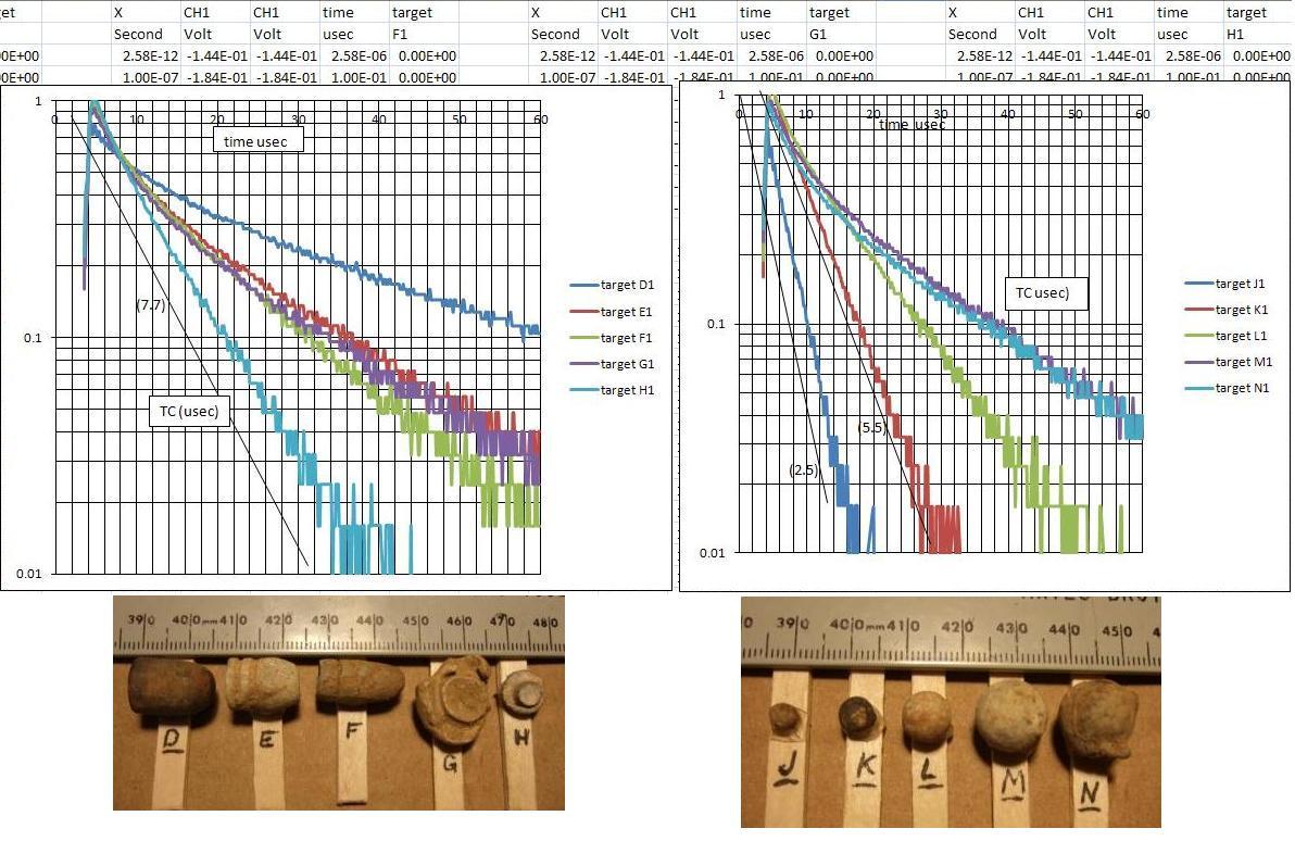

            More targets from Ca. Charted the nails linear-log and log-log. Plotted straighter log-log. Added the -1.25 slope line on log-log charts (clay slope). (90) is the target rotated 90 degrees. Coil on time 90 usec.

              Hi green
              Great charts, much to ponder over. I just found another bullet that looks like the one labeled D it has a steel jacket, probably a military .45 caliber.
              Please check D with a magnet.
              Thank you for the charts,

                Hi Chet, D isn't steel.

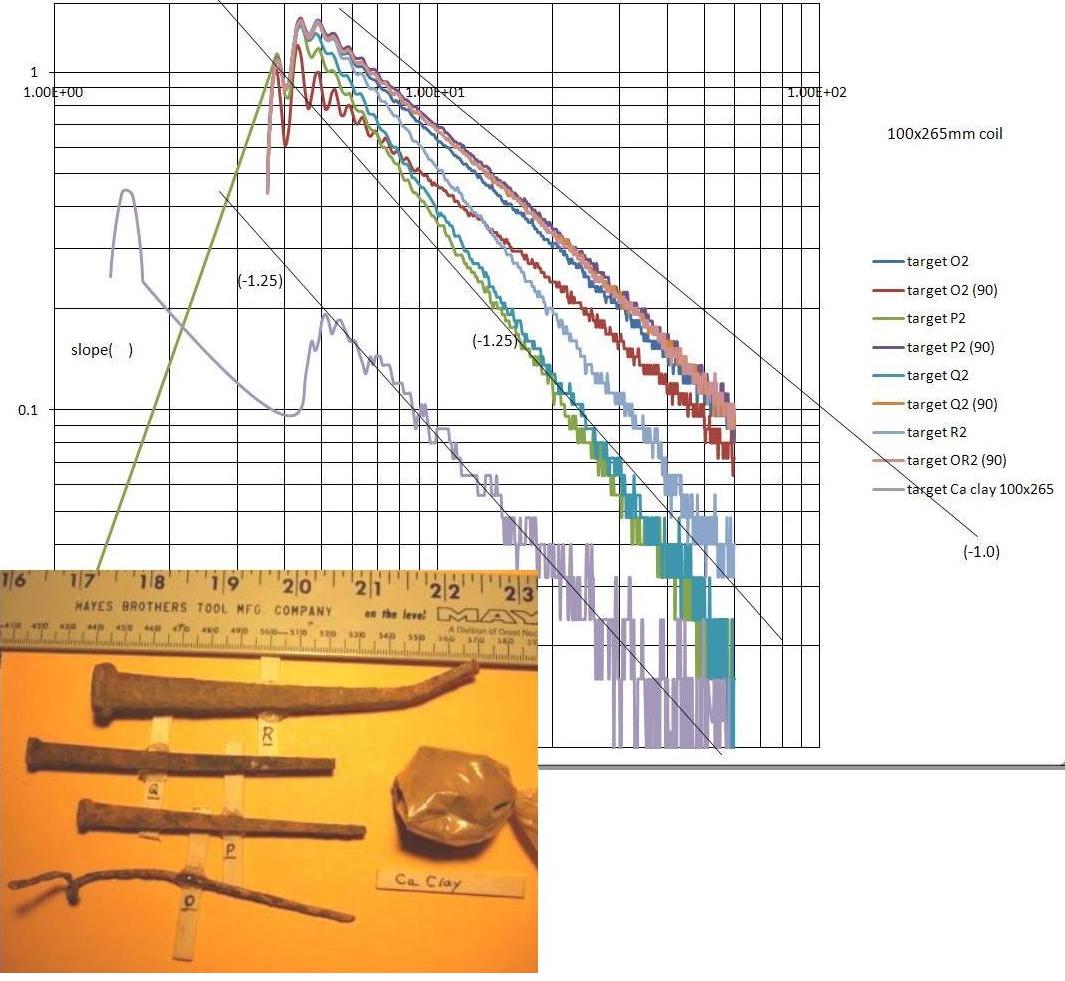

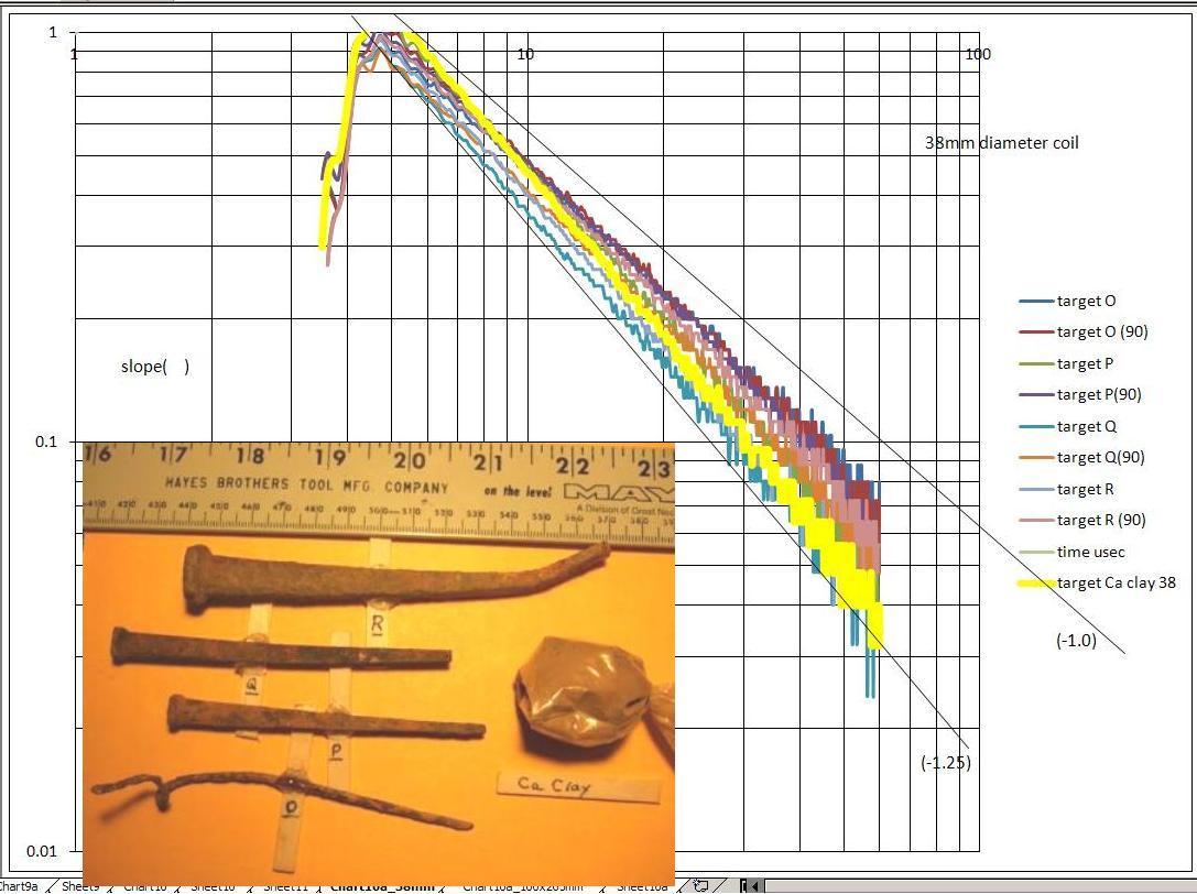

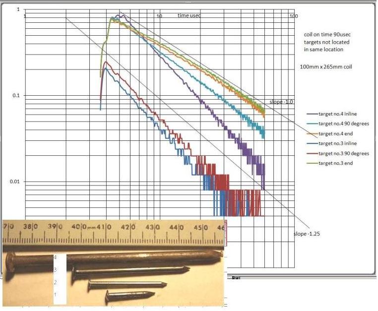

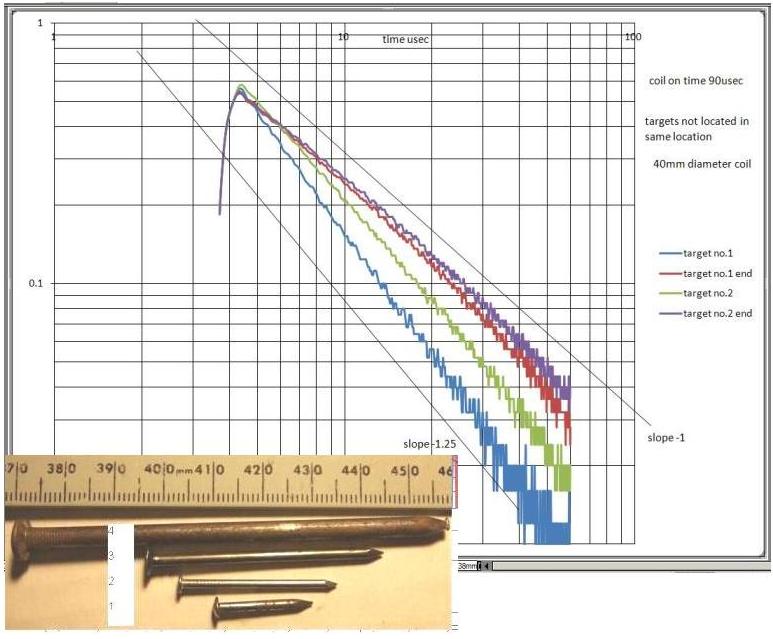

                    More targets from Ca. Depending on target size I use different coils to get enough signal to noise to chart the time constants. The targets today were large for the 38mm coil that I've been using for the nuggets and smaller targets. I've compared TC's for coins and some other targets in the past using different coils and saw little difference. I compared the targets today with the 38mm diameter and a 100 x 265mm coil.There is a difference with the large nails, The Ca clay has a -1.25 slope with both coils. The slope did change when I spread clay to a thin layer with the 100 x 265mm coil ( not much signal) so maybe thickness and amount of material might effect the slope. Didn't try it with the 38mm coil but I will the next time I plot some targets. Some of the nail tests had a slope close to -1. All plot close to a straight line on a log log scale. (90) is the target rotated 90 degrees (target vertical)

                      Hi green
                      Is there a difference in time constants between old nails and new nails? Could you plot the data from the new nails in post #42 on the same log-log scale as the chart "nails_38mm" for comparison?
                      Thank you,
                      Chet

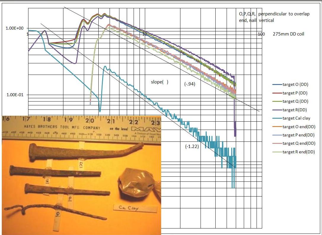

                                Charted the Ca nails with a 275mm DD coil. Orientation doesn't effect the slope as much as it does with the other coils I used.
