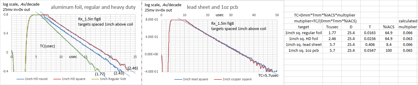

    What does your meter read for a 1inch square and a 1/2inch square of regular strength aluminum foil? Would or does heavy duty read the same?
    T-C = 0.072 x D x T x %IACS Skippy's formula reply#165. If TC is proportional to D and T and multiplier doesn't change, they should read the same?
    That is an interesting experiment. I used 1" square pieces of regular foil (0.02mm). One square is too low to read. Two squares reads 1.8..............10 squares reads 25.00.........15 squares reads 38.0, and from then on it seems to be invariant. I have all the intermediate numbers up to 20 squares which is 0.4mm total thickness. Need to think about it more, but suspect it relates to the skin depth at 250kHz. (0.3mm at 15 squares).

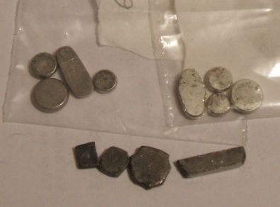

        I'm sure I can get hold of some larger bits of ingot 60/40 solder, used in electric melting pots for 'dipping' wire-tinning. That would probably be a good material for testing thickness-related stuff. One for the other threads.
        My unfinished 'nuggets' include some quite round ones, I'll try and test them before and after finishing. Attached picture of the little fellows:

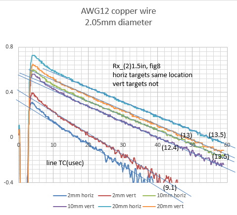

                    [/LEFT] I still like trying a 19mm(3/4inch)piece of copper wire, AWG22, AWG19 andAWG16. Tau doesn't change with an error in cutting length. Easy target to make. Some may have already, if not I have some and would be happy to mail them. Anyone interested I would be interested in detection depth, detector used, coil size and description(settings used, ?). Thinking of asking at a couple other forums. Not sure AWG22, 19, and 16 are the best sizes to use. Expect to see some differences, detector used, S/N being some of the causes.
                    The actual metal doesn't matter much. You can create targets that mimic the tau and depth of gold nuggets with lead, copper, aluminum, silver, etc. I'd pick something that's easy to deal with. Lead shot is already spherical and roughly the sizes you want. Lead solder can make any size you want. Another alternative is split shot used for fishing; I don't like it as much because it's physically split, but either squeeze it together or slice it in half and it works just fine. Aluminum foil works well, too. I use not only 1x1 targets but also 10mm and 5mm squares. They can be stacked in thickess to emulate larger nuggets.
                    Think cutting a piece of wire 19mm long would be easier and more repeatable than other targets. Learning something playing with Skippy's targets. Mostly I know less than I was thinking I knew. Plan on more testing.
                      Here is some more testing. This time on lead tape 0.19mm thick and 25.4 x 25.4mm square. %IACS readings are - 1off no reading, 2off 2.2, 3off 3.85, 4off 5.06, 5off 5.51, 6off 5.51 and so on for more squares. Total thickness for 5 squares = 0.95mm
                      Next is copper tape; solid type 0.07mm thick and 25.4 x 25.4 mm square. %IACS readings are - 1off 7.75, 2off 27.5, 3off 46.8, 4off 56.9, 5off 57.0 and so on. Total thickness for 5 squares = 0.35mm
                      Note as long as tape sample covers the sensor end, the area does not matter i.e. 0.5" square will measure exactly the same as a 1", a 2", or a 6" or more.

                        Interesting. Looks to me %IACS readings are proportional to target thickness(approximate)if target thickness<2*skin thickness. Wonder how skin depth relates to a PI, would 100kHz relate to sampling the decay at 10usec? Does any of this make sense?
                          Oh good, that's what I expected. Somewhere I have an AutoSigma, just need to find it.
                            Yes, the very early part of the exponential slope is fairly linear-looking so it appears as if readings are proportional to thickness.
