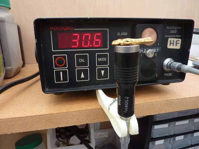

                        • Nugget IACS
                          I managed to get a reasonably flat surface on a nugget from SE Australia such that it would read the %IACS on the conductivity meter. Pure gold would read 70% relative to copper according to my conductivity chart.
                          Eric.
                            [ATTACH]44764[/ATTACH]
                            Eric.
                            What does your meter read for a 1inch square and a 1/2inch square of regular strength aluminum foil? Would or does heavy duty read the same?
                            T-C = 0.072 x D x T x %IACS Skippy's formula reply#165. If TC is proportional to D and T and multiplier doesn't change, they should read the same?

                              • Would your nugget read the same %IACS if it were thin? Was trying to Edit reply above, reason for same replies. Not computer smart.
