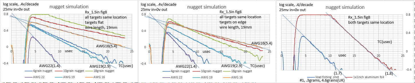

    Charted more data
    First chart is with targets laying flat. 10 and 18grain nuggets similar decay slope as 19mm of AWG16 copper wire, nuggets had higher amplitude. 4grain nugget, similar slope and amplitude as 19mm of AWG19 copper wire.
    Second chart is with targets on edge. 10grain nugget similar to AWG16 wire. 18grain nugget similar slope with higher amplitude than AWG19 wire. 4grain nugget higher amplitude with slower slope than 19mm of AWG22 wire.
    Third chart compares 1x1inch aluminum foil with fishing split shot labeled #1, .3grams, not the same as Carl's bird shot. Shot(not much different than 4grain nugget on edge)is higher amplitude with a slower slope than AWG22 wire. Maybe #4 bird shot would be closer to AWG22 wire? 1x1inch aluminum foil is over 300 times the amplitude with a similar slope as the fishing shot.
    I'll try to get some lead shot to try. Any suggestions on other sizes besides #4bird shot?
    Interested in what Skippy comes up with to compare with other targets.

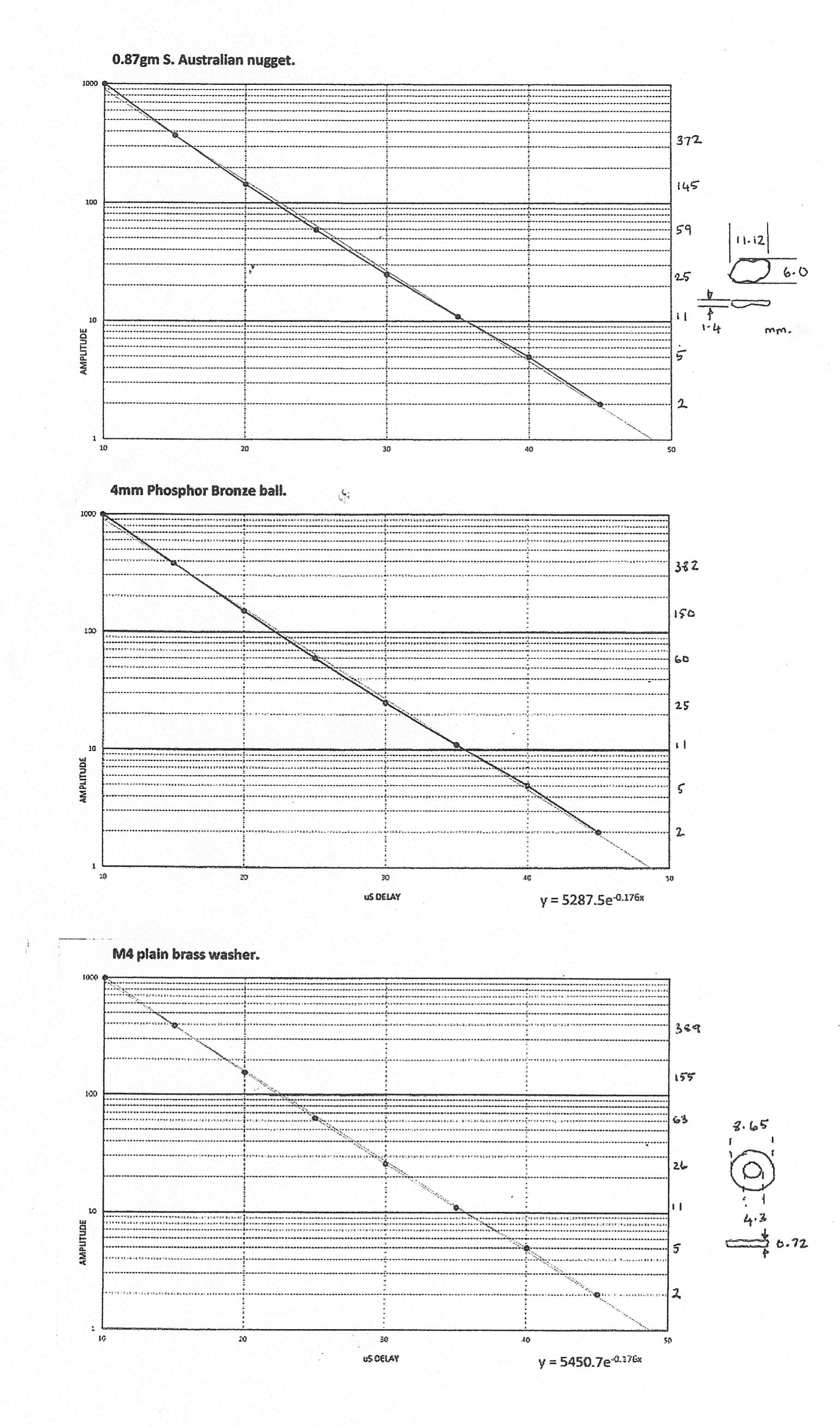

      I have a gold U.S Double Eagle $20 coin and my Hocking conductivity meter gives a reading of 15% IACS. I also tried a George 5th Half Sovereign and this reads 16.5%, which is what I would expect. Unfortunately, I do not have a nugget with a flat, or large enough, surface for the Hocking to give a reading. However, I selected a flattish nugget close to 1gm and weighed it on more accurate scales where it reads 0.87gm. I then plotted its decay with my PI viscosity meter from 10uS delay at 5uS intervals to 50uS, where the signal virtual disappeared.
      Next, I plotted one of the 4mm phosphor bronze ball bearings that I have. It matched almost exactly the decay of the selected nugget. Next, I raked through my washer box and measured several small plain brass washers until I found the closest match. This was a M4 washer and again I have plotted the result. The TC, which is the 33% of maximum amplitude, comes out at around 16-17uS for all three samples.
      Detection range for the three samples was measured on a Vallon connected to a 7" coil. Nugget gave 6"; ball gave 4.5", and the washer 6.5".
      Eric.

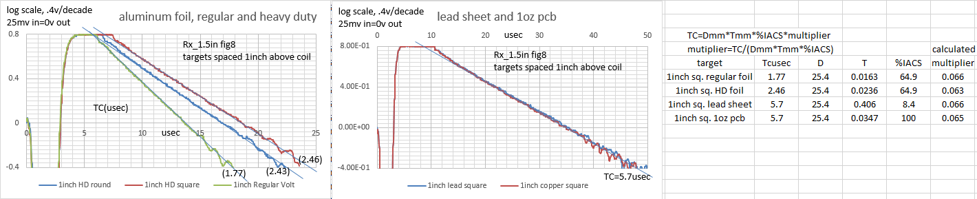

              Same as Eric, great piece of work.
              Tried your formula with some test pieces I have. Foil pieces measured close to Reynolds specifications so I used them, searched 1oz pcb thickness. With probable measurement errors, calculated multiplier was closer to being the same with the different targets than I expected. Not suggesting multiplier number is more accurate than yours, just what I got. Our TC numbers are always a little different, wonder if it's because your measuring with Tx on and I'm measuring with Tx off. I didn't see much difference in TC, square vs round, some amplitude difference. Thanks again for the reply. I'm going to try some of your targets, maybe in a day or three. Might try 1oz(2inches square)pcb and 2oz(1 and 2inches square)pcb to check against your formula.
              first chart 1inch regular Volt should be 1inch regular square.

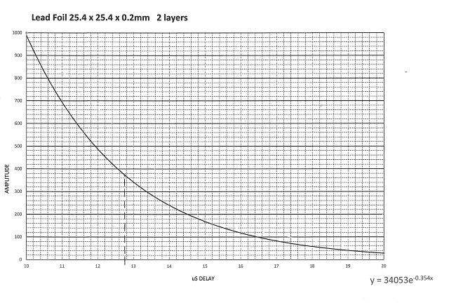

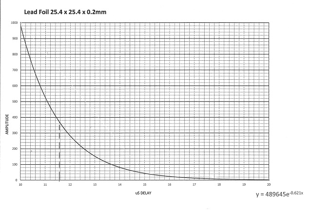

                  Does the lead foil read on your PI viscosity meter? Maybe a 1inch square of 1oz pcb.
                  • I've just measured up a few other coins.
                    The British 2 shilling from 1947 - 1967, and its decimal equivalent, the large 10 pence 1968 - 1992 are another large CuNi25 coin that's just suitable for the 2mm thick nugget models, I measured a few as 1.95mm thick.
                    And I examined my 10,20,50 Eurocents. The 50c is about 2.1mm thick, so would be a possible choice, but the 20c measures as 1.95mm, so would be good enough. The 10c is 1.7mm thick so only useable for thinner/smaller nuggets. I haven't actually measured any of these 3 coins for TC etc, I will do so soon, as the 14% IACS figure I found online is a bit vague.
                      Yes the lead foil does read, particularly on the 10uS delay setting. The tests I have done so far are with the gain and target distance set to give a reading of 1000 (mV) on the display. The target is then removed and next delay is set. Between each measurement the electronics is set to zero by means of a pushbutton. This removes the effect of any spurious or non-linear responses in the RX circuit. As you can see the decay is very fast, such that by 20uS there is no measurable signal. Plotting on linear axes enables the decaying voltage to be easily read such that the 37% point can be determined with accuracy. This measurement corresponds to 1 tau which is read off the X axis to be almost 11.6uS for the single layer.
                      For the two layer sample the decay becomes longer as can be seen in the second graph. The value of tau increases to 12.7uS and adding further layers would give corresponding increases. It should be noted that electrical contact between layers is not necessary.
                      As to detection range, the only detector I have set up in my workshop at present is a Vallon VMH3CS with a 7" coil. The single lead foil is detected at 4" and the double at 9". Unfortunately, I don't have any blank pcb. I have a board with a 1/2" track along one edge and that gives a reading of 5.8 % IACS.
                      Eric.
Name:	Lead foil 1.jpg
ID:	352593 Click image for larger version
Name:	Lead foil 2.jpg
                        Eric.
                        [ATTACH]44739[/ATTACH] [ATTACH]44740[/ATTACH]
                        Hi Eric, thanks for the tests. I'm wondering why you get 11.6usec for a 1inch square piece of lead .2mm thick when I get 5.7usec for a piece .4mm thick.
                        I'm still confused with reply #167. Where you state a TC of 16 to 17usec for the targets when your chart shows a TC around 5usec. Maybe I'm looking at it wrong?
                        • Those charts in #167 do seem to show the nugget having a TC of 5.6 microsecs.
                          I used decay from 300 to 10, over a time of (35.5 - 16.5) = 19 us
                          ln (10/300) = 3.40; TC = 19 x 10-6 / 3.4 = 5.59 x 10-6 secs.

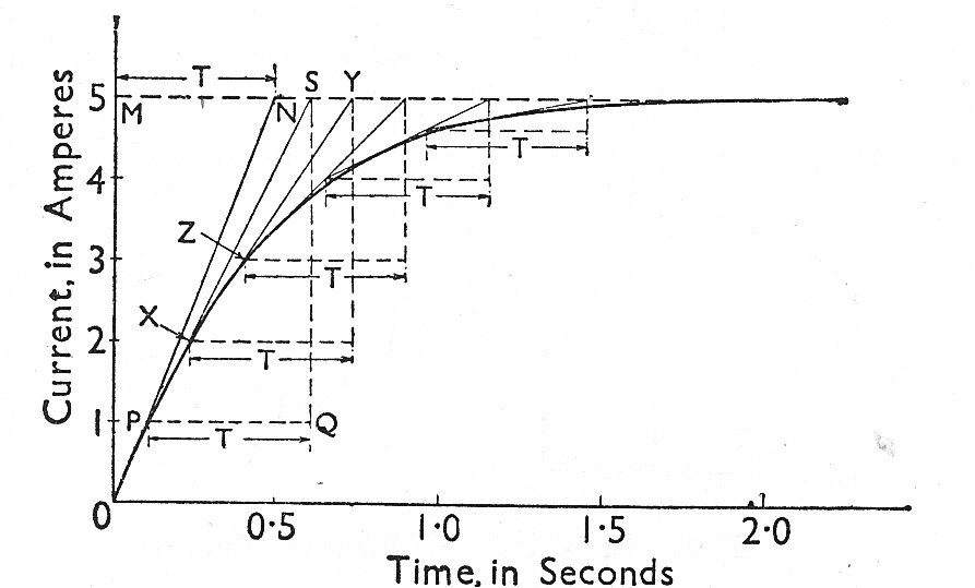

                              This is the basic diagram on which my value of time constant depends and can be confirmed in many text books on electronic principles.
Name:	Inductor current fall.jpg

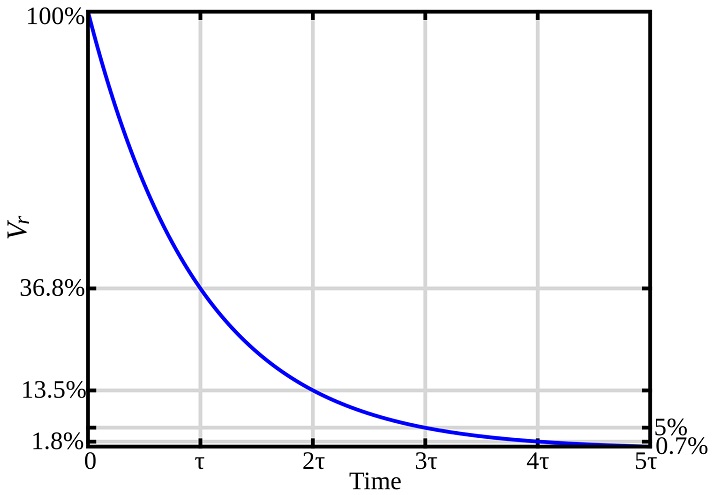

                              Time constant does not change wherever you look on an exponential growth or decay. It would not matter whether you start at 5, 10, 15uS after the true commencement, the value would always be the same for a given L/R circuit, which is what a non-ferrous metal target is.
Name:	Inductor current growth.jpg
                              This shows current growth but the same applies for eddy current decay. This example from my 1955 college book is for a 2H inductor and a 4 ohm resistor gives TC of 0.5 seconds. Stepping anywhere along the curve, even though the voltage and time is changing will always result in 0.5 seconds.
                              Eric.
                                [ATTACH]44747[/ATTACH]
                                [ATTACH]44748[/ATTACH]
                                Eric.
