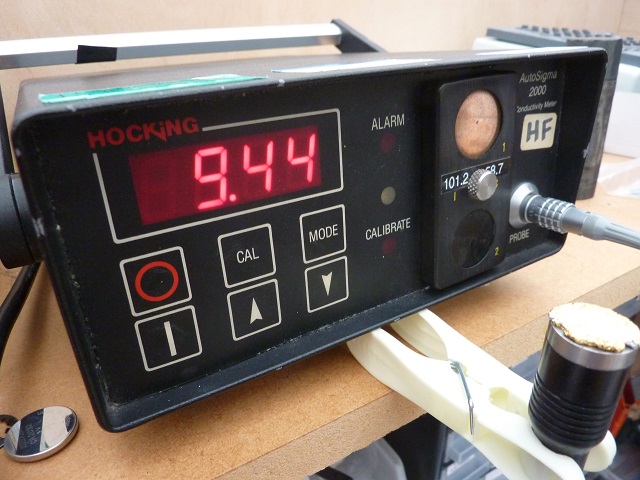

    Regarding that Cupro-nickel disc of Eric's, I came across this small graph showing how nickel percentage affects resistivity of Cu-Ni alloy:
    ... from which you could take a reading of 0.475 for 43% Ni alloy. This translates to conductivity = 2.1 x 106 ; or 3.6% IACS, as Mr Hocking indicates.

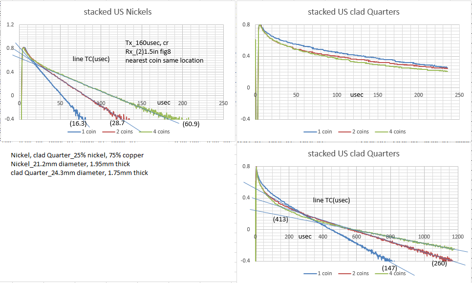

    Some charts with US Nickel and US clad Quarter. Was trying to understand stacking effect. Been posting Nickel TC at 10usec, got over 16usec today. Maybe didn't chart long enough decay before drawing decay line(10usec TC)? Depending on number of coins, delay time for straight line linear-log decay needs to be 1 to 2 times TC. Stacking double number of coins didn't double TC, would doubling thickness double TC? Been using TC=T mm * D mm * %IACS * multiplier. T * D for the Nickel and Quarter are close to the same. Made with the same material. Why is the Quarter TC 9 times the Nickel TC?
    Duh. Clad to a core of 99.5% copper core.

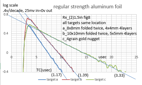

          • Two foil targets that might work for 1 to 2 grain nuggets. 4x4mm 4layer probably best. Foil was cut 2 times desired size and then folded twice.
            Folding foil around a needle or straight pin works best for me.

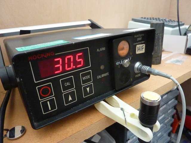

              • Munching through a few Ferrero Rocher chocolates yesterday, I wondered if a mimic 'gold' nugget could be made from the foil wrapping. Carefully removed and smoothed flat it is almost square at 9.5cm x 9cm and thickness 0.02mm. No reading was obtained on the Hocking conductivity meter for the single piece. Folded in half it read just 1.18. Progressively folded, I ended up with 64 layers and 11.2%. Further squeezing in an engineers vice brought the figure up to 30.5% which is very close to the Australian gold nugget.
Name:	Ferrero Rocher IACS.jpg
                For comparison another foil was screwed up and rolled into a ball, which was then compressed as far as possible in the vice. This more represents a nugget with inclusions, minute cavities and an irregular edge. In the last picture, the two measured ones are on the left, while basic folded ones on the right. Detection ranges are 9" for the 30.5% and 7" for the 11.2% using a Vallon with 7" round mono coil.
                Eric.
Name:	Ferrero Rocher IACS 2.jpg
Name:	Ferrero Rocher nuggets.jpg

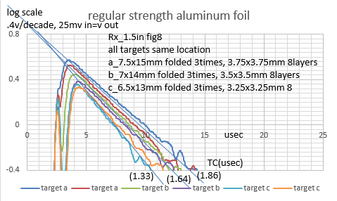

                    • http://www.geotech1.com/forums/attac...2&d=1546205793 Thinking TC might be alright, target area probably to large(amplitude higher than a small nugget would be).
                      Made some smaller targets folding foil. Started with 15x15mm square, cut in half(2 targets),folded one for square then folded twice for smaller square(3.75x3.75_8layers). Repeat with other half. Did the same for 14x14mm square and 13x13mm square.
                      Amplitudes might be closer to a small nugget. Harder to fold than the 2fold targets in nugget simulation_7. Thought the same targets might chart closer than they did.

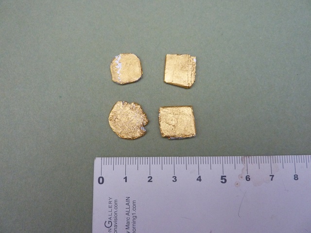

                      • I don't understand the concern over metal type or purity. As I mentioned before, just about any metal can be used. If the goal is a set of targets that different people can replicate, then I think household aluminum foil is the best answer. You can create any tau you want by either surface area or layered thickness. You can adjust signal strength by arraying multiple identical pieces, just make sure they don't touch. If the thickness of household foil varies, then it can be measured and target sizes adjusted for proper tau. Probably won't amount to much.
                        • "I don't understand the concern over metal type or purity."
                          I was trying to make something that represented a real nugget. Something vaguely the same size and shape, so you could bury it for in-ground testing, tip it on edge to see how your detector responded. So targets that just mimic signal strength AND Tau are not necessarily ideal. Mr. Green has shown how lengths of heavy gauge copper wire will do this. But tip a round bit of wire on edge, and it's the same, because it's round. Likewise, something made of multiple bits of metal glued to a piece of plastic is not great.
                          And the 'concern' over metal type and purity is simply because lots of metals out there are rather unknown in composition. Lead shot isn't lead. If I buy some Eley shot here in the U.K, it could be noticeably different to the same shot made by BlackHills Co. in the US of A., and neither will be the same as pure lead.
                          We're not trying to be picky about the metal and its source. Look at the shortlist: lead, 60-40 solder, 99C lead-free solder, CuNi25 coin alloy, Zinc, EuroCent aluminium-bronze. All common, dirt-cheap, easily obtained.
