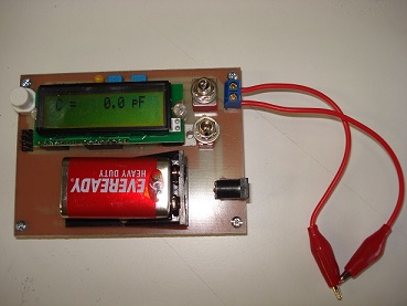

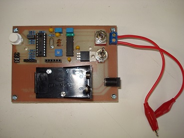

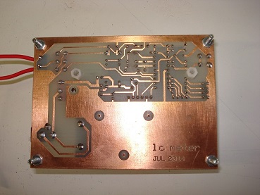

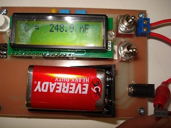

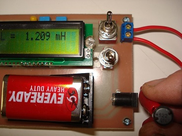

ID:	341347l.c. meter.zipjust finished a lc meter that uses a pic16f628. Got the schematic and hex code from https://sites.google.com/site/vk3bhr/home/index2-html and expalins how to calibrate the meter.
        It is simple to make and is pretty accurate & easy to use.
        I have attached photos of my unit and a zip file with pcb artwork, pcb layout, schematic and code.
        Last edited by Finderskeepers; 07-25-2014, 03:11 AM. Reason: forgot to attach photos
