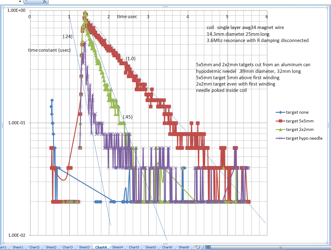

                          Plotted some more data. 5x5mm and 2x2mm cut from an aluminum can. Cut 7 mm off the hypodermic needle, .89mm x 32mm. The data isn't as clean as reply #53. I'm always changing things, guess I made things worse. Shouldn't effect time constant, reply #53 the scope trigger had a resistor in series making it look like the amplifier was coming out of saturation 500nsec sooner than it was. Cut the 2x2 aluminum can to see if I could make a target similar to my hypodermic needle, still has a longer time constant and more signal. The needle I'm using is larger than the needles Nupi is using. Tried to get some needles, they don't sell without a prescription. With the needles being smaller I don't know if I could plot them anyway.
                          The 5x5mm target was 10mm above first winding not 5mm as listed on the chart.

                            Interesting tests.
                            You have perseverance and I like that.
