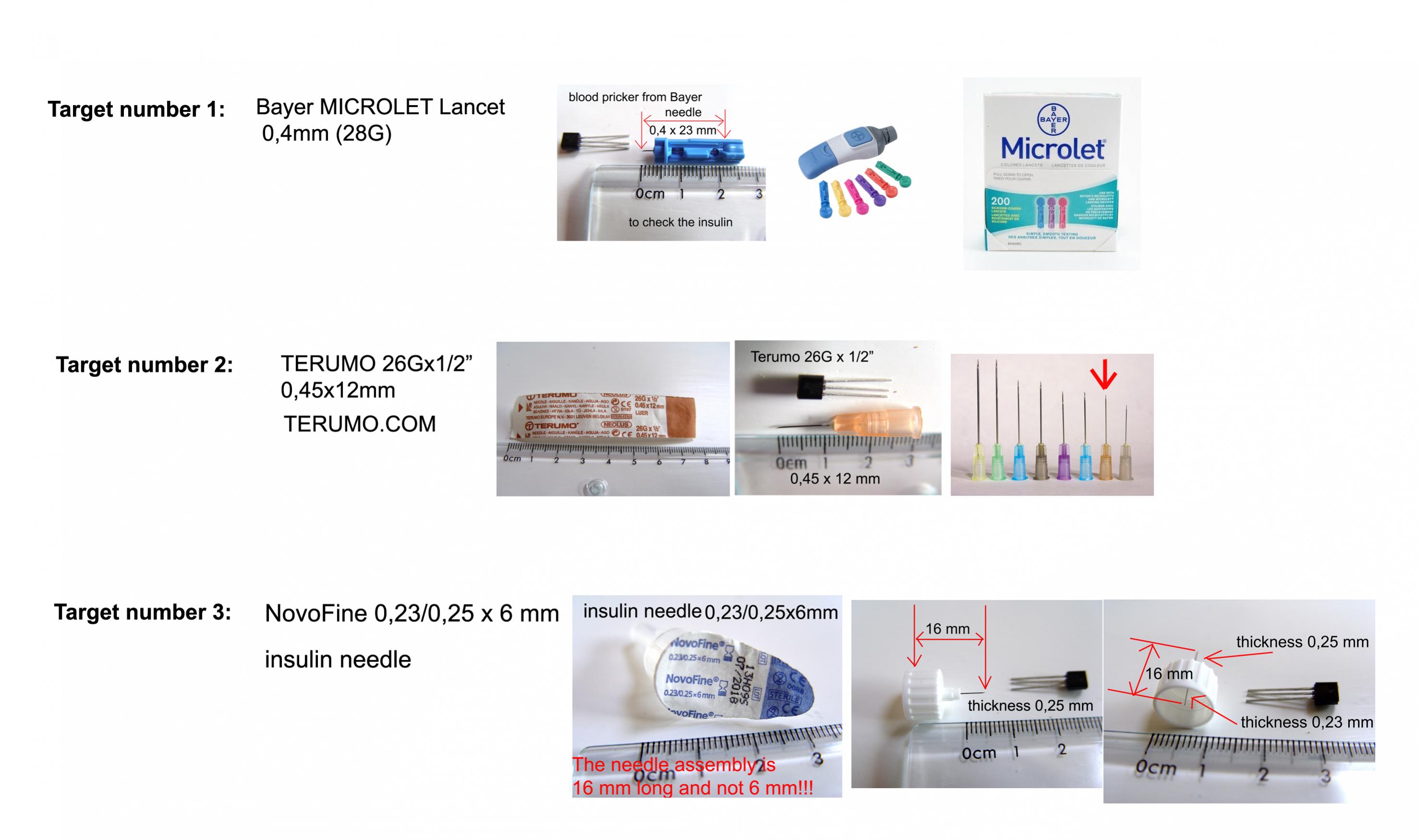

                        These are the test samples for the MD test.
                        The used metal detector that I used for the test is, by myself, modified DeepTech Smart (IB) detector with aelliptical 11" frequency is 15-Khz I thought
                        I want to report some statements that some of us have said.
                        "Detecting small hypodermic needle using 11" coil with IB VLF detector (no matter of brand), we could really call a miracle.
                        Sorry, but I don't believe in such "miracle".
                        "A hypodermic needle could not be detected by a PI even when Eric Foster tried it with a 1us sample delay. The shape of the needle,
                        with its tiny cross-section, is unable to sustain eddy currents for long enough to be detectable. I would suggest that the only hope
                        of detecting these items is with a VLF running at a relatively high frequency...................."
                        "pi detectors with coil than 6 inches and inductance than 240mh - 300mh and sampling that 6us -21 us frequencies 1khz,
                        successfully can detected hypodermic micro"
                        Maybe these are already some discussion points.
                        The video comes tonight.
                        Nupi.

                              Thanks for good presentation of testing samples, nupi.
                              Blood pricker / insulin needles are out of my interest, but OK, if you chose: more - better.
                              My primary interest is testing chosen hypodermic needle:
                              NN-2613R
                              Brown
                              26Gx1/2”
                              0.45 x 12 mm
                              Regular wall
