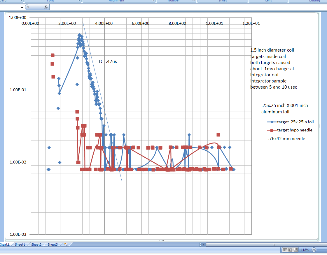

              Looked like a challenge. I plotted a .25 x .25 inch aluminum foil and a hypo needle that I have. I can see a change on the chart for the foil but not the needle. Both had a change of about 1 mv out of the integrator. Gain about 140. Had to put targets inside a 1.5 inch coil. Don't know why I see a change for foil but not the needle on the chart
