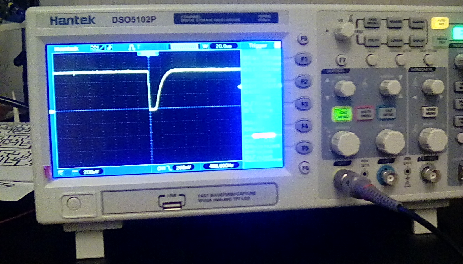

        • Signal in pin3 if poic controller looks good

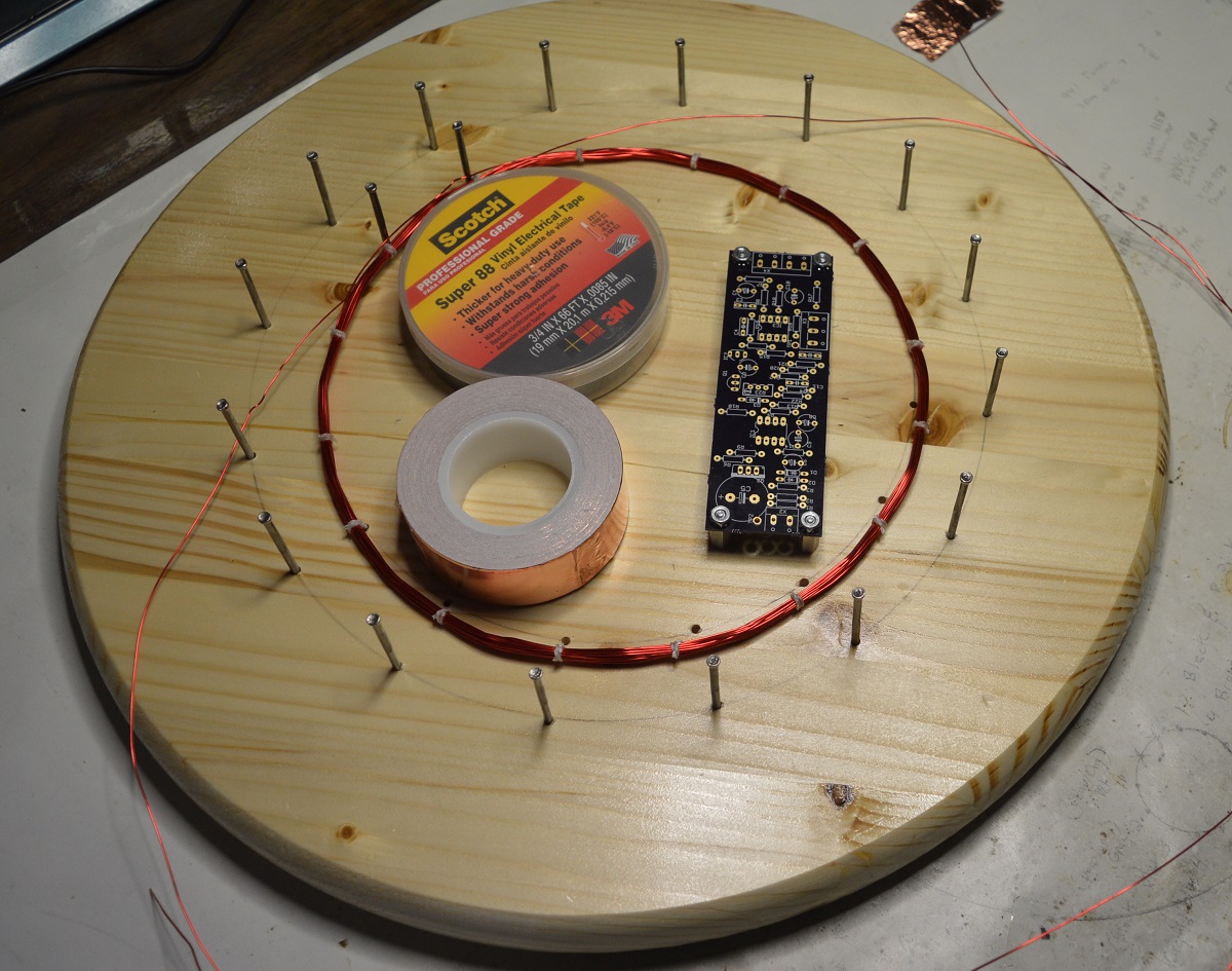

            • Here's a photo of my Pickini V3 project so far. The pcb looks nice and my 20cm coil measures at 344 uH.
              • please test first with unshielded coil and the with shielded and compare the differences
                i often made bad experience with heavy copper shield
                i hope all works and you can take your had off from the osh park pcb files
                would save me some time with self etching
