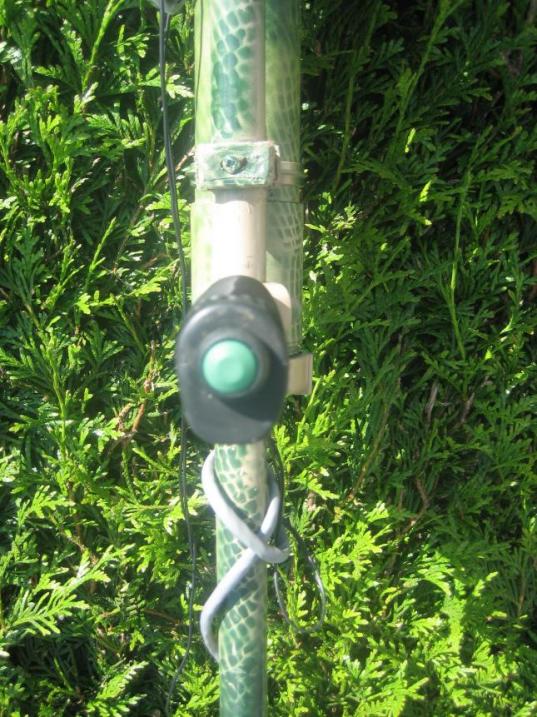

      Detail of the PP (non-motion) pushbutton embedded in the handle bar.
      Swing in motion mode until a target is detected. Keep the coil away from the target and push the pinpoint button.
      Hover over the target and a continuous signal will indicate the exact target location:
