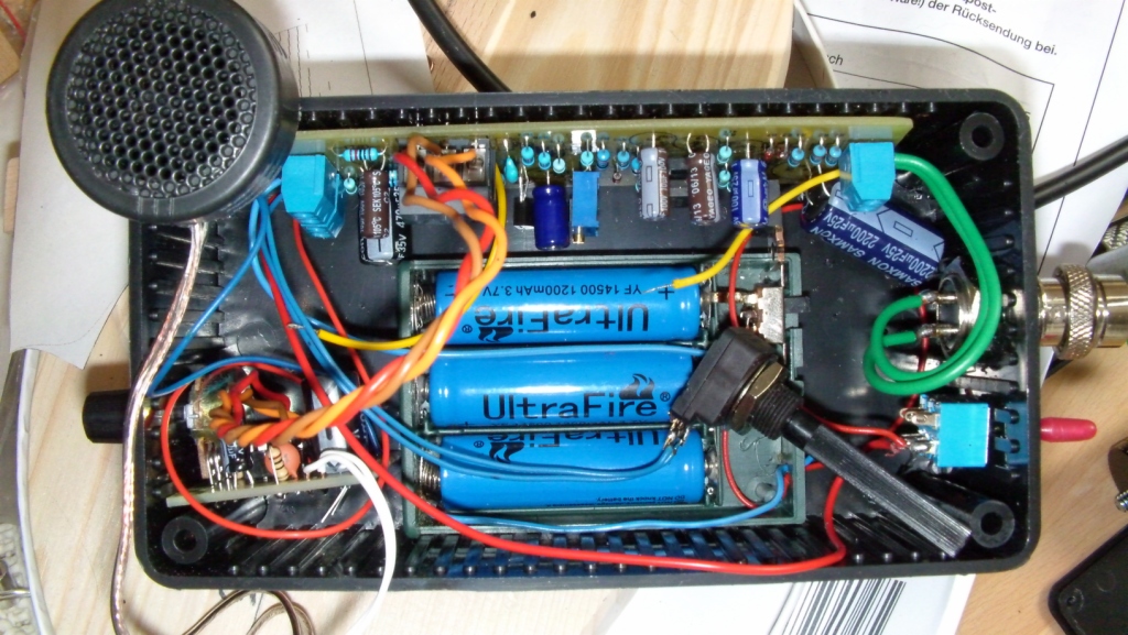

      my v3 works good now

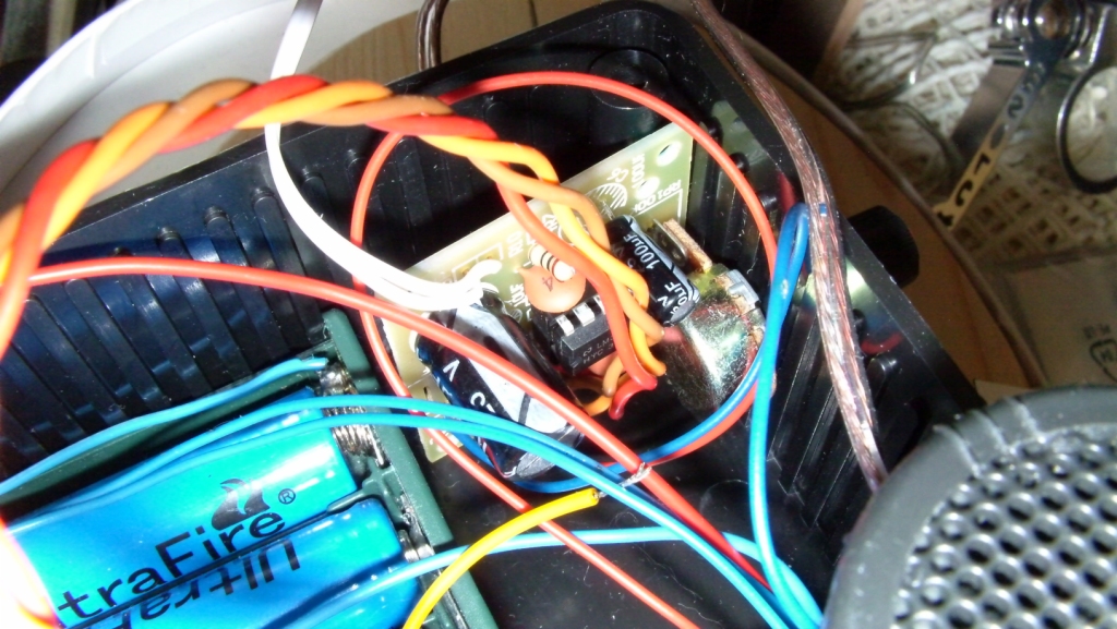

      i replaced the standard speaker i used before with a piezo speaker
      (v3->LM386 Amp with Gain 20 -> Strong Piezo Speaker up to 12V)
      btw: is it normal that it takes around a minute or more that the detector reaches the full performace
      or did i take some wrong temperature sensible parts?
      the next think i hope is that more will do the new version so that we can compare the results

                  hey bernard
                  thanks for the info
                  i use them http://www.ebay.de/itm/5pcs-LM386-Su...item3a90f1d371
                  but use only minimal setup with gain of 20 instead of 200
                  it is so that my v3 is not sensible/ deep like the v2
                  but it is very easy to build (low part count,low cost, low time)
                  and in relation to simplicity it performs well
                  powersource are 3 cells 14500 3,7V (trustfire,ultrafire..) with a triple battery holder or external case with switch

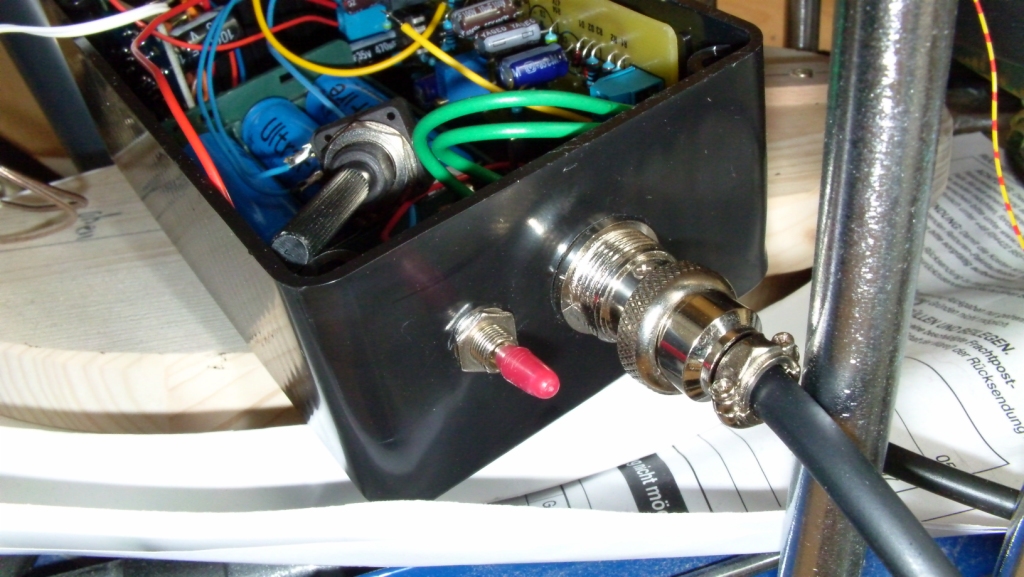

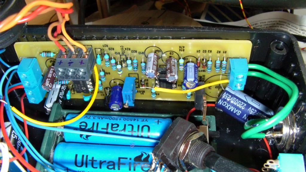

                      here are the latest pictures
                      pickini v3
                      lm 386 amp
                      14500 power source
                        Best regards,
                        - Bernard
