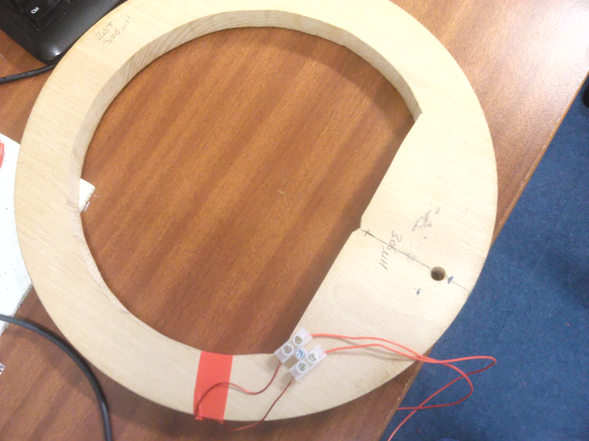

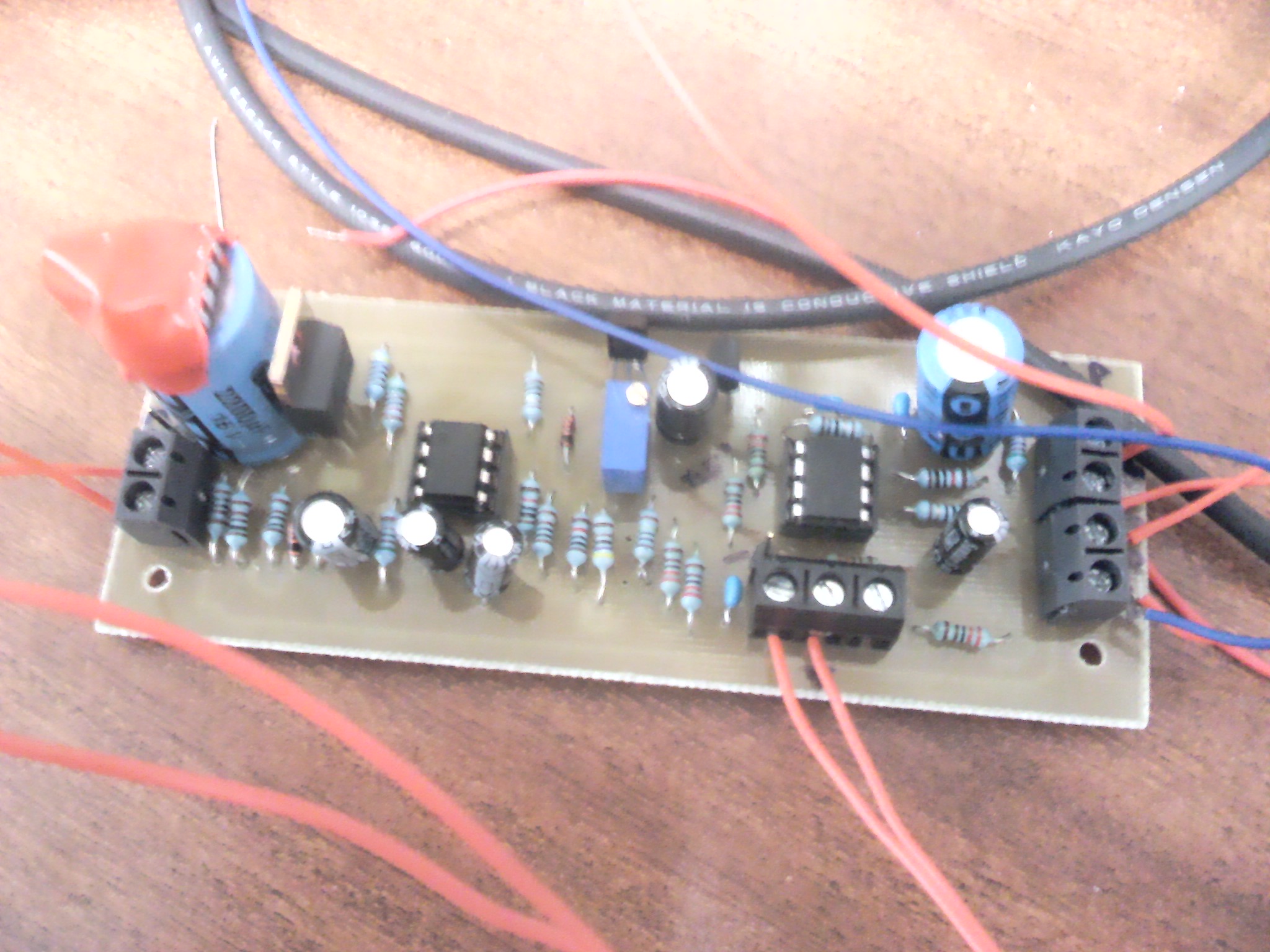

                    I've decided to build one of these too and have the PCB all working as it should, 5.3 V on pin 3 of the PIC.
                    After a few seconds (DC voltage stabilising, I'm guessing), during which time it clicks softly every second, current consumption increases to 160mA (from around 16mA on start-up) and it starts to bleep rapidly as if detecting metal close by, when there is none.
                    I have not foil-wrapped the coil yet (306 uH, 26 cm diameter, ~20 turns), would that cause the constant bleeping?
                    I've also dropped the voltage gradually down to 5V and it loses the return pulse at around 8V (audible warning) but I do not get a low voltage warning.
                            In Your film, supply voltage=12V and current = 120mA seems normal.
                            When you want a power supply range of eg 11-14V, adjust the 5V at pin 3 of the microcontroller with a power supply of 13.5V. This way, it will remain stable when the voltage drops.
                            When you do the opposite: adjust the 5V at 11V, it will become unstable when you crank up the voltage to 14V.
                            The voltage divider at the virtual ground opamp input takes some time to stabilize when you change the supply voltage quickly.
                            So: adjust the 5V at pin 3 with the power supply at 13.5 / 14V.
                            Coil looks OK. For testing it doesn't matter if the coil is shielded or not. You will experience false signals when touching the ground with an unshielded coil in the field / on the beach.
                            The low voltage audio detection has a delay of about 25s and will be repeated once every 25s. This allows you to keep searching even when the battery goes low.
                            PS: what is that red thing on top of the large tank capacitor (2200 microFarad) ?

                              • #45
                                hi been there uk, your coil connector could cause falses, i used those block connectors on the first pi coil i made, and it detected it, it falsed like hell, when i removed it and soldered the wires it stopped, i dont know if it detects the brass or the steel screw but my first pi saw it.
