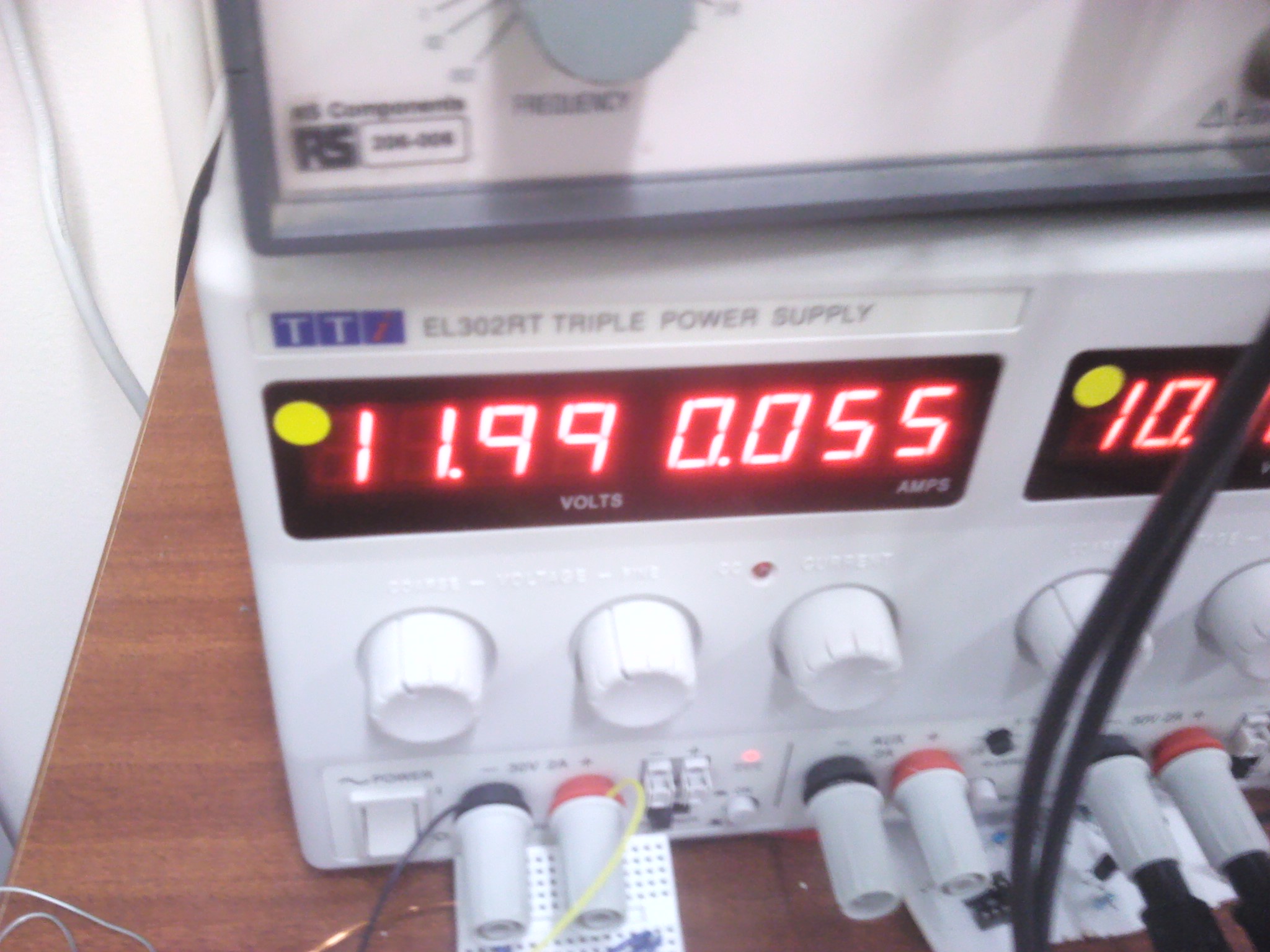

        Just adding something to this. Having spent too much time trying to get this to work using a 330 uH coil with 20 T and failed because it kept becoming unstable, I have now gone up to 550 uH with 42 turns of 0.8 mm wire (R=1.4 ohm, 25 cm diameter). Current consumption now is between 55 and 75 mA and the circuit is stable.
        Range in air to £1 UK coin is 20 cm.

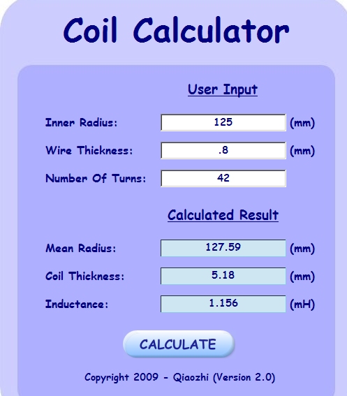

          Thanks for the info with the cool, but are You sure you habe 550µh with 42 turns?
          • #65
            Calcs way bigger than 550uH.
            • #66

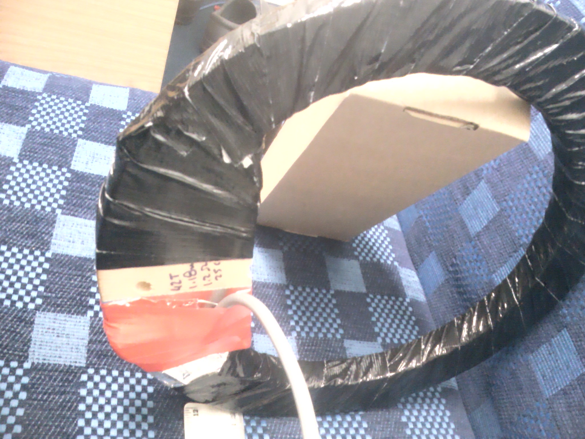

              OOps, yes you are right, it is almost exactly twice the 550u value at 1.18 mH - I must have quoted the value for one of the other coils I tried (tried many...) now remeasured using this: http://uk.farnell.com/jsp/displayPro...FQgYwwodTVoA4w
              Everything else is the same. I've now hot glued it into its wooden base and will foil wrap and seal it the best I can. The lower running current means the MOSFET barely gets warm now and batteries should last longer.

                  I'll record a video of it all next week - just finished the coil (grooved wooden base, coil, hot glue to keep it in its groove, aluminium wrap and gaffa tape - not 100% waterproof but will do for my first proper coil).

                    Foil wrapping the coil seems to have cost me 5 cm in range to the £1 coin, making me wonder if it is worth it.
                    I just videoed it detecting the pound at between 13 and 15 cm. It used to pick it up at 20 cm. I'll try making other coils for it too.

                        I made another coil (44 T, 880 uH, 2 ohms, 20 cm) from plastic coated 0.6 mm wire and just wrapped a few turns of earthed wire around it and that brought the range back up to around 18 cm. I'll post the video for that later too.
                        • #72
                          The videos screwed up (no sound) so will do them again tomorrow with another camera. I have some pics for now.

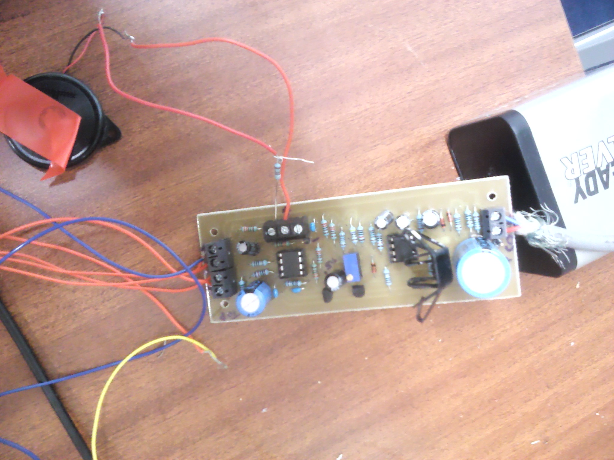

                              Some minor mods to improve stability (it seemed that the op-amp's bias was affected by the MOSFET current pulse):
                              Make R10 47 Ohms instead of 10 ohms.
                              Add 100 nF capacitor from opamp pin 3 to ground.
                              Add 100 nF capacitor from opamp pin 8 to ground. I used ceramic.
                              Pulse width into pin 3 of the microcontroller using the 44 turn, 20 cm coil is 45 uS max.
                              Consistently getting 20 cm to a £ coin so I think I will make a 30 cm coil.
