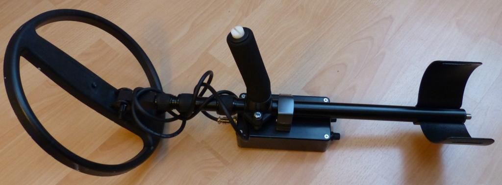

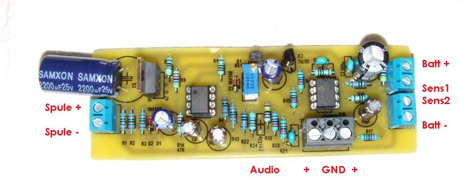

            • #96
              hello nick
              please post the board layout you have used
              remind that you have spotted two errors in the layout you send me a while ago
              i have the version 3, and it works
Name:	DVCI0165 anschluss.jpg

                • #98
                  hello nick
                  [ATTACH]32019[/ATTACH]
                  [ATTACH]32020[/ATTACH]
                  Wow! what a beautiful machine!
                  Congrats Bernard!

                        • hi F117, thanks for sharing ur project, i had tried to build the circuit, however, i can only able to get initial sound, but after that, the respond only in coil error sound.. tried to use the coil built for the previous version by another friend, but still it doesn't work, any idea what's the problem is? Thanks in advance =)
                          • Originally posted by tclow View Post
                            When you get the coil error sound, this means that there is no flyback pulse detected. Either there is no coil current - check the connections and pulse to the gate of the MOSFET, or the coil itself is not good (short circuit, not connected, .. ). Check and clean the board solderings around the pulse coming from the microcontroller to the BS170 to the gate of MOSFET carefully. Measure your coil with an ohm meter. It should not be zero ohms, but a little higher. If you have an oscilloscope, check the pulse going to the MOSFET gate.
                            • apparently I connected MOSFET's D and S leg inversely.. ><
                              however, still the same problem after i made it right..
                              another thing is pin 3 of PIC is just fixed at 5 V, any adjustment to R23 jst doesn't make any changes, would it be the root of the problem?
                              • Does the voltage at pin 6 of the opamp change when you adjust R23 ?
                                Do you have VCC/2 at pin 1 of the opamp ?
                                Does the output of the opamp - pin 7 - change in DC when adjusting R23 ?
                                Check these first.
                                Success!
                                - Bernard
