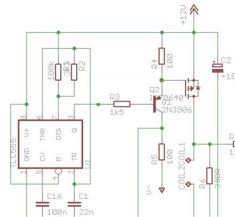

      Ah hold off with that a moment I need to check the FETs gate voltage specs I didn't realise Q1 was sitting between 12v and -5V

        Ah I see something which maybe contributing to the problem. Not all varieties of 555 have enough current sinking ability certainly not enough to charge a high side PFET arrangement like this.
        Try connecting the gate of Q2 the PFET to the emitter of Q1. The bipolar variety of 555 may drive this circuit but it will use far more current.
        This should turn the FET off much faster and not impede the decay. It will either way eliminate the device from the investigation.

        Is this what you are suggesting?

          Unfortunately that gate mod wont work unless you change R4 to 1k and then I'm not sure what it would do to your clock.
          So if you've used a TLC555 timer it has a sinking value of 0.1A so it wont likely be your problem. Check the datasheet for the device you've used, because I know some can only sink a few 10s of mA
          Wouldn't hurt scoping the gate of the FET and making sure you've got a nice square wave especially at TX end, then if alls good you can concentrate elsewhere.

              Oh public shame....Sorry I always get my P and N Fets mixed up, and I'm usually so obsessed with turn on times and not off which in PI is the most critical anyway.
              OK switching OFF the coil we need to drive the FET high, so it's drive strength of the 555 that's important in this case not sinking, the TLC555 appears to provide 10mA.
              It may need a bit of help from a pullup resistor on that gate, or the bi-polar 555 variety (i.e. NE555) which will provide up to a quarter Amp. That is off course if your waveform is drooping.
              Usually you would drive it off with a transistor to ensure a very quick gate discharge and turn-off time.
              Maybe someone else has spotted what I'm missing and will provide you with some real insight.

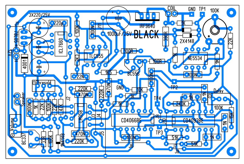

                Is this the PCB you used?
                Seems like this a workable design, people are reporting good results so I guess most of the above is barking at the wrong tree.
                Sorry I stick to very narrow field in the forums, and didn't know much of the surf, but couldn't resist a plea for help.
                It means then there must be a faulty component somewhere.
                At least we can be pretty certain that it's before or is the preamp.
                Did you follow the BOM closely as far as parts are concerned?

                  This unit is Silverdog's "long board", which I bought as a kit (http://www.silverdog.co.uk/shop/inde...&product_id=76). Here is the BOM - partslist.txt

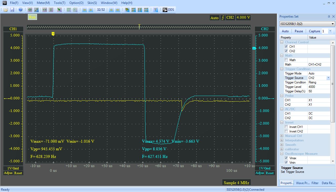

                    I think that I am making progress. I think that this is closer to what your describing Kev - Click image for larger version
Name:	Better damped.JPG

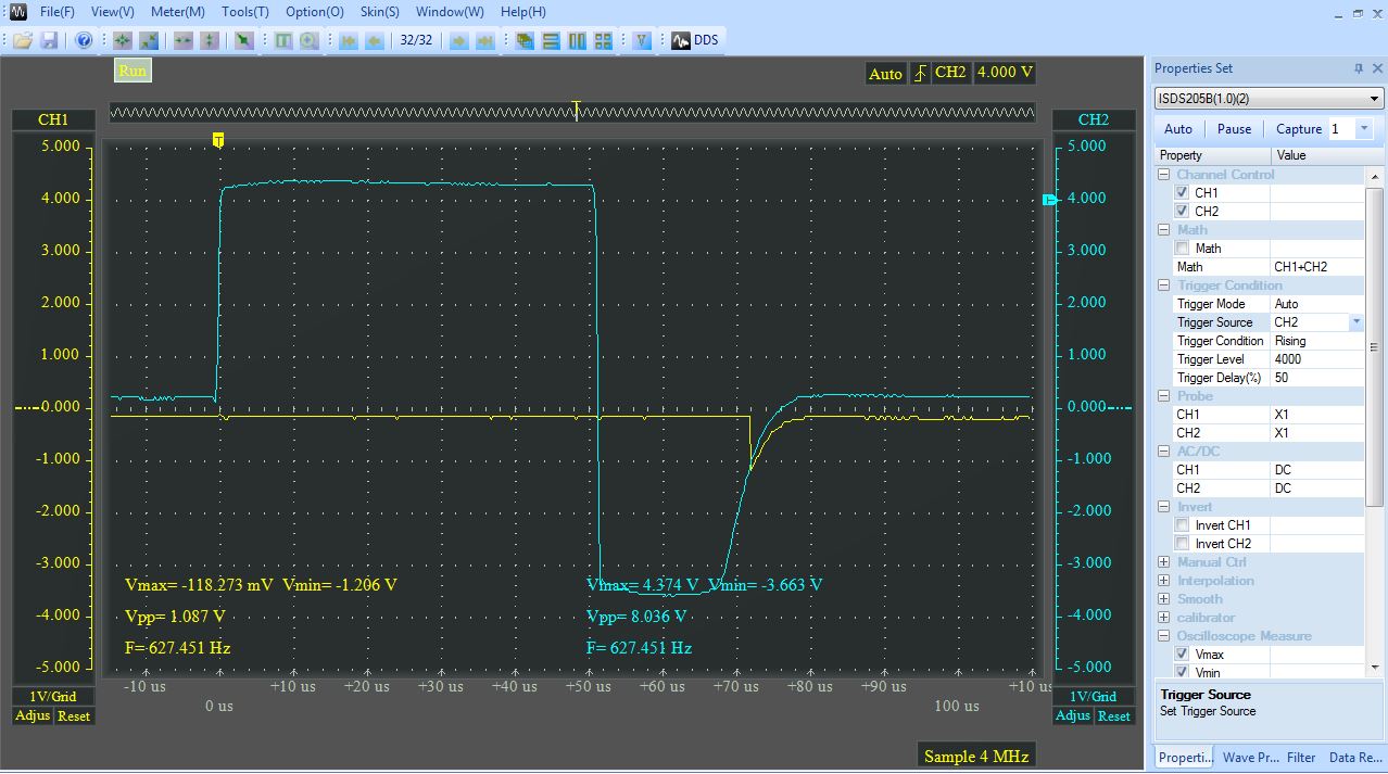

ID:	341286. This was the result of increasing the damping resistor from 390 ohms to 530 ohms. Here is the result with 820 ohms - Click image for larger version
Name:	820 Ohms Damping Resistor.JPG
ID:	341287. What should the critically damped pulse look like? How do I know when it is under/over-damped?

                      Yes that looks much better, but it needs to be better still to be super sensitive. If you attach the trimmer as mentioned above, you should see the waveform begin to "ring" as you increase the resistance, you need to halt it just before ringing. But this will only apply to the coil you have on, so all other coils attached must have the exact same parameters to also be critically damped.
                      However I would've thought that with the improvement you have gained thus far you would've seen a correspondingly improved detection range over initial.
                      You're using a kit that should "work" straight off, so if you made a coil according to the specs, the 390R resistor should damp that decay curve smartly, but previously we saw it was way overloaded.
                      So there is definitely something fishy about the frontend, but it appears that you may well have another problem elsewhere in the circuit.

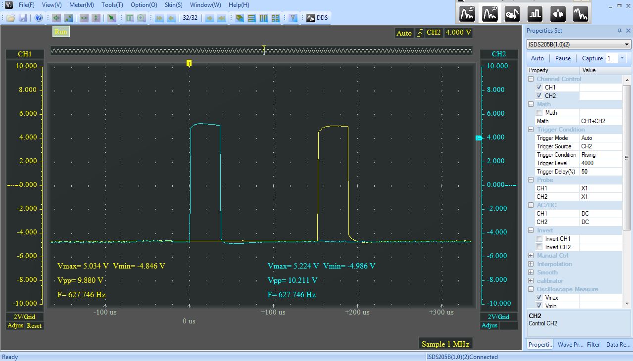

                        I'm curious to see u7 pin5 on one channel and pin13 on the other?

                          Here is the screenshot of U7, Pins 5 & 13 - Click image for larger version
