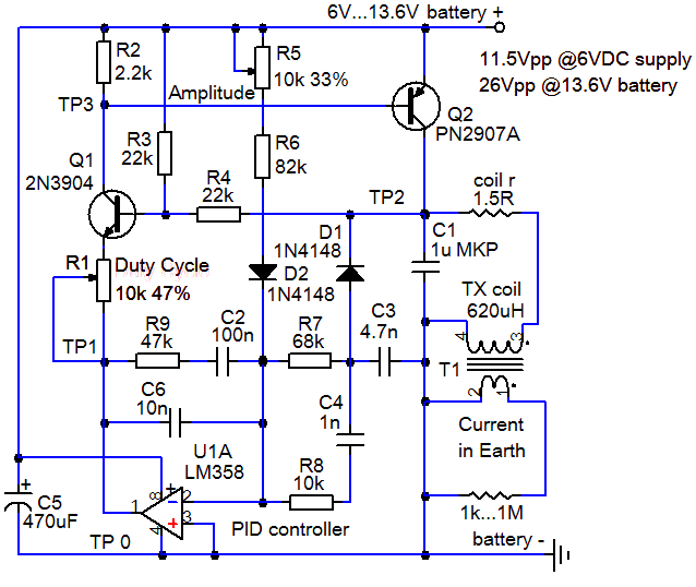

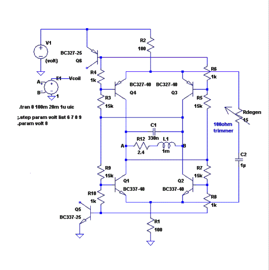

    I made this PID transmitter just to see what it would do.
Name:	Universal VLF TX.GIF
    Using it on my Minelab TX coil at 1.18 uh (2.5 ohms) I got the following results;
    Using 9V ps
    1 uf cap
    4.6 khz
    22.2v P/P
    19 ma!
    0.47 uf
    6.7 khz
    25v P/P
    0.22 uf
    10.1 khz
    26.4v P/P
    0.1 uf
    14.5 khz
    28.9v P/P
    11.3 ma
    I'm not sure it was working correct (I just made it!) as the Amplitude adjustment
    did not do anything. I could adjust the duty cycle and get crazy voltages (46v!)
    but the coil started buzzing and current shot up higher than my meter could measure
    (24 ma).
    It might be worth a try on TGSL to see if any depth is gained but it does use a lot
    of current. The H Bridge or AB/C Minelab oscillator might be a better choice...

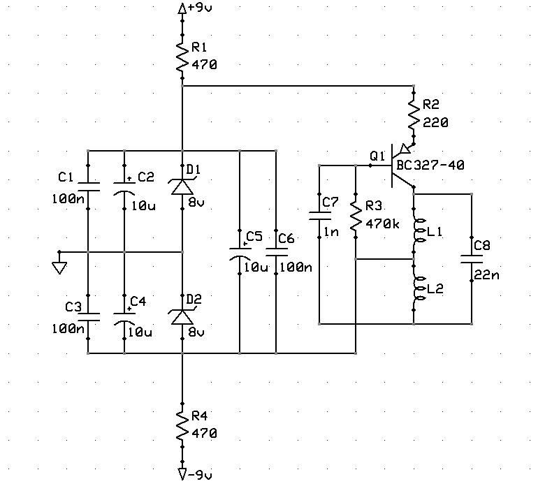

    I might try this one next. Aziz designed it. It's simple and supposedly puts a lot of
    current into the coil but doesn't use much juice. You do need a center tapped TX
    coil though so it's not for everyone...
    So I wired up the AzizTX oscillator using 7.5v zeners and +-9V supplies and
    with the Deep Search Tesoro coil (6.1mh CT) I get;
    14.2 Khz
    27V P/P
    +- 4.8ma
    That's close to 10 ma! I thought he said 2ma. Oh well the search goes on.

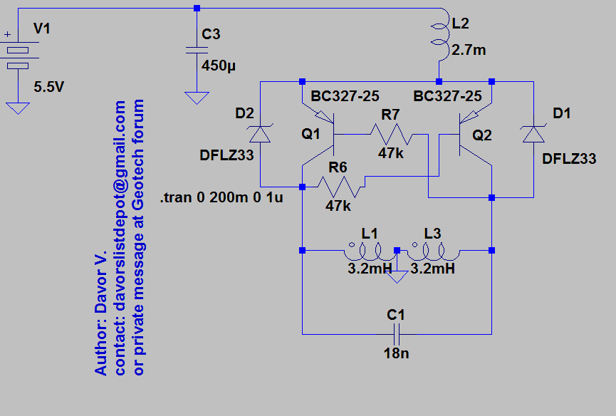

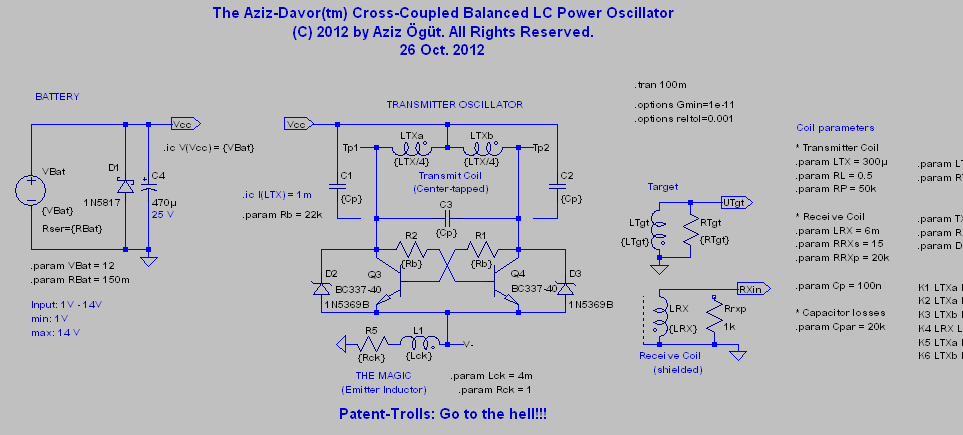

    I'm going to try his magic inductor oscillator. I found a 2.6mh inductor today
    to make the magic. Here's the schematic;
    Here's the thread where I found it;
    http://www.geotech1.com/forums/showt...ht=balanced+tx
    I couldn't find 51v zeners to protect the transistors but found 33v ones and some high voltage
    transistors, I'm not sure if they are high beta though. They are FMMT597 and FMMT497 (hfe 100 to 300)
      Efficiency can depend on coil resistance and cap ESR.

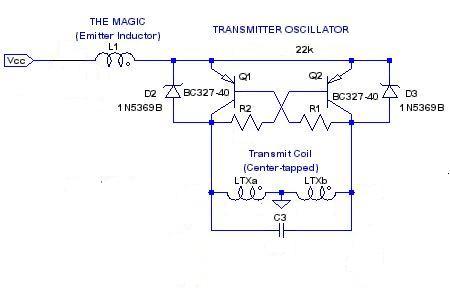

        So I made this version of the magic oscillator;
        Some preliminary results using the centertapped RX of my Deep Search coil
        (6.1mh) with R1 + R2 = 22k
        and C3 = 47n
        10 khz
        33v P/P
        9.8 ma input current
        Not sure how much current is in the coil
        With C3 = 22n
        14.2 khz
        33v P/P
        6.6 ma input current
        These were all using 9v input power
        I'd like to get current draw down to 4 ma
        maybe try 47k for R1 + R2?
        And I want to try it on my Fisher 440 coil
        as that's the one I will need a CT oscillator for.
        The sims show 14.5khz and 4 - 5 ma in
        for +_27v P/P and 50 ma in the coil.
          I was not able to find a way to stabilise this oscillator and I can't recommend it for any serious development. In most "normal" oscillators a cyclostationary operation is achieved when oscillation hits the transistors' saturation regime. Such oscillators' amplitudes are locked to the Vcc and thus very stable. Noise performance of such oscillators is ~ equal to the power supply noise, and that means you should keep Tx supply rails as quiet as possible.
          There are also oscillators with active amplitude control with various PID regulators. I'm not fond of such solutions as they are much more complicated, and if any kind of integration is introduced in a PID regulator, your envelope loses stability. Problem is with a tank Q factor that introduces group delay in the envelope response (integrator) and two integrators in a same loop = oscillator. If you lose integrator in a regulation loop, what you get is equivalent of a rail limited oscillator, only running at some peak voltage that is lower than the rail. What goes around ...
          Amplitude stability is of great importance with VLF detectors as the air signal creeps into the Rx, and its amplitude modulation component translates to chatters. For that reason it is also good to limit 1/f noise of the very Tx transistors, and the only way to do it properly is to introduce some small emitter degeneration resistor. 10ohms is fine.
          IMHO rising amplitude by "magic choke" is not a very good idea.
          A solution with Colpitts configuration is a bit more sensible, as long as the Q factor is high and the oscillation tethers to Vcc.
          The approach that makes sense to me would be going way below 1mH with total Tx inductance while keeping a tank Q high, and some AB->C class mechanism to further reduce power consumption and harmonics. A proper way to do it would be using a stranded or Litz wire to reduce eddy currents in a cross section of a Tx coil, as it becomes quite thick. You can achieve some serious ampereturns this way, while supply current remains low. The remaining problem could be current that flows through a connecting cable, so a meaningful coil embodiment would include a tank capacitor as well.

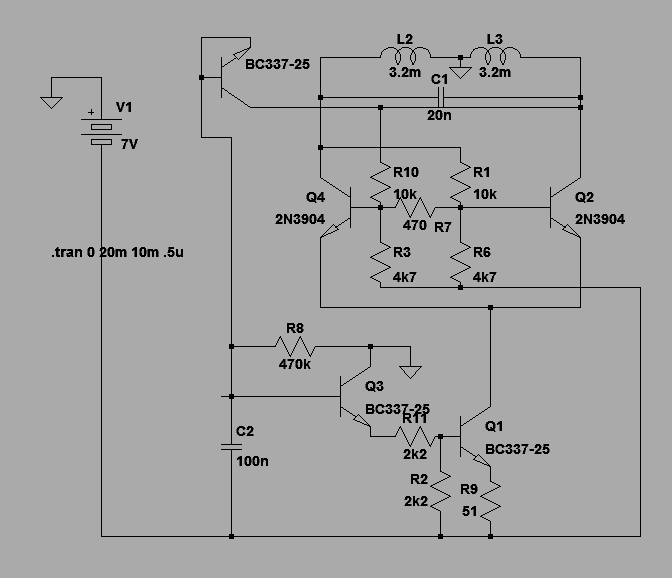

            Hi Davor, Thanks for the input. I'm looking for an oscillator to drive my new Fisher 440
            coil. It uses a 12.6 mh center tapped TX. Is there a way to use this oscillator with a
            centertapped coil (maybe by grounding the center?)?

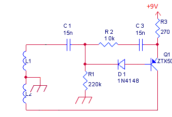

                So I tried the oscillator from the Fisher 440 as the coil was meant for that MD.
                Here's the Schematic;
                The sim said 14 khz with 4ma current draw. I read;
                10 khz
                4.5 ma
                17.8v P/P
                Using 9v for power.
                I read this from one side to ground (-7v in schematic)
                The problem with this oscillator is it runs from the minus
                supply to get the center tap to ground. I'm not sure my minus
                supply can give 4.5 ma to run it...
                  You can reverse it by simply replacing all NPN transistors with PNP and vice versa, and simply turn the supply opposite. Easy peasy.
                    Well the 440 Oscillator tuned to 14.9khz via a 6.8n cap gives
                    14.9khz
                    33v P/P
                    Input 3.8 ma at 9V
                    24ma per side in the coil (50ma total)
                    I went back and tried the Magic oscillator
                    with 9V in and 18n
                    15khz
                    32v per side (64V P/P!)
                    6.5 ma in
                    98 ma in coil (1 side!)
                    I adjusted the input to get around 4 ma and got
                    5.5V in
                    4.1 ma in
                    61 ma per side in coil
                    20v per side
                    15khz
                    Picture of current config;
                    So this one looks very efficient. Not sure how much
                    amplitude jitter there is. The waveform in sim looks poor
                    but on the scope it looks fine. I have some MAX667's so
                    I will use one in variable mode for this TX so I can set the
                    amount of power for future experiments.
                    This is destine for an experimental rig so no biggy if it doesn't perform
                    well I'll just rip it out and try something else...

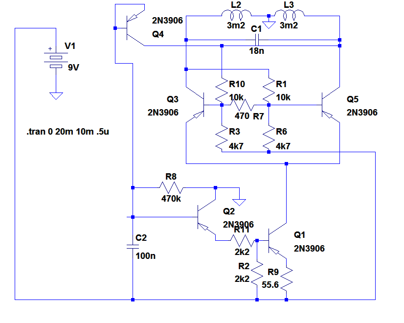

                      I think I need a more regulated solution so today I flipped the sex of all the transistors
                      in the 440 oscillator so I can run it off positive voltage. Here's the schematic;
                      For some reason I just swapped the transistors (though from BC337's to 2N4403's)
                      and the frequency changed from 14.9khz to 21 khz. Here's the data;
                      6.8n
                      21khz
                      34v P/P
                      4.3 ma in
                      8.2n
                      20.6 khz
                      34v P/P
                      4.3 ma in
                      15n
                      15.4 khz
                      33V P/P
                      4.8 ma in
                      18n
                      14.3 khz
                      33V P/P
                      5ma in
                      22n
                      13.6 khz
                      32V P/P
                      5.1 ma in
                      I kept the 15n and tried varying the power supply aiming to get 4ma draw.
                      with 7.48V in
                      15.5 khz
                      26V P/P
                      3.9 ma in
                      With 7V in
                      15.4 khz
                      24.8V P/P
                      3.7 ma
                      74 ma in the coil! (37ma per side)
                      I'm thinking of having 2 settings for power say 5v and 7v?
                      At 5V I estimate around 2.5 ma input current and 40 ma in the coil
                      so you'd have high power of 74 ma and low power of 40...

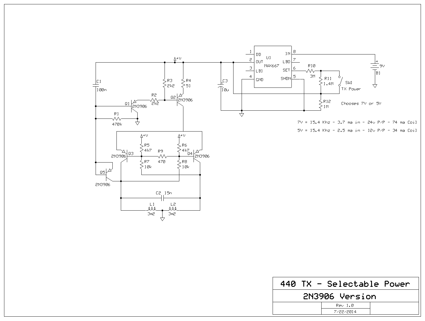

                        There are some odd connections in a swapped transistors version.
                          ? Should something change when used in this configuration?
                          Here's the schematic for the power selectable version. I'm not sure if the Max667
                          is readily available, I found some languishing in an old parts bin...

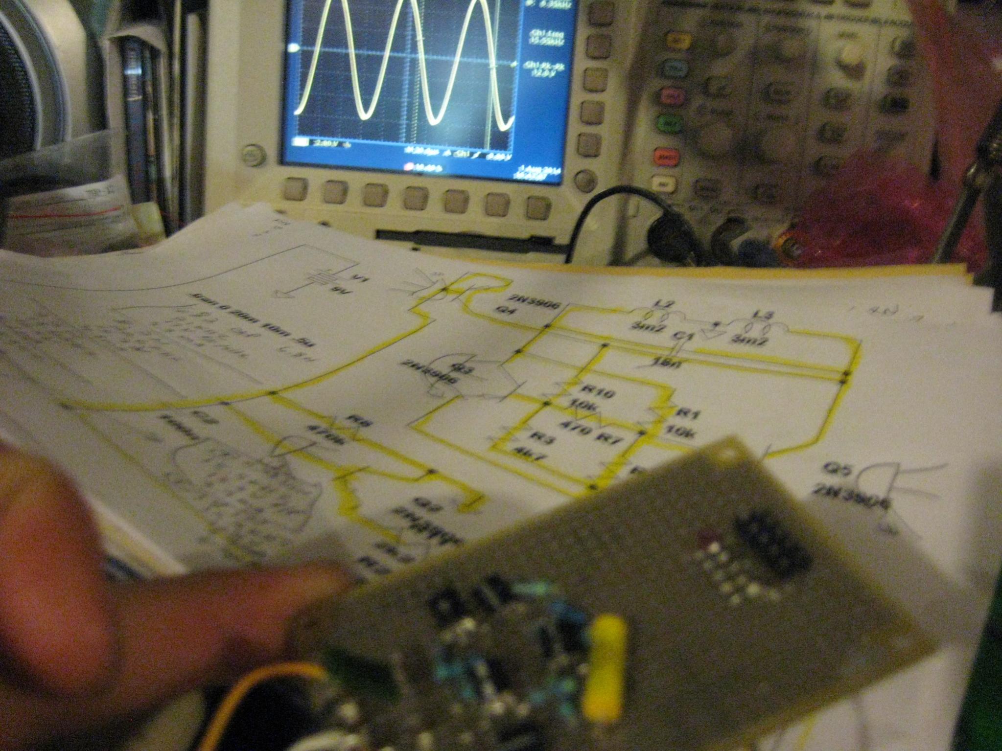

                            I think I found what I was missing. Silly me. Do you have this circuit in spice?
                              Here you go;
                              And a picture;
