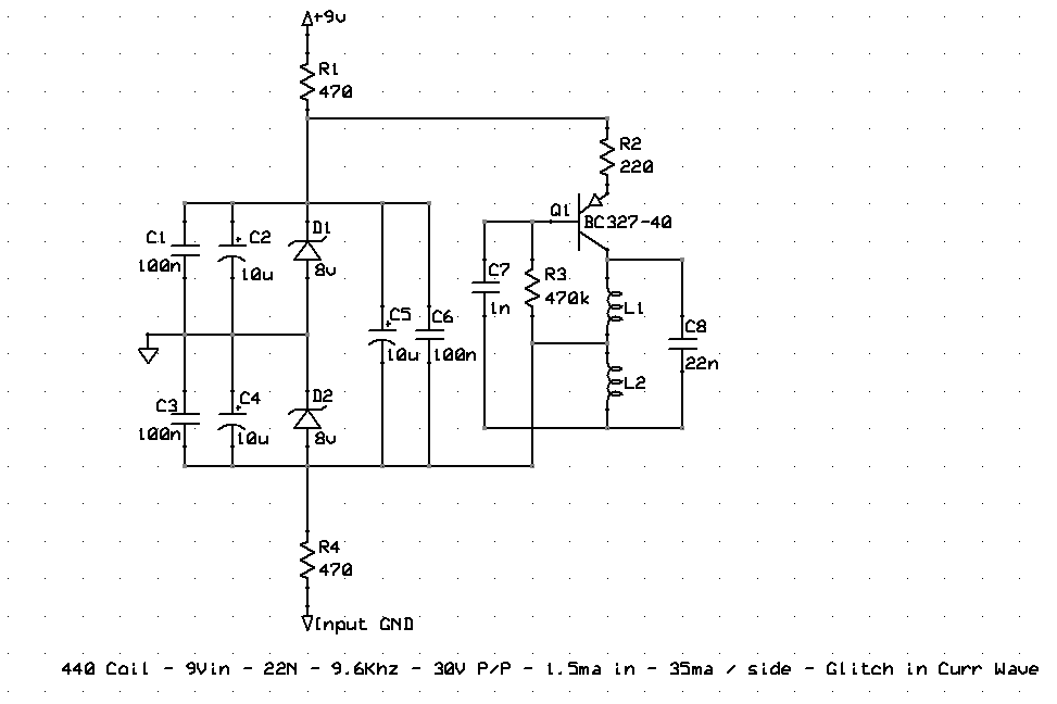

            I retested the Aziz oscillator which I had rejected due to excessive current draw
            and found I was powering it wrong. It was drawing 5ma from the positive and negative
            supplies but I think it was meant to float between the power rails and not run from +-V.
            So I applied +9v and ground to the power pins letting the gnd find itself and Voila!

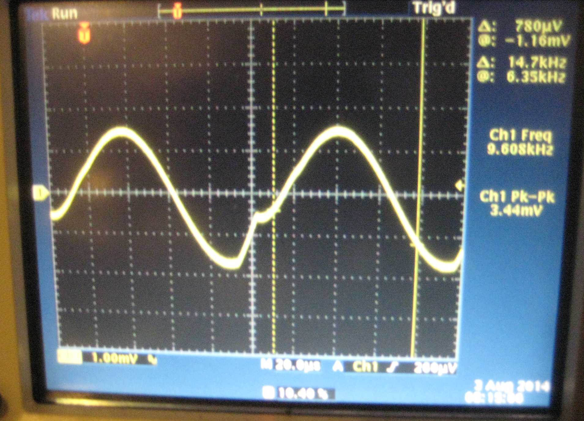

            440 coil 9V in
            1.5ma in
            30v P/P
            35ma per side in the coil!
            Though there was a glitch in the current waveform not sure if it will be a problem.
            Here's a picture from my current probe. It's 10ma per mv...

            Also not sure about ground referencing on this design.
            Here's the new drawing;
              If the frequency gets severely dragged by bias or supply changes, yes it may be a problem. With a better Q you'd most probably miss it.
