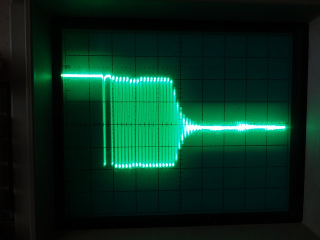

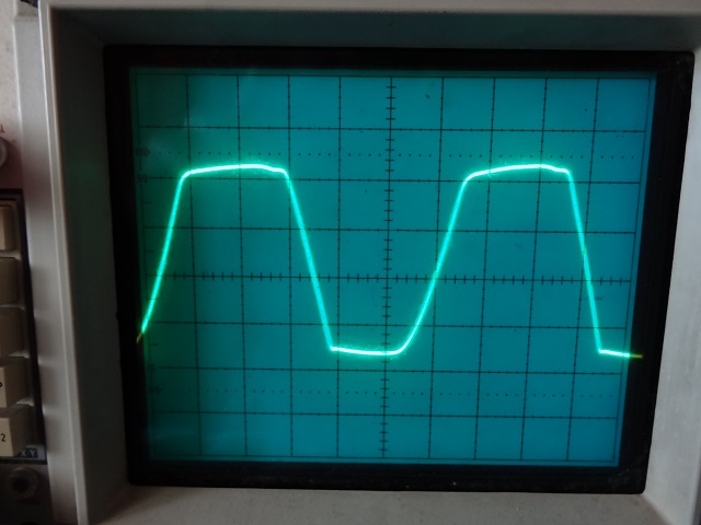

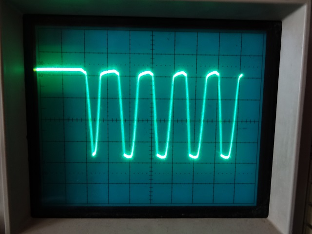

            I have meassured my coil how baum7154 has discribed it. Don“t know, if all is right. Here are some pictures.First with 20uS, second with 2uS and third with 0.5uS (5us with X10 on oszilloskope). So i have around 377kHz SRF. Could this be?
            It is a simple coil AWG24 stranded wire (PVC isolated) 295 uH, 1,8 Ohm, shielded with coppertape.

              This looks more like a MOSFET sustaining some kind of relaxation oscillation. Could you see what happens at a MOSFET gate?

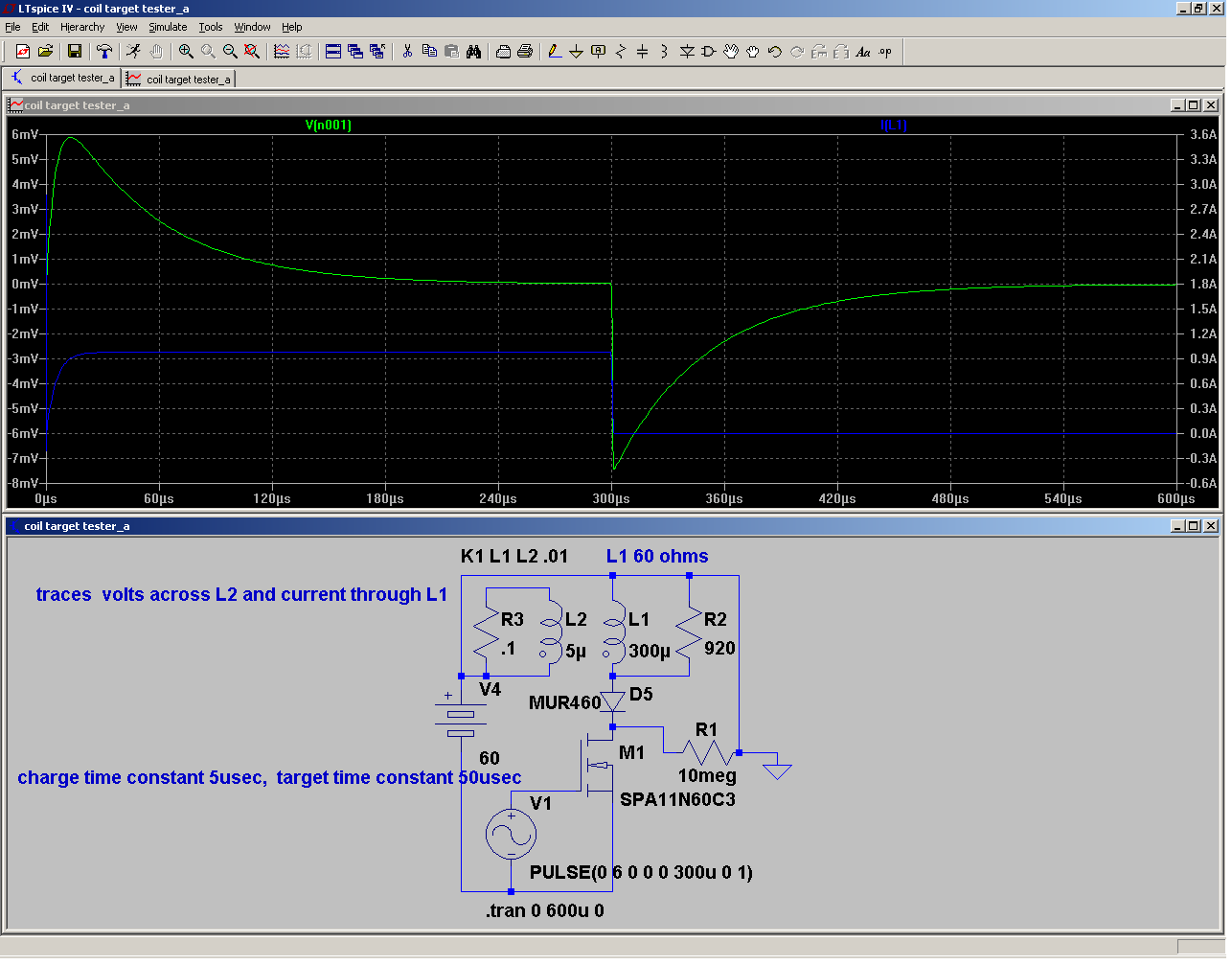

                    Originally posted by deemon View Post
                    In such a condition the current will grow very rapidly and then reach its maximum ( steady state ) very fast - in a few microseconds , for example ... and what we should find if we try this coil with the target that has a relatively large TC ( 50 microseconds , for example ) ? We'd notice that although the current becomes constant very early - we are still having more and more signal from the target when we increasing the ON pulse duration .... so the only explanation I can give is that we need some time to charge our target in order to get a maximum signal from it . And if we make the ON pulse duration longer than (2-3)*target TC , we'll notice that the target signal stops rising , so we can say that the target is "charged" ( or magnetized ) enough , and we don't need to spend more power .
                    Have you confirmed this with a practical experiment?

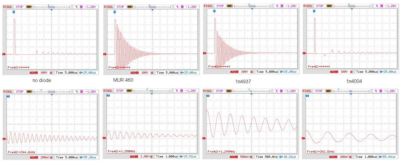

                      Some traces I posted in another thread awhile back. The first is without a diode in series with the coil. The next three are with different diodes in series. I think the coil was 280uh. The 344 khz without the diode is close to what you got. Looking at the upper trace it looks kike I had the scope probe on the coil, 450 volt flyback. The lower traces are are the ringing at a lower volt setting.

                        LTspice simulation. I think I did it right. The output signal is the difference of the charge and discharge signal. Once the charge reaches zero the discharge stays the same. Would you expect it to be different with ferrous or non-ferrous?

                          It is difficult but looking at the ringing portion of the scope screen shot at 20us /division, and assuming 7 cycles in 20us I get a ringing frequency of about 350 kHz. Your construction details of 24 awg wire with PVC insulation and a copper shield, plus the capacitance of the detector electronics i.e. mosfet etc. make it very possible that 350kHz is your true IN CIRCUIT ringing frequency. 24 awg wire will have more capacitance than smaller gauges, PVC has more capacitance than PTFE/TEFLON insulation and a solid copper shield contributes more capacitance than no shield or a more sparse shield. This all adds up to a slow coil. Another question is how much space is there between the coil and the shield and what is the spacer made of? Also if the coil has been flooded with epoxy between the windings the capacitance will be even higher, lowering the resonant frequency even more. I believe the coil is operating at about 350kHz.
                          Assuming the damping resistor was disconnected for this test...With 350kHz X PI X 295uh damping resistor should be about 324 ohms. In other words the coil appears to be under damped using a 390 ohm damping resistor.
