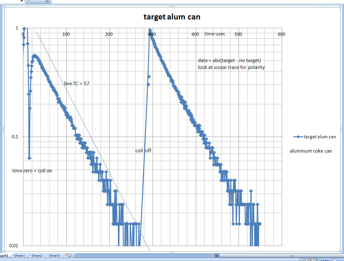

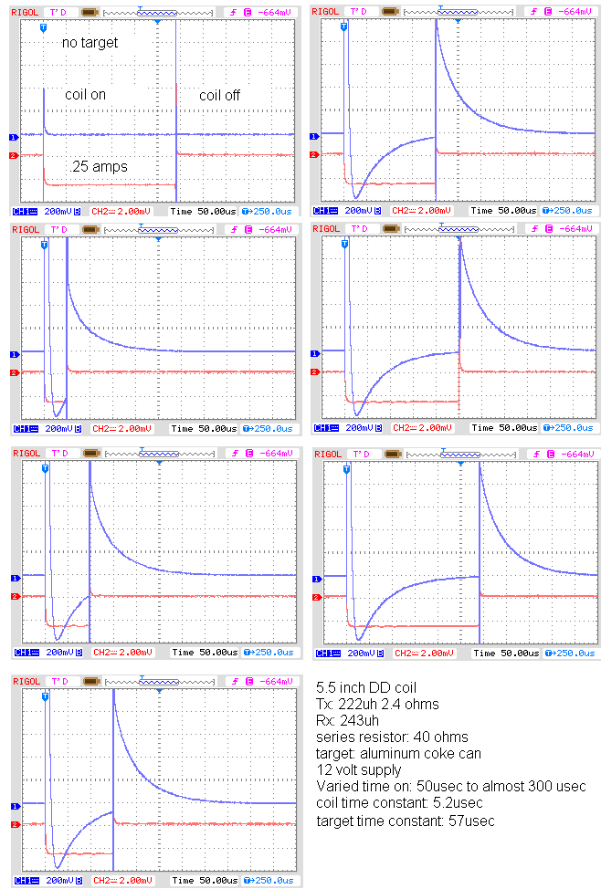

                Recorded some data with a DD coil. Coil TC 5.2usec, target TC 57usec. The excel chart shows the same TC decaying during the coil on and off times. Had to absolute value to plot log so you need to look at the third picture second row of the scope pictures for polarity. Other targets might show different results. I plan on looking at a couple targets. If anyone sees something I could do different or have a target suggestion I would try. I think it looks similar to the LT spice simulation except the signal goes positive the first few usec and then goes negative, opposite the coil off decay signal when the coil current flattens out.
                • #83

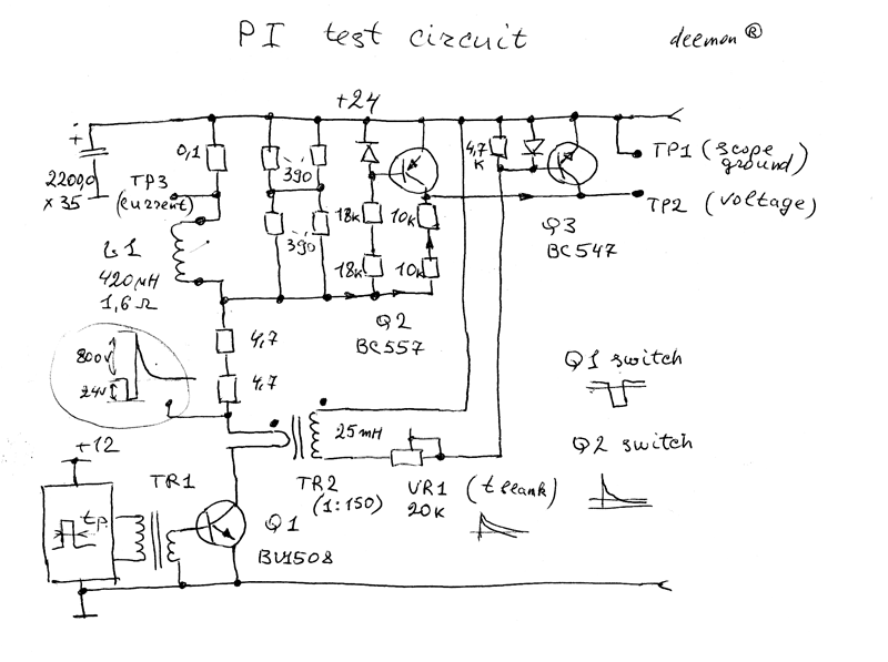

                  deemon - Can you explain what's happening with the receive signal? Previously you mentioned something about a transistor being used to clamp the coil after switch-off. I'd like to understand what's going on there, as it's difficult to interpret the RX images in the scope shots.
                    There are only 2 transistors in this front-end switch - one for negative spike suppression , and another for positive ... it's better to draw the circuit . Tomorrow I'll do .

                      Both TC's need to be considered. The TC of the coil and the TC of the target. In the case of the solid copper ashtray, the TC is probably 1000us or more.
                      When the Coil current has reached the flat top, the eddy currents in the ashtray keep increasing until the TX time has reached 5 TC's of the target.
                      After 5 TC's the target eddy currents start decaying because there is no more di/dt within the target. The decay will take another 5 TC's to reach near zero.
                      If you switch the TX OFF before that time, the di/dt of the switch OFF transient first has to kill the eddy currents in the target before it can build the new eddy currents which are of the opposite polarity, thus reducing the target response.
                                Here is the circuit - it's primitive . As I said before , here are 2 switches - Q2 shunts the output wire to the +24 V rail during the ON pulse ( negative ) , and Q3 does the same with the positive exponential flyback pulse . Duration of the flyback blanking interval I can set by the VR1 resistor , in order to allow signal transmission when our flyback pulse has been dissipated to near zero - so I can set the maximum scope sensitivity without input overload .
