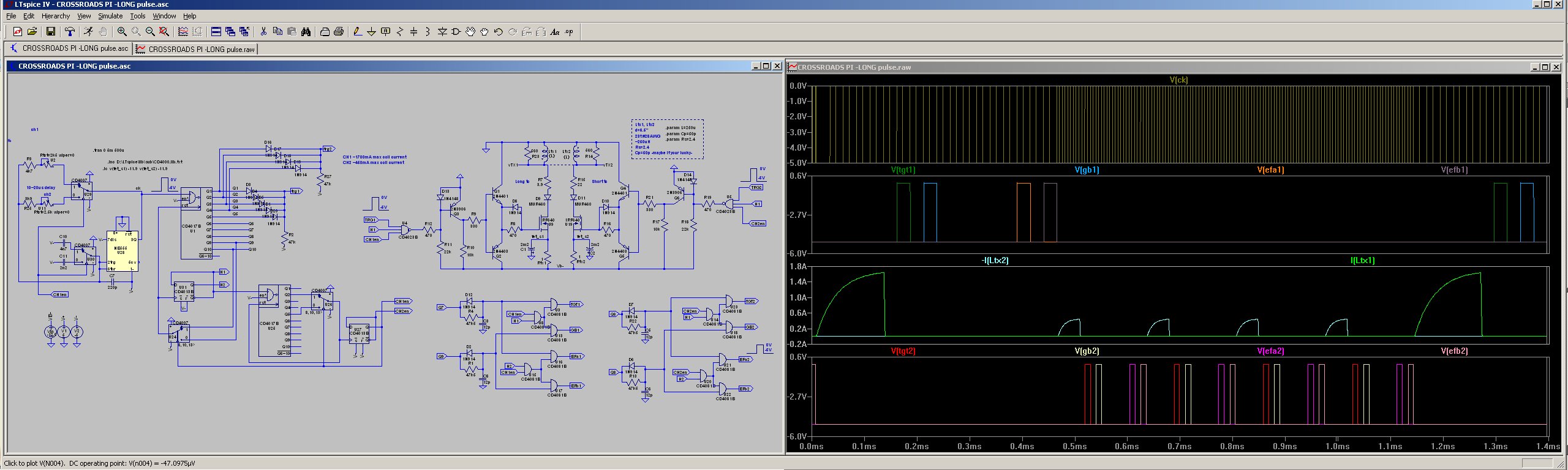

    I am attempting a design with two channels working at the same time. Channel 1 (CH1)
    counts to 18 then resets, and CH2 counts to 16 then resets. Using two different diode
    OR gates allows for having each channel to excite the transmitter for differing
    numbers of clocks.
    I have figured out a way to interleave the two channels so that either CH1 and CH2 can
    output between one and nine cycles (inclusive) before the other channel takes over.
    That means, you can interleave the transmit signals with 1:1, 5:3, 8:5, 3:5, 9:1 ratios
    (and etc., you get the picture). Or, use either channel alone. The interleave ratio in my
    simulation screen-shot picture is 1:4.
    What I am attempting to do is replicate the TDI ground cancelling scheme twice over,
    with each channel timed differently so that the detection holes in the two channels
    will not overlap.
    I do not have the math skills to analyze my circuit to determine where either
    detection hole will be, and that is why I am here.

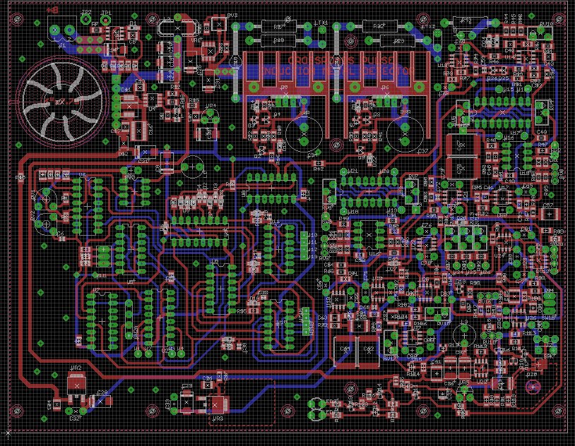

    we all need to broaden our horizons, right? I'm still trying to "proof" my circuit before committing
    it to PCB but most of the layout is done (just hoping I won't feel the need to do any extensive rework).

                Isn't there a basic flaw in this idea, or have I missed something?
                With the TDI ground balancing scheme there will always be a unavoidable "hole" in the target response. This "hole" must be there because this is where the ground signal appears. Unfortunately though, any desired target that happens to have the same TC as the ground matrix will also be eliminated.
                Now, if you create two separate channels with their own ground samples, this will simply create two "holes" in the target response. I agree that any desired target which falls into the hole of channel 1 (for example) will be allowed through in channel 2 ... BUT, so will the ground signal that is supposedly rejected in channel 1. So how can you distinguish between the two, since the the ground response and any target with the same TC are inextricably linked?
                Dang Qiaozhi, you have busted my bubble.
                Have you missed something? Probably not, but maybe I did. What I failed to mention is that I would welcome critique of my overall method... so lay it on me. My understanding of the TDI GB concept is obviously a little shakey.
                So what you're saying is that when the TDI's GB method is applied, no matter how the sample timing is implemented, ground tc determines which target(s) may go undetected and thank you for pointing out that basic flaw in my scheme. I won't expect a miracle.
                I had read in some other threads where (as I recall) it was suggested that there could be some way to insure "complete" coverage (my words) by parallel processing two channels operating with slightly different sample timings. That's what got me thinking I needed to go to the trouble to kludge two extra sample pulses between each transmitted pulse. I already had the basic complex waveform scheme worked out on paper, but without the ef samples.
                Well, all is not lost. There should still be an advantage by having two different coil tc's and two discrete primary sample delays operating in a parallel pipeline.
                It appears that for "complete" coverage I will need to drop the TDI scheme and have the two channels transmitting with alternating polarity.

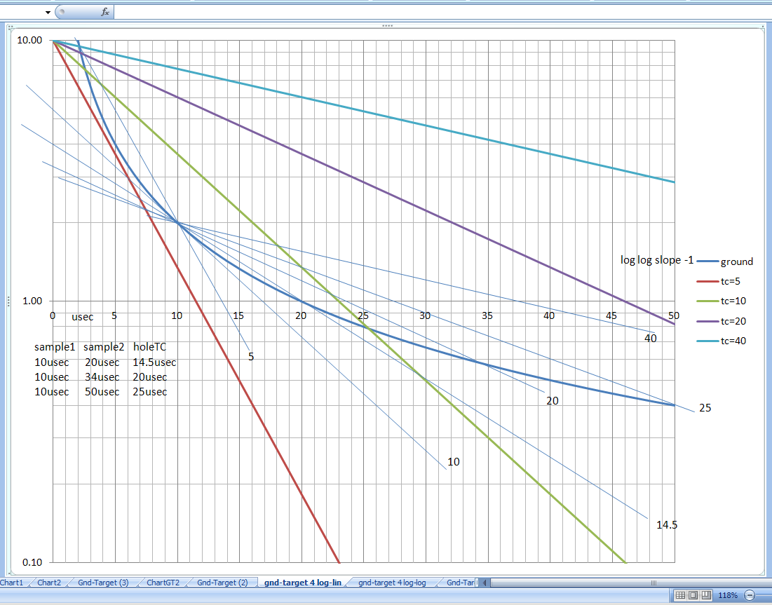

                        Don't know if this makes sense or not. The chart has 4 TC curves and a ground curve with a 1/t slope of -1. To reject ground, sample the ground curve twice. A straight line between the two points defines the target TC hole. The first sample for the lines I added is 10usec but could be anywhere as long as the two samples fall on the ground curve. To have a TC hole at 10usec the first sample would have to be sooner than 10usec. If the two samples were 2usec and 10usec the TC hole would be 5usec
                        Green, you lost me, too many blue and bluish lines (I get drawn in by what looks like an optical illusion).
                        I'll keep trying to figure out your meaning.
                        Incidentally, I do not really know how to determine if a target response falls on or off a line using analog means, (but let me say just for completeness, I don't know how to do it digitally, either). Maybe I'd better ponder that notion.

                          I just trying to learn PI detectors. Don't know how the TDI works, so maybe I'm thinking some different. Gave an example in reply #7 how I think it might work with two different sampling channels. Probably doesn't if no one does it. Each channel eliminates ground, but not all of the target signal eliminated on the other channel.
                          I apologize for the graph not being clear. I'll try to come with a better way to explain it.
