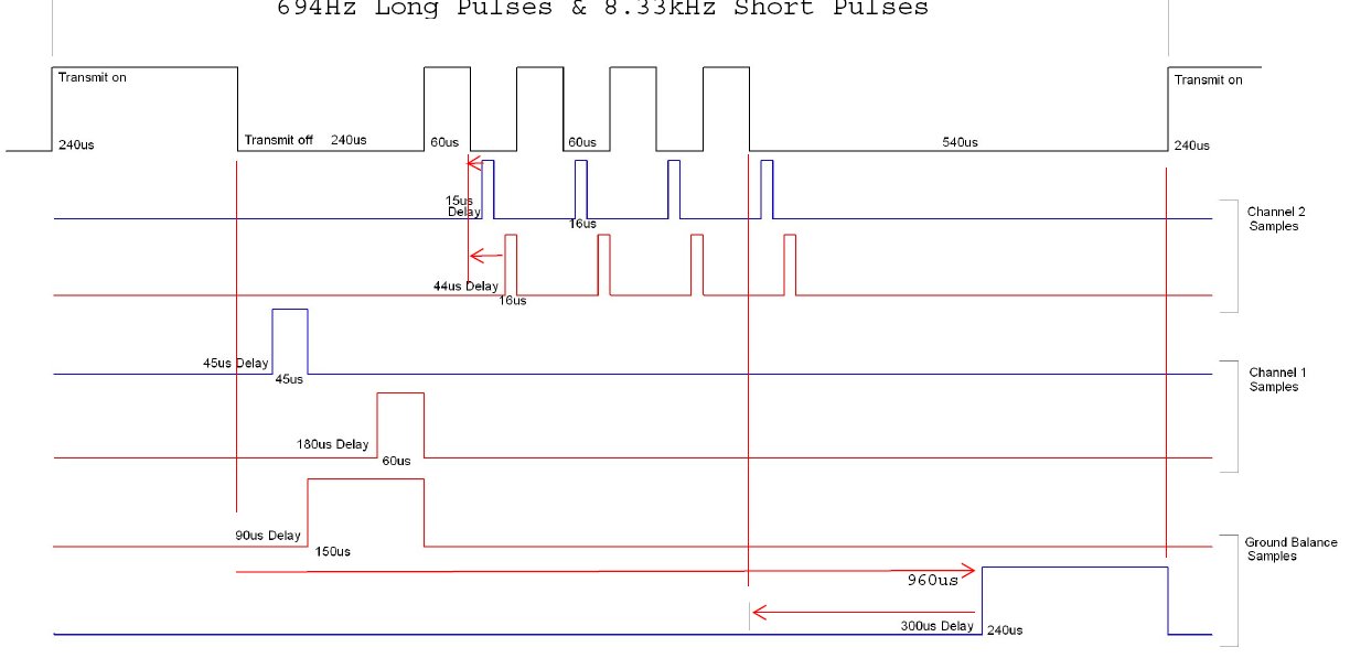

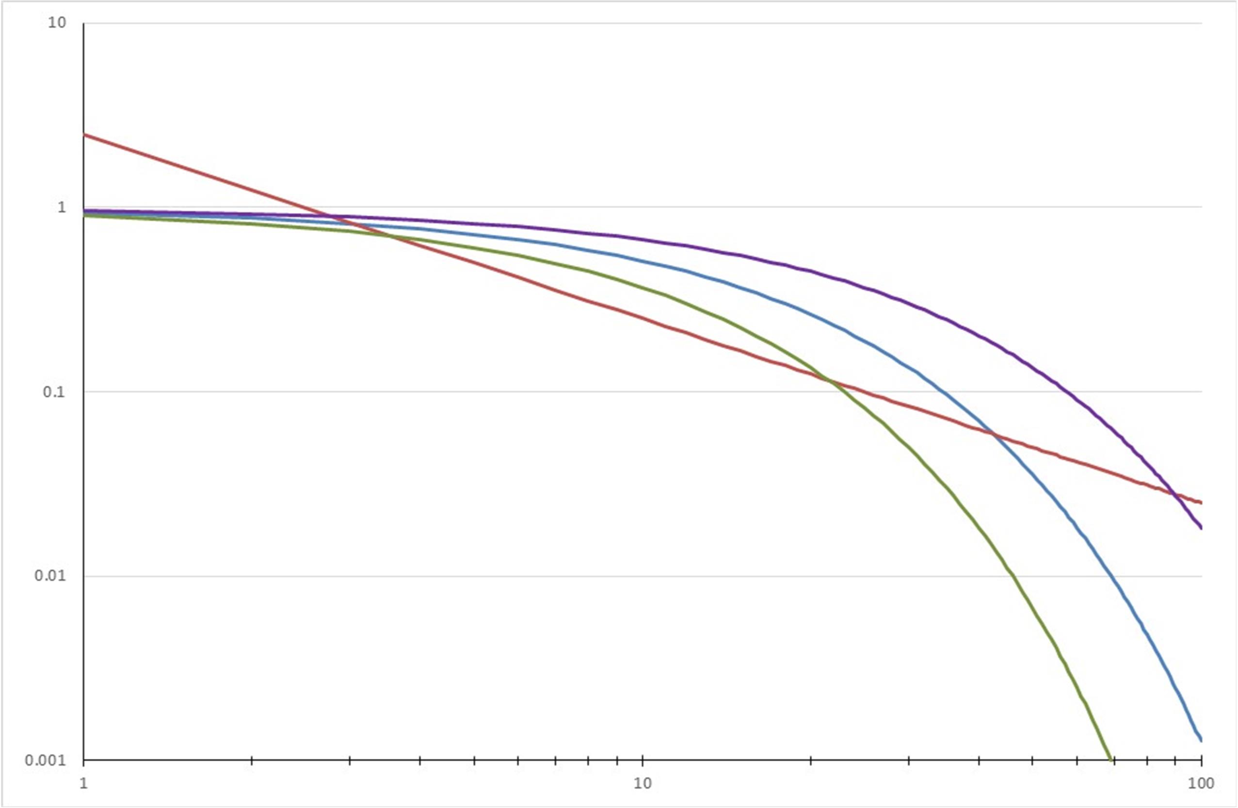

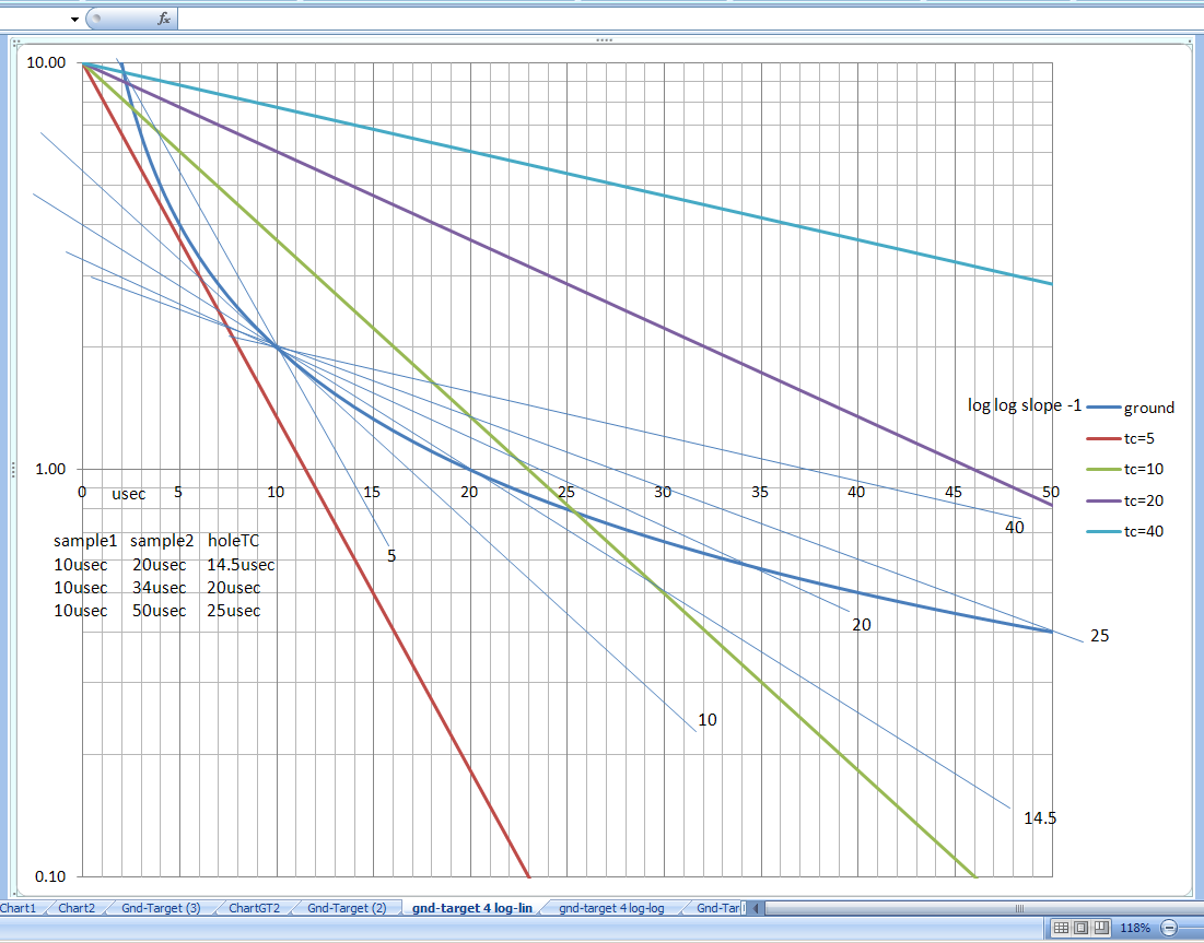

There may a clue here, but I'm failing to see it. If GB1 is the usual GB sample, and GB2 is a [later] sample, (presumably the main, GB1 and GB2 are fairly close together), then either GB1 or GB2 will be able to cancel the ground signal. But surely any target that looks like ground will also be rejected, regardless of whether GB1 or GB2 is used.
The answer must be in Minelab's MPS (Multi Period Sensing) method:
MPS (Multi Period Sensing) is Minelab’s advanced Pulse Induction (PI) technology that transmits pulses of different time periods. MPS also samples the receive signal at multiple time periods allowing target signals and ground signals to be separated. This effectively removes the ground signal from even the most highly mineralised ground while still being sensitive to both small and deep gold. This achieves superior depth in extremely mineralised ground.
Multi period sensing is Minelab’s patented pulse induction technology. Standard pulse induction metal detectors are limited because they use a single pulse width. MPS uses varying pulse widths that extract more information from targets, achieve better ground balance and detect to greater depths.
The main claim for MPS appears to be better ground balance.
But, unless anyone can say otherwise, I suspect the "hole" still exists with MPS.
